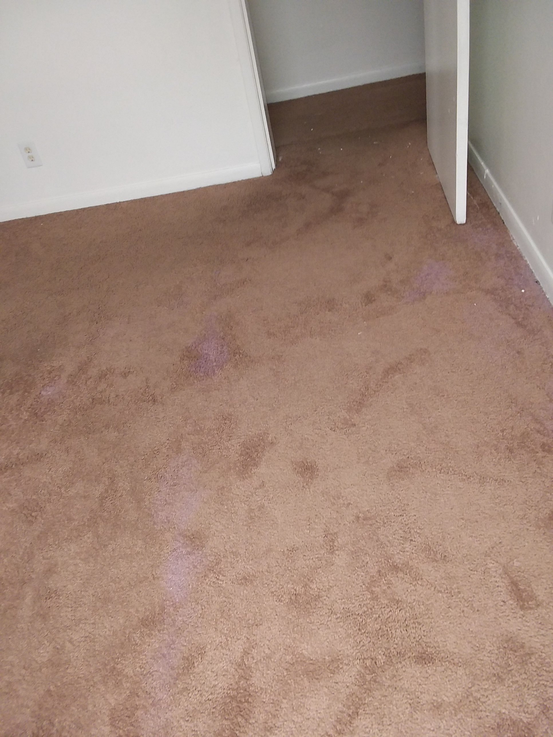

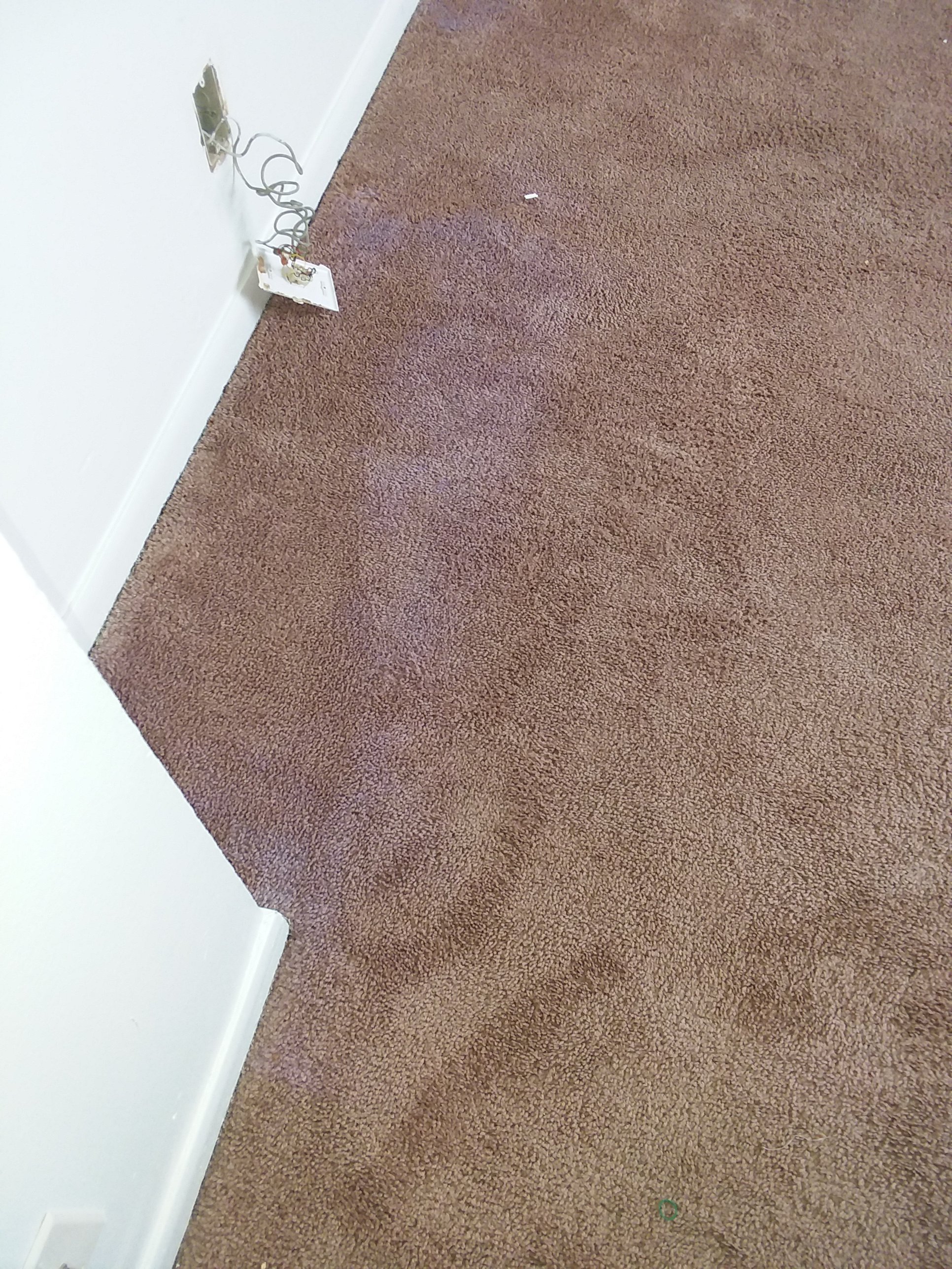

As for the issues on polys, I do see them often . But nothing I have tried has been worth the trouble. crayons, CTI cosmetics, Rit disperse/union dye etc.
Mostly just experimenting on site for my own satisfaction. or shold I say aggravation. !!!
View attachment 100293 View attachment 100294
No,, obviously a vacant rental. And no noticeable odor. And no foaming when cleaned. I see this all the time.Nice pics. Do you know what chemical caused the damage? That looks exactly like the polyester color damages I've seen too.
Depending on how extensive the DRIPS are, and since it is a rental, I often just use a black, or other color sharpie, to darken then slightly. Then your eye is not drawn to them .We used to have Rainbow International, Langenwalter and a couple of others. I think they are all gone now. Color repair is a great skill to have. I just had a customer with nice 3 year old carpets need some work because his tenants had dripped bleach while disinfecting door knobs. I don't do it myself, I just don't have the eye for it or the patience but we have a local who does and this job will likely be at least $1000 for a couple of hours work.

Polyester. It always goes purple with bleach. Nothing you do will make the dye strike properly. It might appear it has, but it won't or hasn't.Shoot, I do color correction, ... or should I say I used to.. LOL !!! I do not even carry my dye kit any more!!
