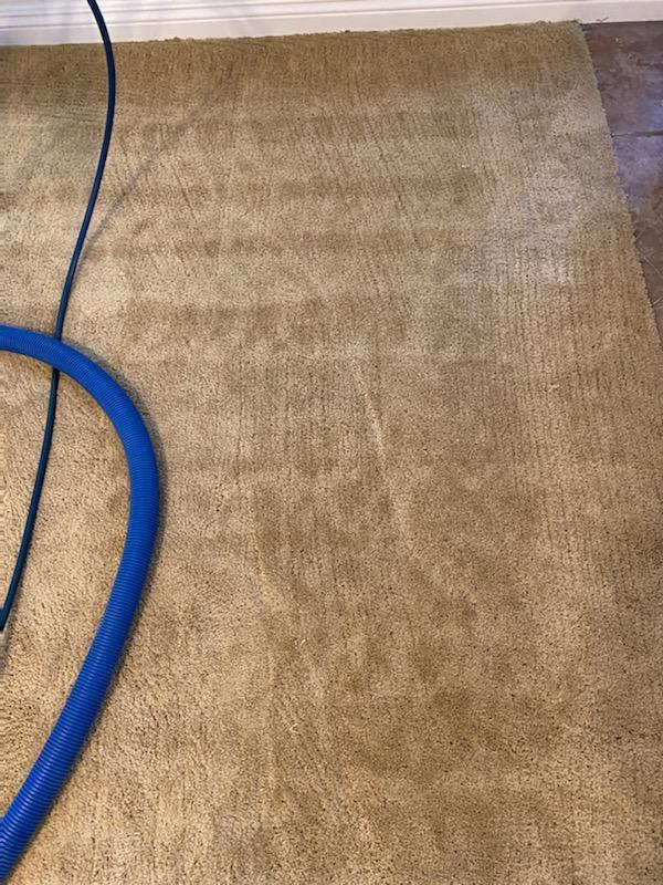

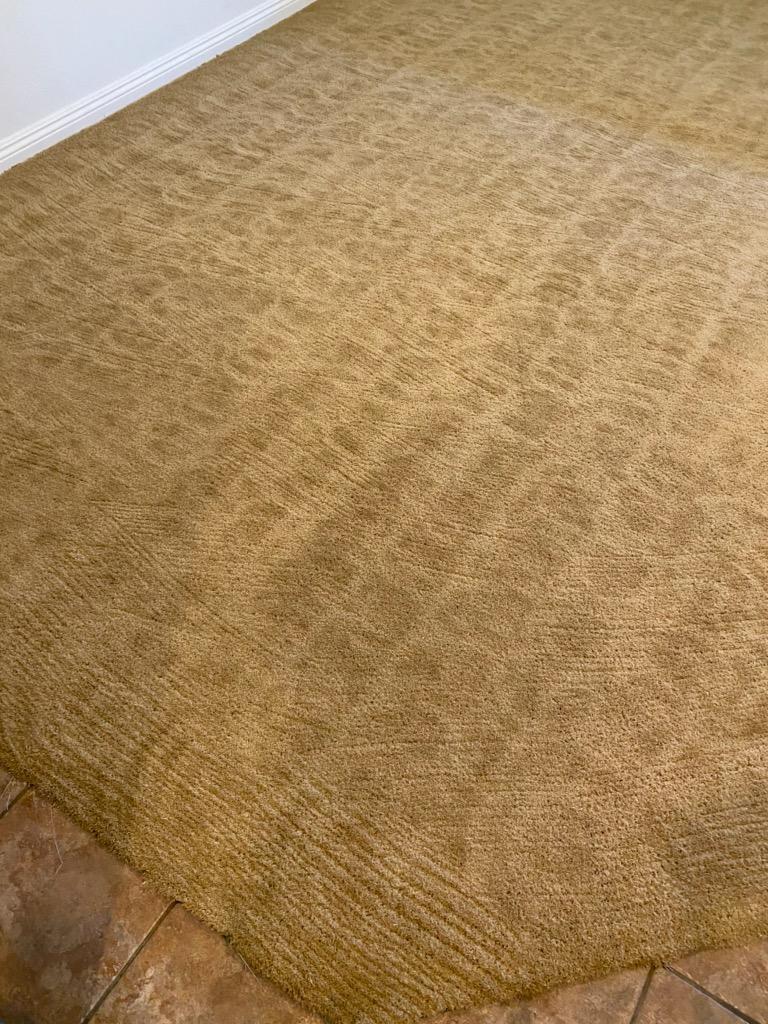

Speaking of this the member here sent me these two photos of some damage he created with his rotovac three port non-brush head with a moderately distorted brass jet..
The odds of him being able to fix this sir pretty slim...View attachment 102487View attachment 102488
Well, I have some patterned carpets with the resemblance of that in the show room. Looks like they got an updated look for a carpet cleaning price. ;) Ouch for the member that caused it, maybe a wand reclean, looks dirty and clean all at the same time, or do you think the jet "burned" the carpet?

A re clean with the proper tool should fix the problem. Any type of tool with bad jets and high pressure will do that. The color of the carpet shows the uneven plugged jets pattern on the carpet. The vacum only removed the cleaned area of the carpet but not where the jets were blocked or uneven. jz

Doesn't Matter
