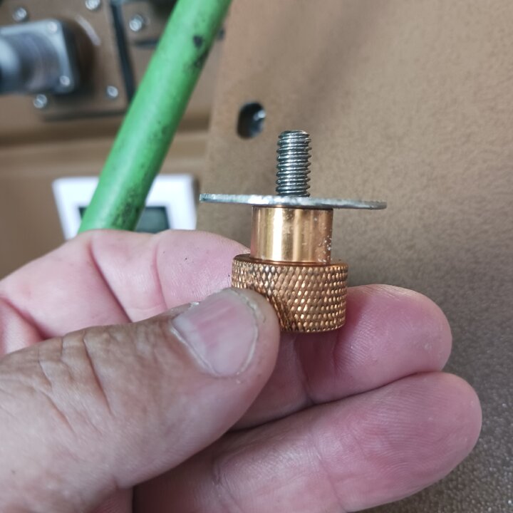

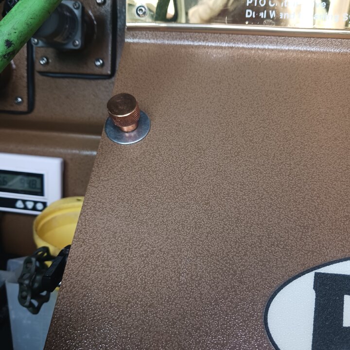

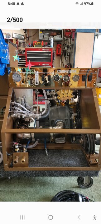

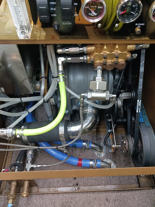

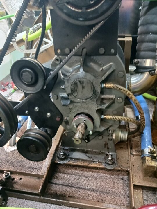

Design, for instance drive shaft, straight with inner and outer only 2 bearings easily rebuild no ujoints. Belts are adjusted with camed idler pulleys 2 cresent wrenches 1 bolt from start to finish less than 5 minutes ( including removing and installing covers)Wastetank/ solid stainless steel. Standard steamgeni uses starvation for chemical feed,no chemical pump and related parts (lines,valves,check valve etc.) Instead of a throttle controller steamgeni uses a somple solenoid( but only has high&idle). Acess front and top covers remove for complete access to all components. Its not that things don't wear out and need repairs. Its that everything is open and easily accessible. All machine components control panel, everything is in 1- 3'×3' box behind the drivers seat also when things need repaired or replaced, you can do it without standing on your head the difference between working on a steamgeni and working on yours is like the difference between changing spark plugs on a car built in the 70s vs. finding and changing plugs on one built today plus the added longevity of stainless construction. In short they are built to be repaired not replaced. Keep in mind when showing pictures of frankinstien ive added chemical pump, salsa heat, dual chemical tank valve dual wastepump float switches,throttle controller/ remote start/stop on machine and on the pressure pump. Blower Tachometer etc etc In short theres a lot more shit in the 3×3 box than a stock steamgeni, and still you can see and acess all components easily. I have a near stock one as a spare. Maybe this weekend if i have time ill pull the covers off and take some pics and put um side by side woth frankinstien. To show how much more simpler the stock ones are
View attachment 132436 View attachment 132438 View attachment 132439 View attachment 132440
That's cool Dwain-o. I really like the adjustable belts with the idler pulleys, and the simple driveshaft construction. I will challenge you on something though, I think this CDS 4.8 is even more accessible than your sexy Steam Genie. If we consider removing your panels on par (or close enough) with removing my driver and passenger seats, then it seems to me my layout is way more open and accessible as it is spread out across the space between the driver and passenger seats as well as about 20" or so behind each of those seats, like wide open, rather than stuffed in a box. I'll remove the seats and share some pics tomorrow.

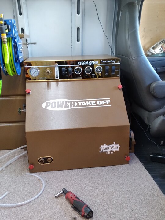

Not even close.top panel slides off (no screws and front of machine has giant thumb screws. I can open up my machine probably quicker than you can remove the fiberglass top between the seats. I can also if needed remove the drivers seat and pull the side cover there too if necessary. Ive only done that to replace blower front seal ( instead of removing the blower to do it)

View attachment 132441 View attachment 132442 View attachment 132443
Nice! Clean ! Fingernails

I admit it takes me SLIGHTLY longer to open it all up. Although I have a ratcheting 18mm wrench and 2 bolts holding down each seat, and 95% of the time I only need to remove the passenger seat. I've gotten pretty quick at removing the plastic dog house covering the power pack, 15 seconds, with both the seats still in place.
My challenge however was, once the passenger seat and dog house is all removed, my setup is more open than yours Dwain-o. I'd guess for a machine that is still in production, my CDS 4.8 might be the most easily serviceable one on the market.

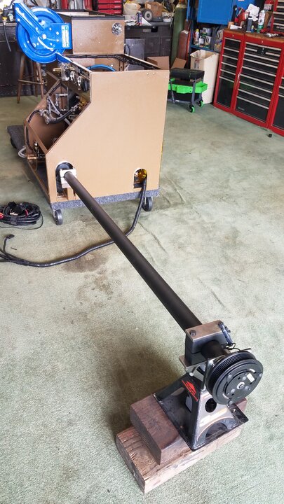

For me the driveshaft and aluminum tank was what sold me against the hydramaster unit butler, sapphire scientific and cleanco all used the same straight driveshaft in their ptos but it is a 3 bearing shaft that is not as easily rebuildable as the steamgeni 2 bearing shaft is. If i went on looks alone the sapphire scientific won it was pretty, but it was also too new to market. I think they discontinued it after only a couple of years. Butler had alot of strange things for instance how components were piled in and ontop of each other and inorder to prime the chemical pump was a big process compared to all other machines (slide-in and pto's) cleanco was another machine that i considered ( and used alot of technologies from in frankinstien) but in the end it had an aluminum wastetank and the over all look of the machine was really really dated. It screams late 60s early 70s compared to the sapphire scientific and hydramaster. However i did end up using cleanco's new version 2 tank water to water heat exchanger, modified engine and rear driveshaft mount and coolant taps. And extensive use of cleanco's 166 page pdf installation manual as reference for instance to professionally cut the dog house engine cover for the pto driveshaft . But when the show was over i went back to the good ole tried n true steamgenis.
