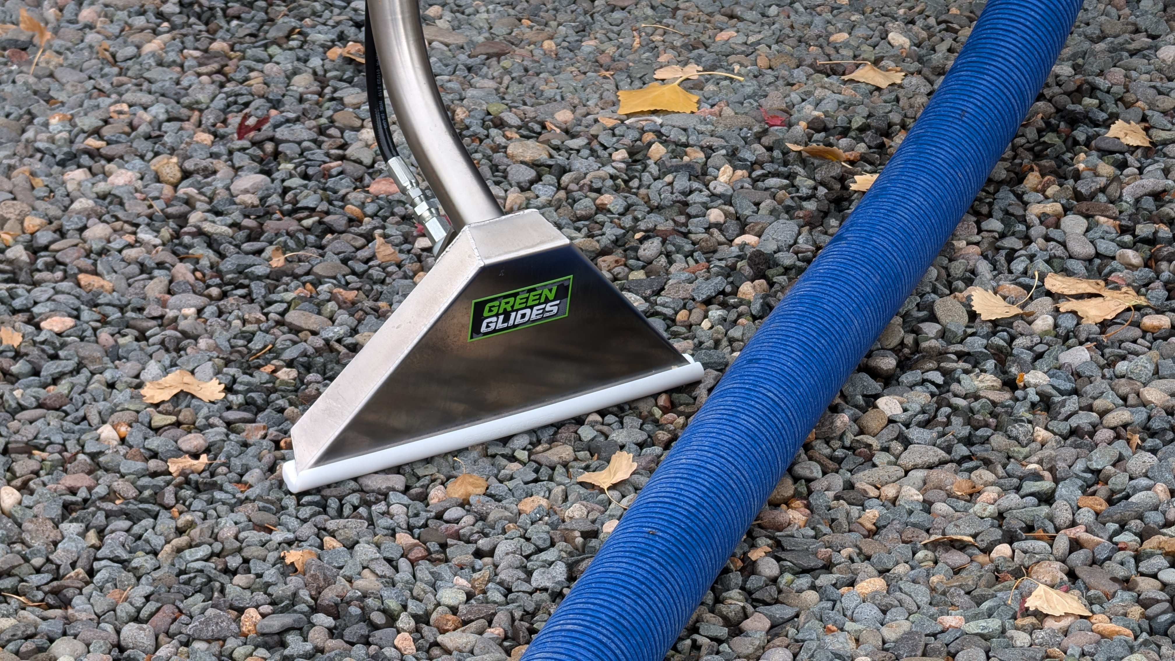

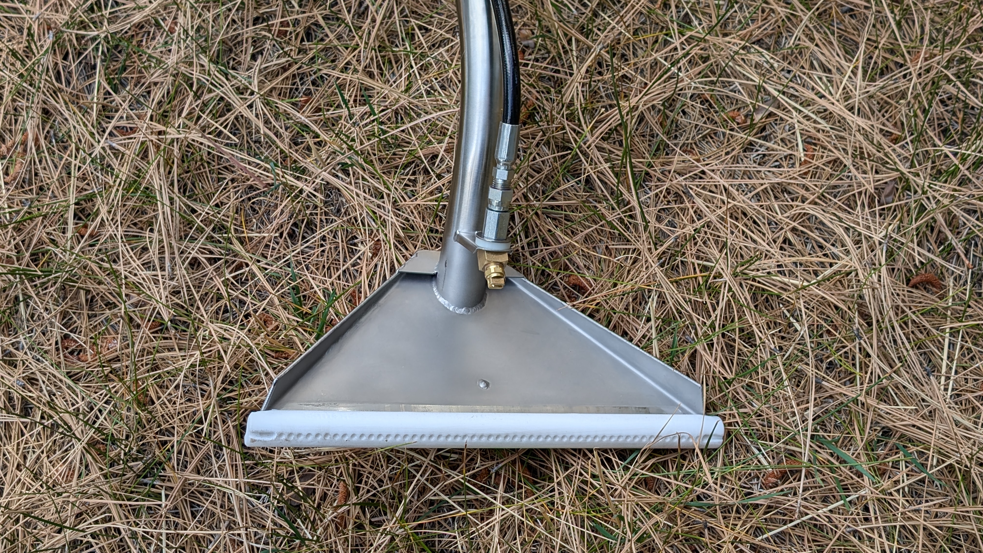

Yes, "my" model will have a SS nozzle, thats be relocated to strike right behind the Glide, removal of the center pin and an inline filter, and of course your choice of GG, with a package deal on a Hole and a Slot.
Priced at $775, delivered to anywhere in the L48
$900 with two Glides.

As I'm selling wands everyday, sometimes it just leaves me scratching my head at how clueless 95% of the industry is about how flow and jetting works. Most are convinced that more jets means more water and there's nothing I can do to explain it to you people that more jets are just dividing the same amount of water... It leaves me wondering what you people actually think about while you're in the act of cleaning...
Imagine if all the carpet cleaners worldwide got rid of their wands ( multi- jet ) and purchased a miracle single wand. You'd become a billionaire.

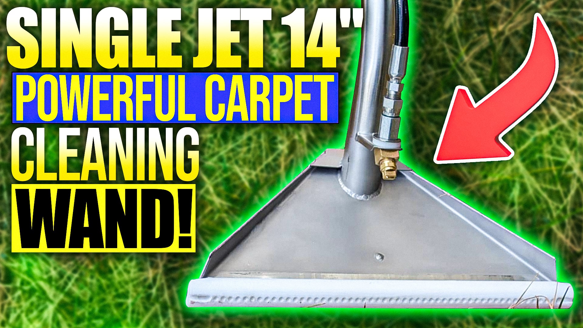

Luky
Jan 19, 2023
327
Chicagoland
Mario
No streaking/clashing
No over spray
No drips
Hole or Slot Glides @ instant swapping
Lightweight
Equally as effective as a multi jet, but with less water ( 4 flow)
You know, everything your PCTI isn't or doesnt

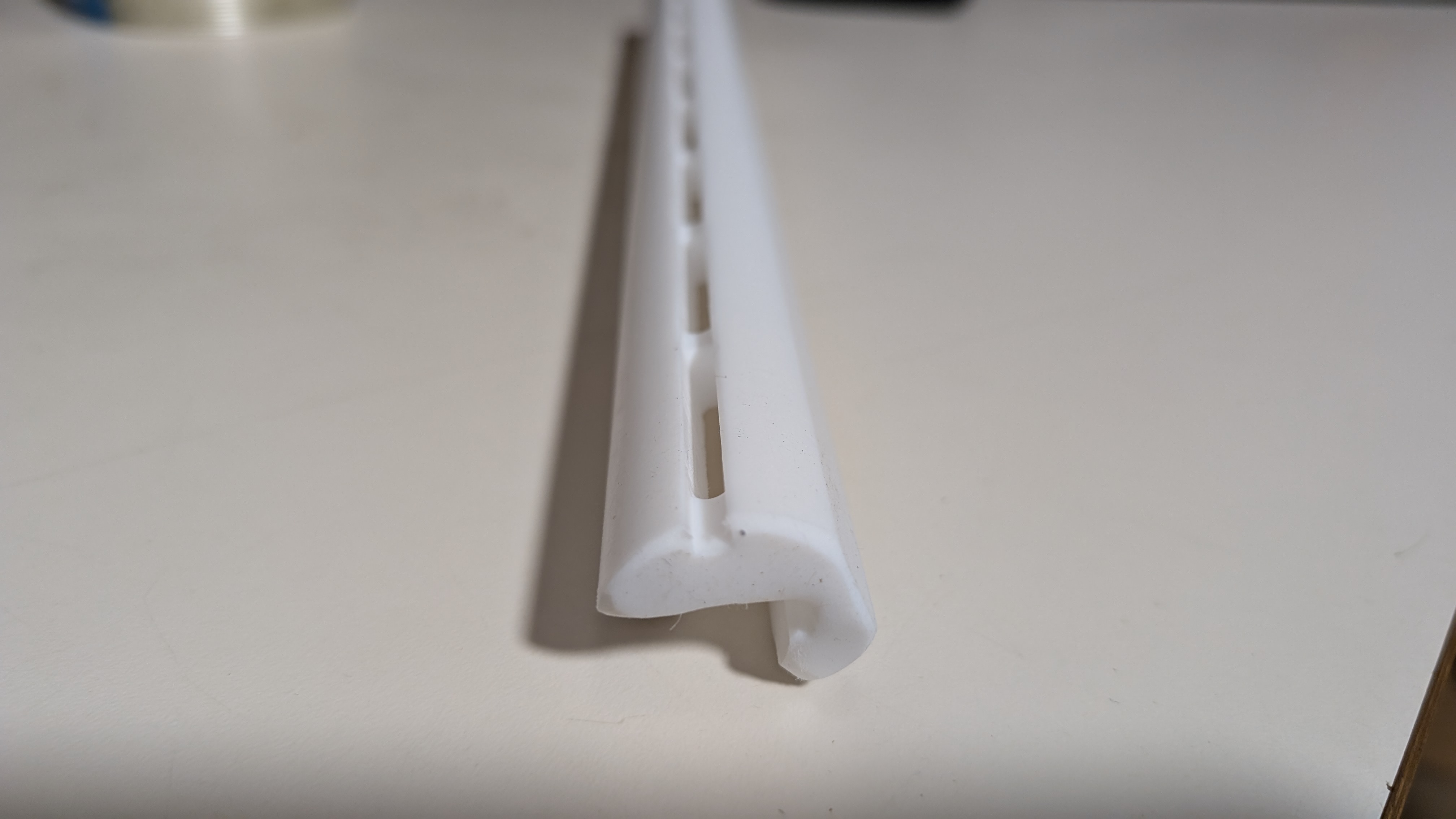

I'm glad that you mentioned streaking. I have only six jets on my wand, but somehow I see leaving eight streaking lines. I believe that's the number of the openings in the slotted Green Glide. With a proper positioning of the jets, there's no ovespray.
I'm giving you only one point- dripping. Weight shouldn't be a problem with the glided wand( I don't lift the wand, I slide it) I wish that glide would last longer, but in all fairness, quick wearing may be caused by roughness of CGD carpeting and the weight of the wand.
I consider the wand as a powerhouse and investment. I had to replace only water supply lines on two PCTI wands in 15 years.
I have no problem with a single jet wand, I can't overcome the fact that is not a low profile one.
Reactions: MarkieMark
12,575
That would be ideal, but I don't believe there is a jet that could create that wide of a spray pattern to reach the width of a 14" wand when mounted more closely to the carpet.
Try a Delran glide, they last much longer.

True
This wand gets under beds, which is good enough for me.
It's a joy to use.
Most wands aren't.

Bridges can be re-recessed as the Glide wears down with a box knife, or Dremel if you don't want the lines.
In most cases a dry stroke makes it a non issue..

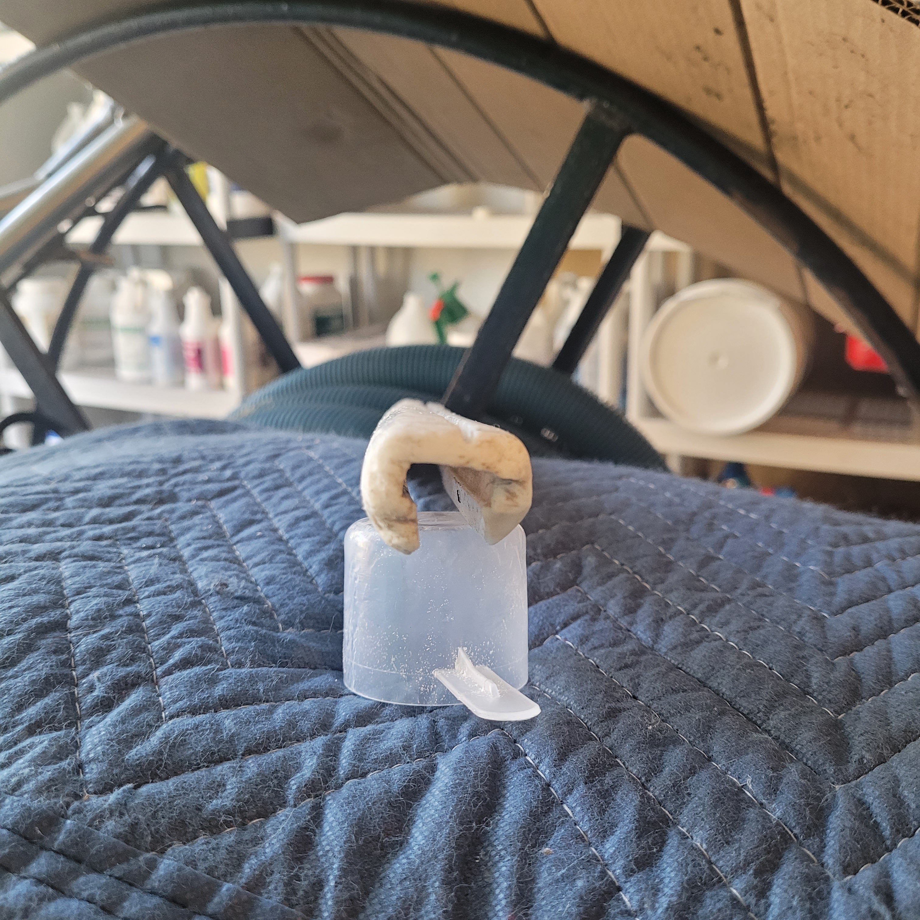

I don't have a new glide to compare to, but you get an idea; I beat hell out of it.
  • Wow
Reactions: Josh Wood

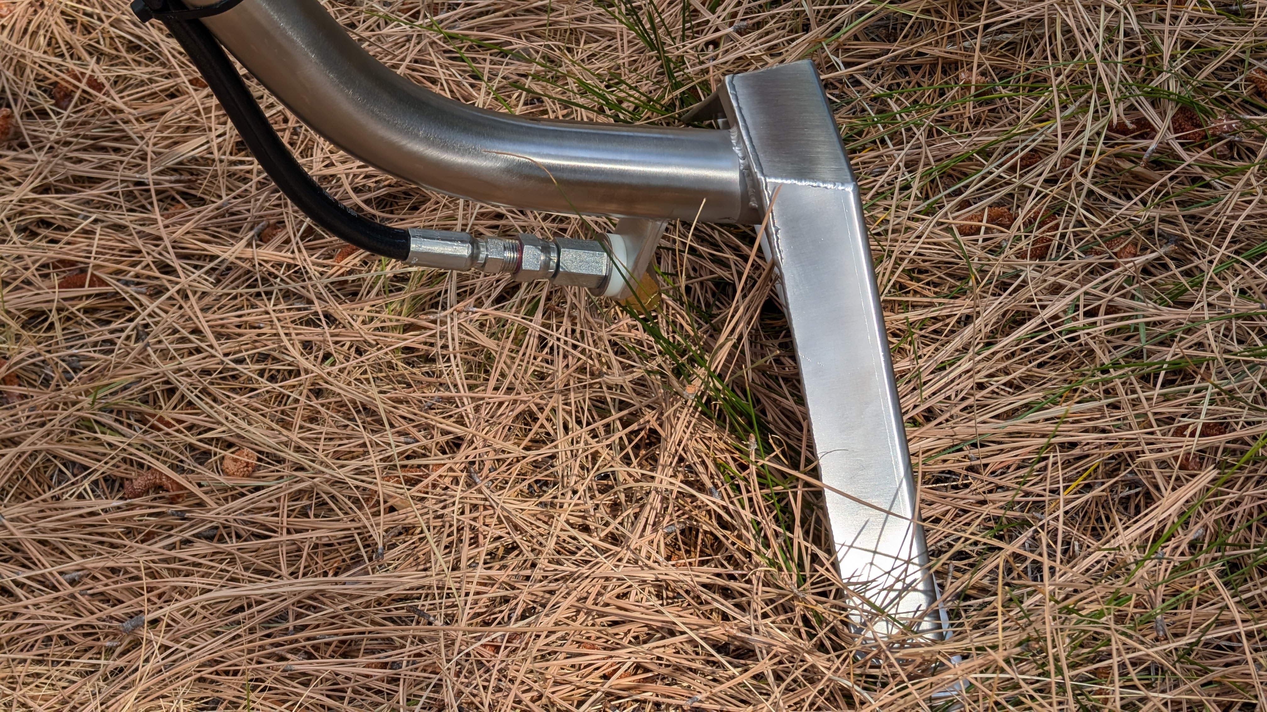

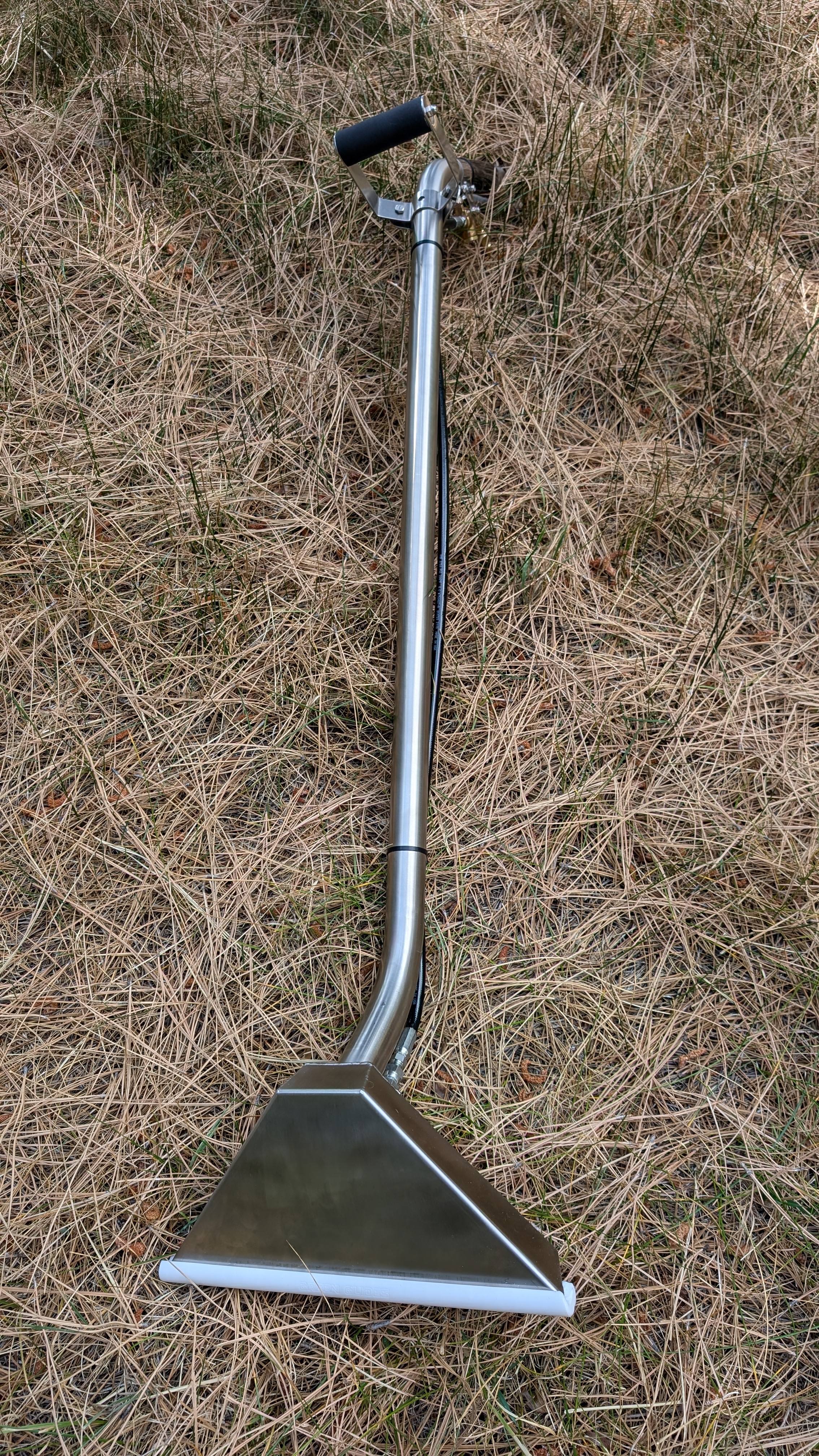

This is a fantastic wand.
  1. Affordable
  2. 14"/1.5"
  3. One unplugable, drip and streak free nozzle, with no over spray
  4. Internal-easy peasy swap out- fit Glides
  5. Excellent extraction and drying
  6. Very maneuverable and a joy to use!
Needs a few tweaks to make it nearly perfect.
Really it's only drawback is its head height but with the shoulderless, triangle-shaped head it gets under more things than you'd think and for larger areas in most cases the furniture is not going to be an issue, where you would want to use a 14 inch wand..
View attachment 128676View attachment 128677View attachment 128678
Nice photos takes the place of Playboy and Hustler when I was younger part of aging I guess

Is there any wand more simple than this?
Wands have "evolved" really stoopidly...
