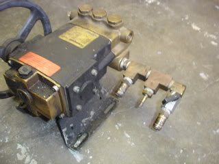

Basic pump mod for a simple syphon, then you just hook up a Dwyer meter and you are on your way FunkyMeister.
closest to the pump is the regulator/unloader bypass return, center is chem draw from Dwyer, farthest is fresh water feed that is beng starved 10%.
