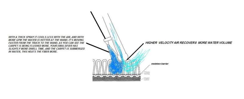

BTW, finished the job last night.
Used 1/2 the amount of Butler Detergent (Made me feel like a dirty hack)
Sprayed Cobb's PowerMax with battery sprayer, cleaned up great as usual... But just didn't SHINE like it does with the o2 system :|
Also an update on the upgrades I did to my system,
we ran 400ft hose, first 50ft was 2.5 and we set the machine @ 95% capacity, and it was near impossible to move the un-glided viet cong wand.
It was making that beautiful "RIPPING" sound I usually only hear at 100ft of hose. :twisted:
NOW to run 2.5 all the way to a 10ft 2" whip (only if I use my hole glide SS wand :) )
