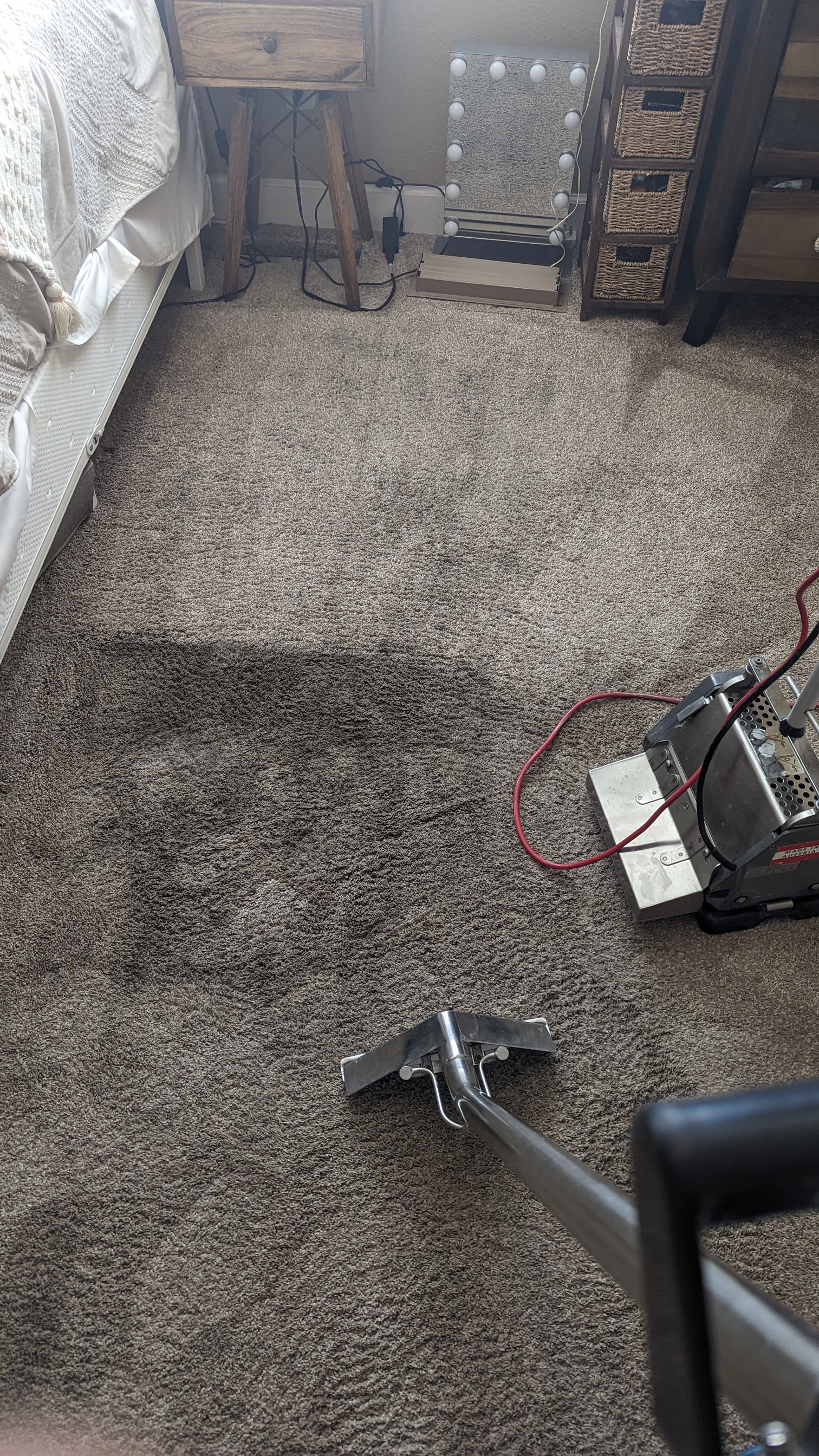

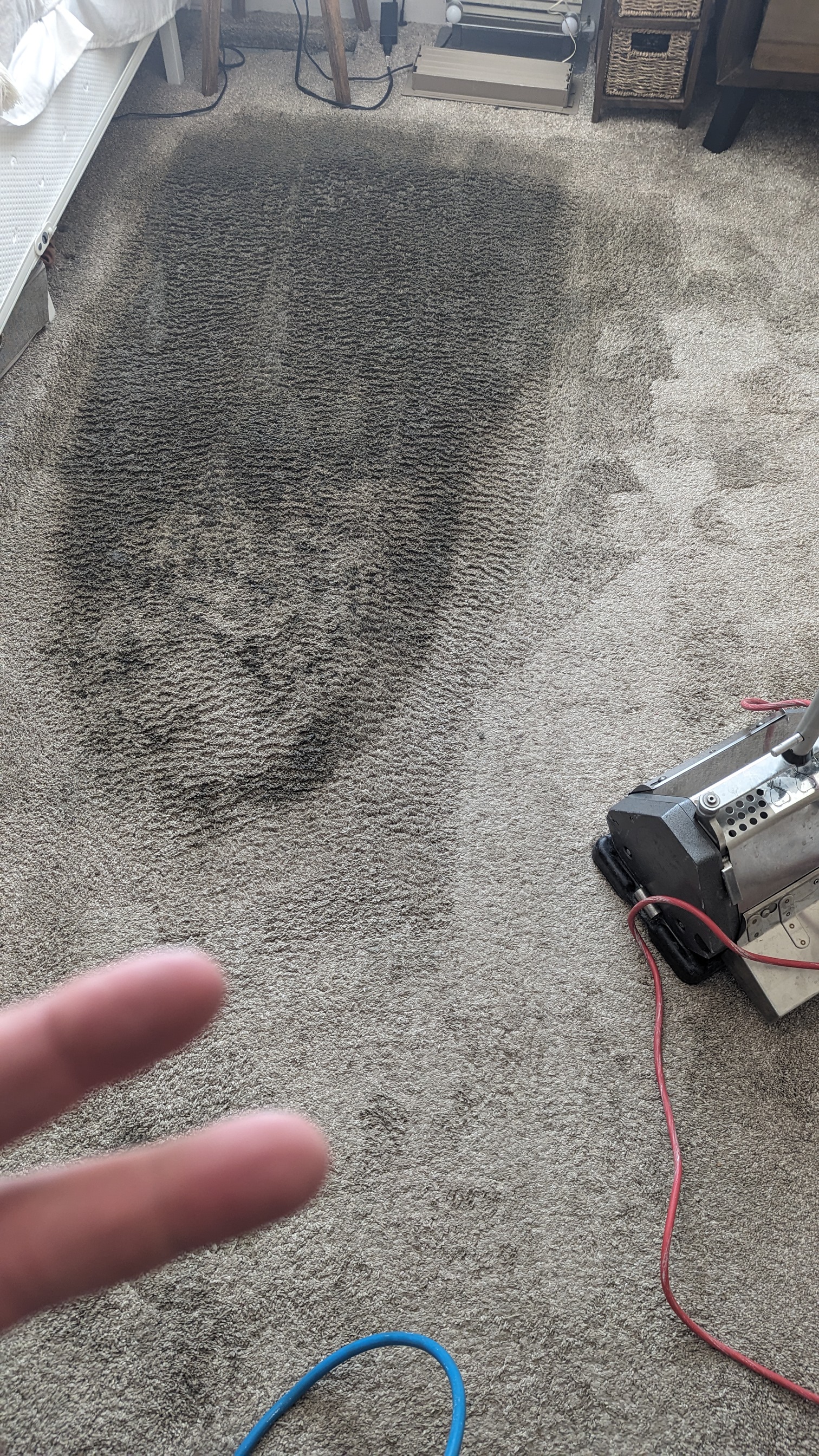

Daughter spills 6 ounces of contact saline solution on dirty carpet.
Blots it but smells musty the next day.
On goes 32 ounces of Natures Miracle.
No miracle.
Still stinks a month later so they go to the internet for helpful tips.
Apparently cat litter will absorb odors for carpet so they try packing it in.
No go.
Apparently hydrogen peroxide works to..
But does mix well with the CLUMPING cat litter.
One ruined Shark vacuum later I get this text from P...
Can you call Jacque about carpet in Shelly's room. They have an issue with a do it yourself spot clean up, involving clumping cat litter.

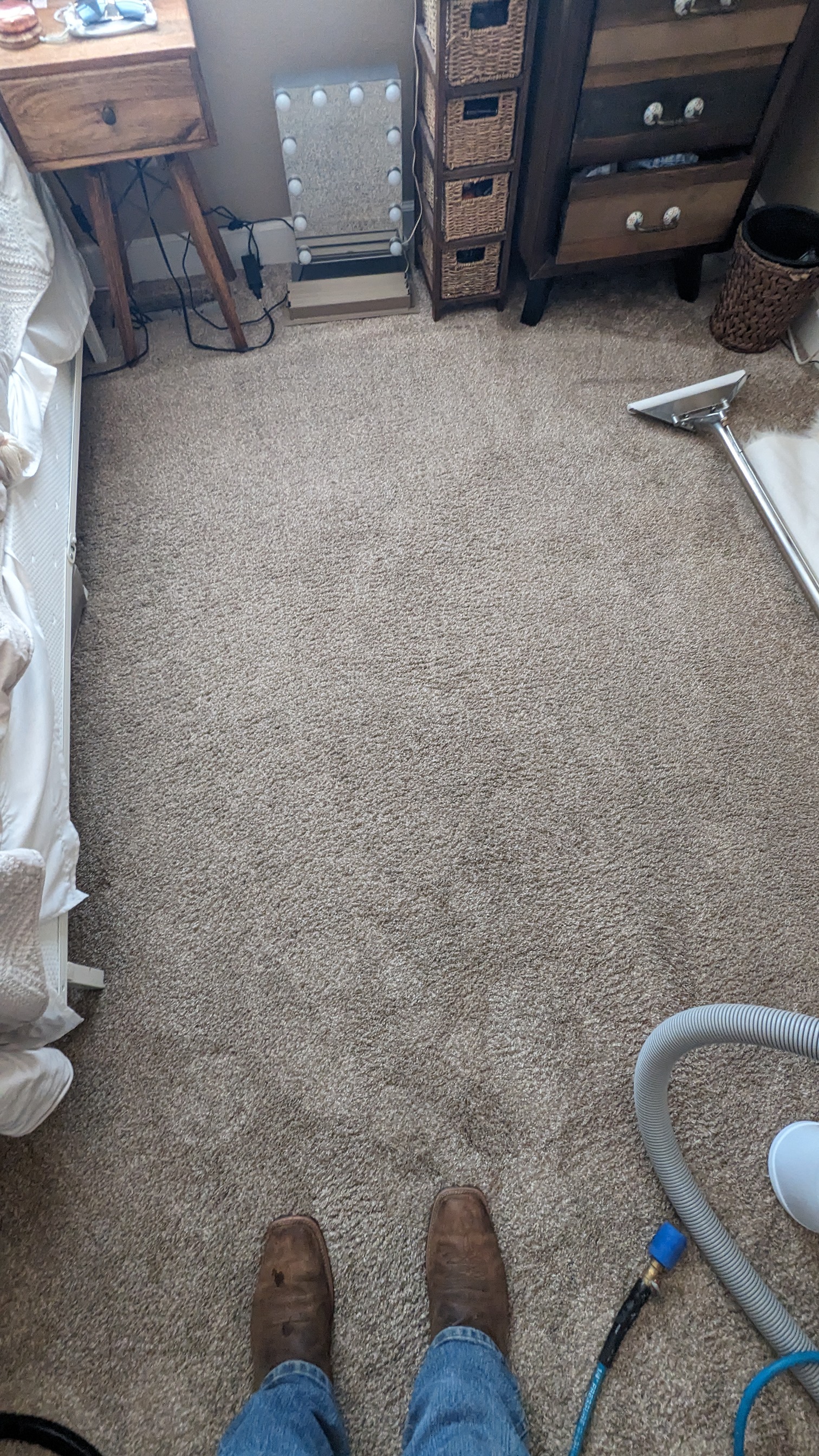

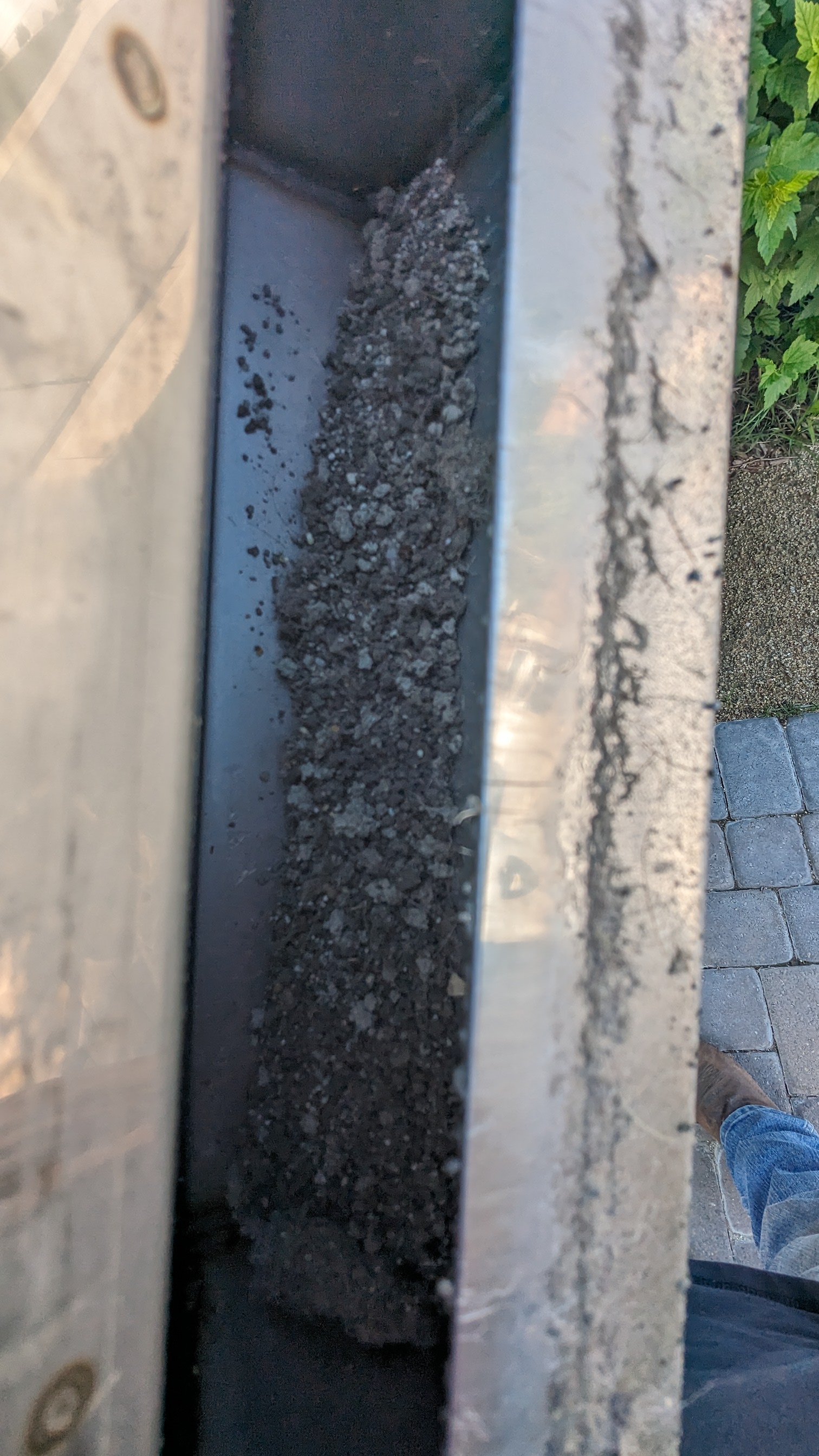

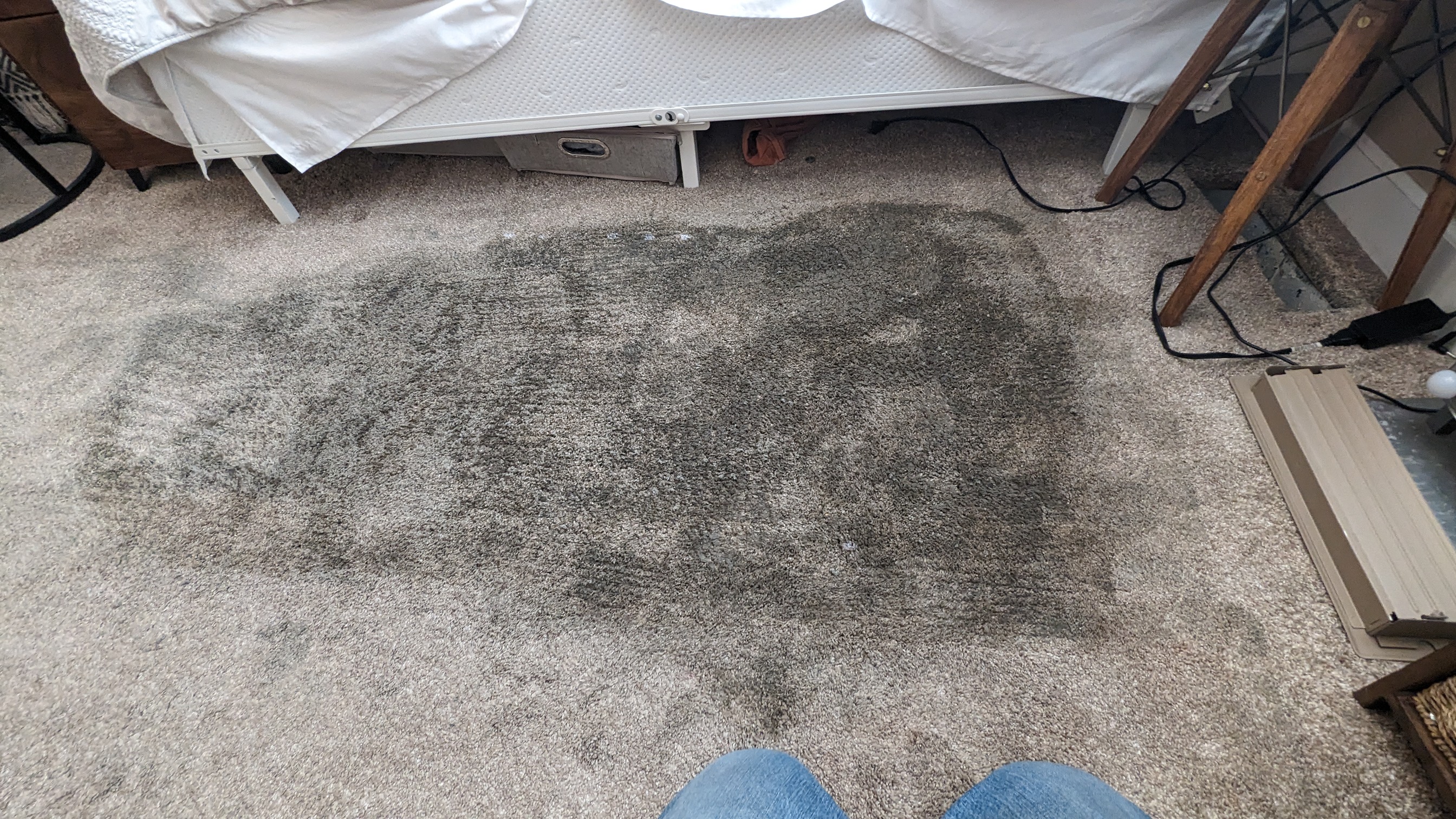

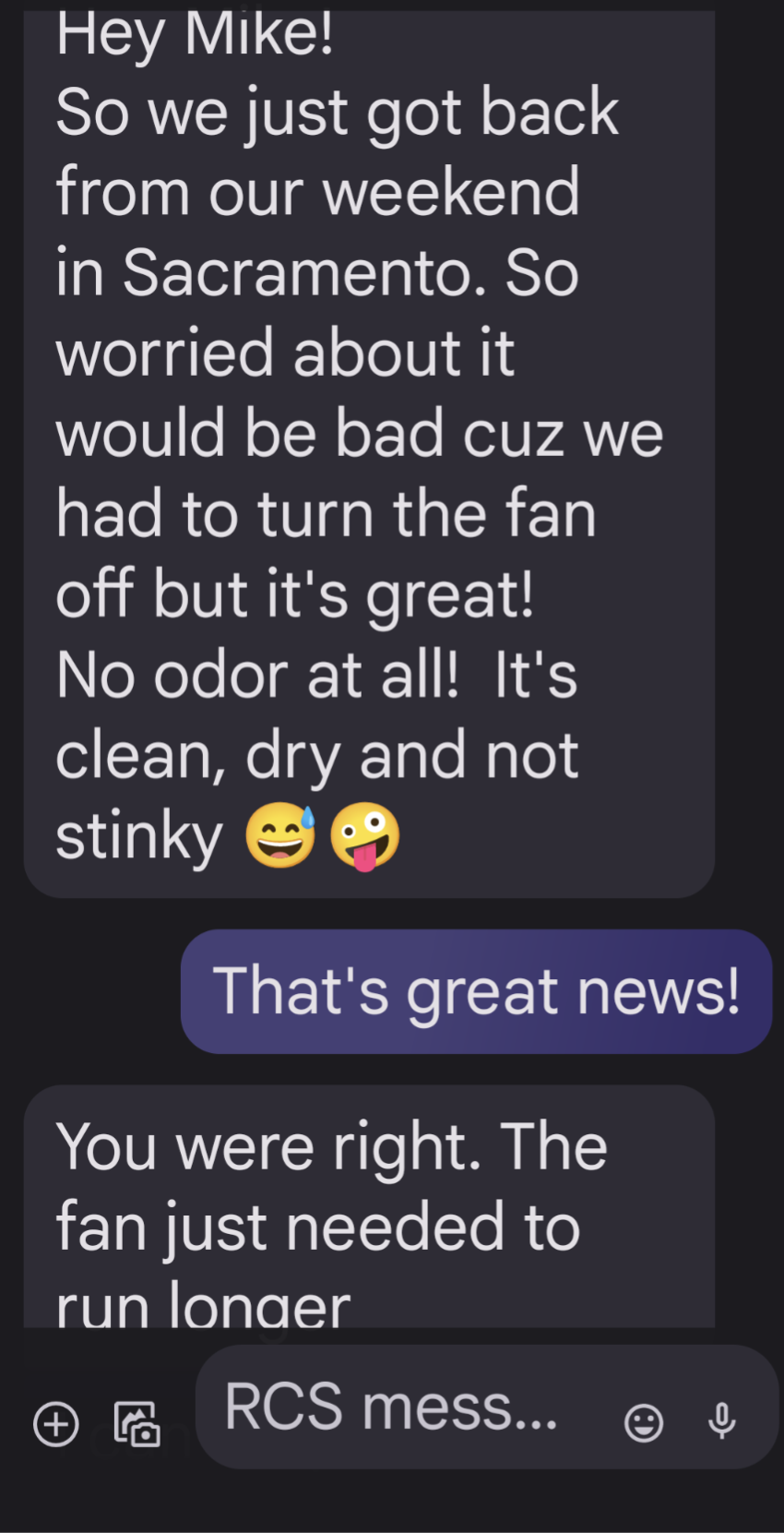

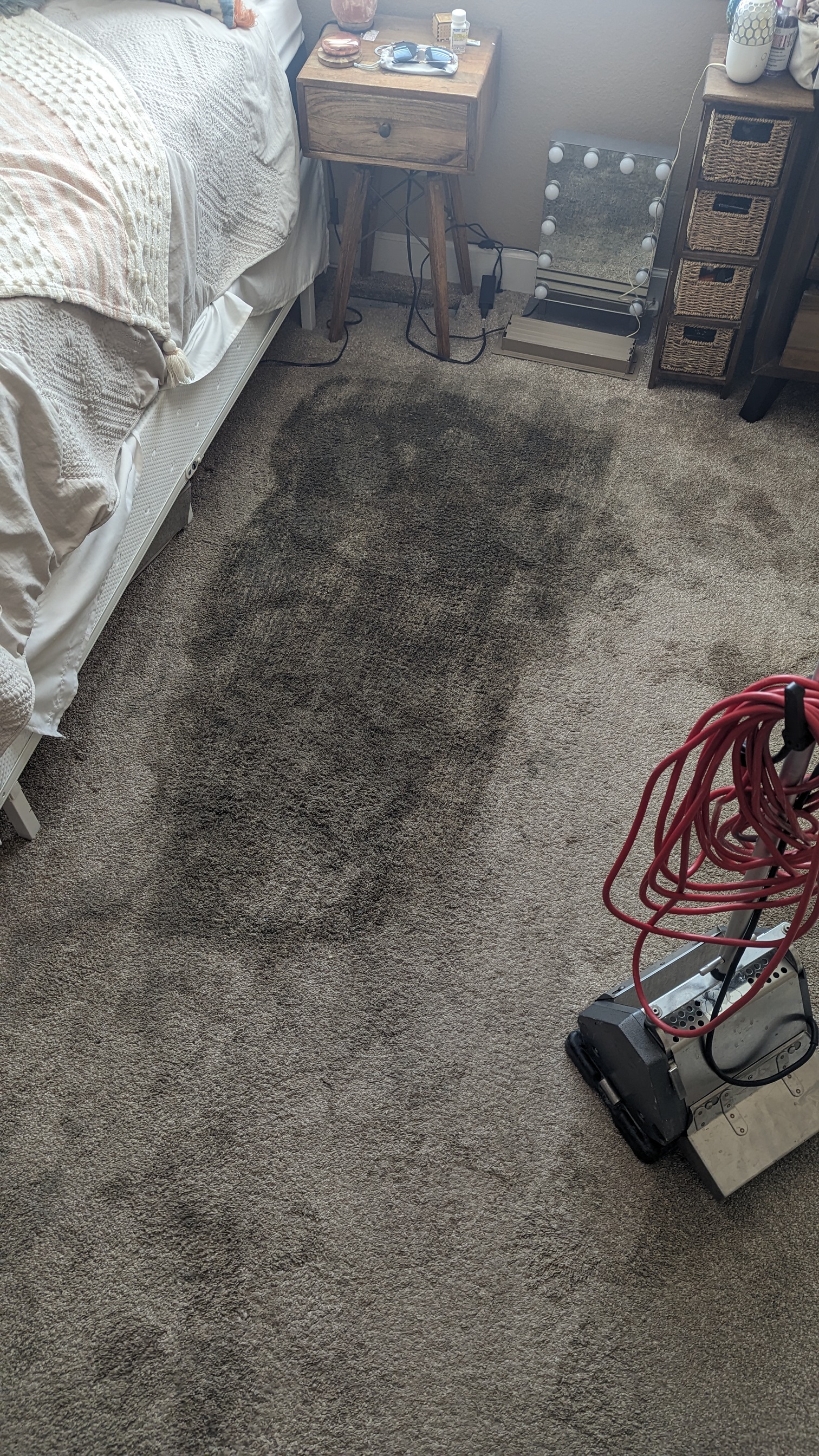

So I dropped by today to find this..
Crb
UPE
CRB
Rinse with AFR
UPE
Rinse again
Drench with SaigerCyde
Vac like the dickens
Leave an airpath.

Nice job. Since it's a friend of your wife, did you get paid?
11,551
Cat litter tree turns to clay practically such a pain.
Good job.

I think clumping litter is cement. I've never had luck getting it out of carpet after wetting.
Good job.
