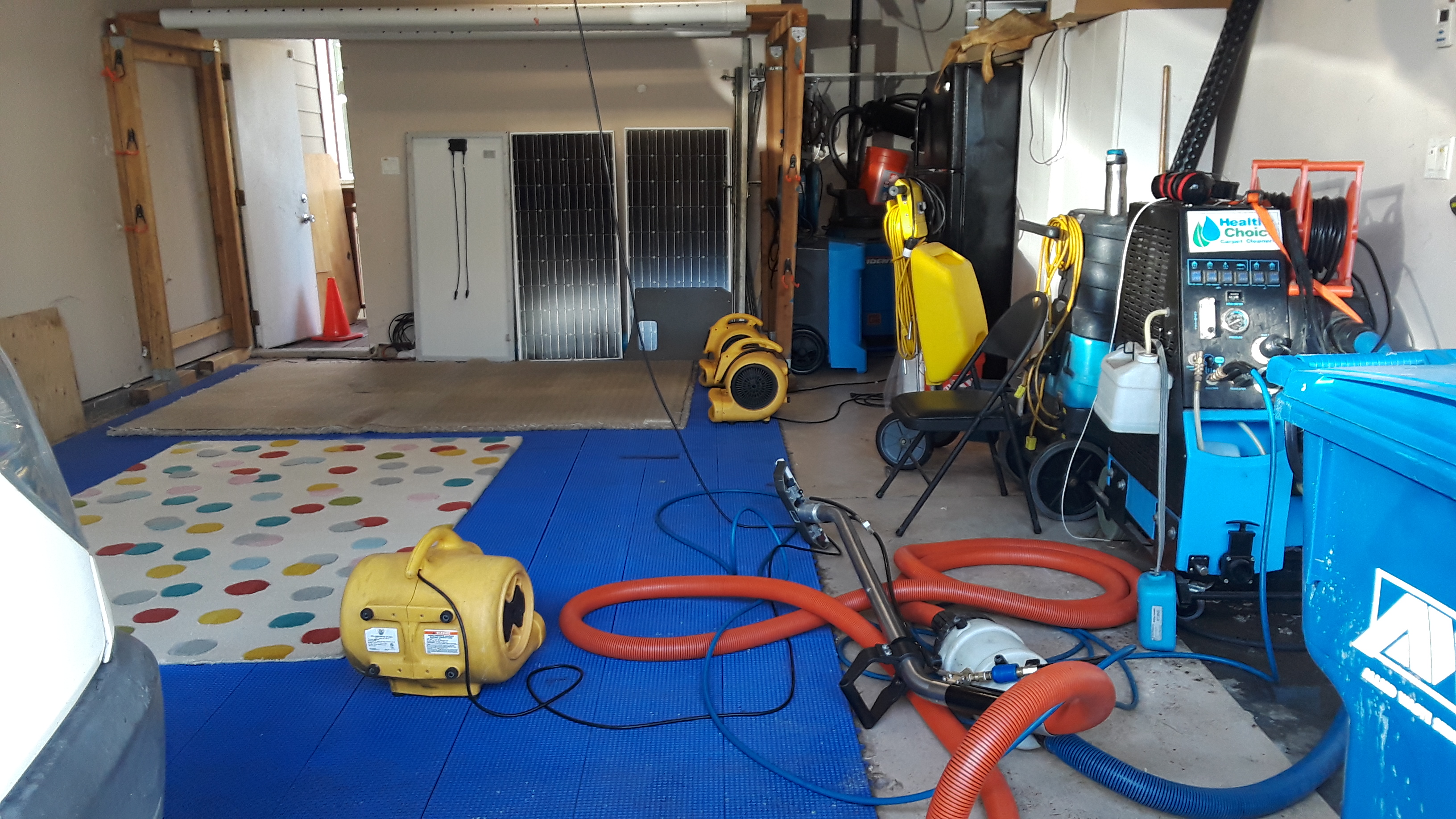

That looks to be about wheat we could do at this time
So what are you doing for sever soil and The Pee Pee?
Lots of COLD water, a Cimex, An 1800 psi pressure washer, a garden hose and nozzle. An extractor of your choice-- since you don't like mine.
a dri Eze Rover. Pro'd choice HD odor kill or Centrium force U-Turn. I tend to use a citrus prespray for soil suspension

esplain how you are pressure washing in a room like that, please
The yellow highlights the floor drain. The floor is covered with drainage tiles so that the soil and water flows underneath. This uses less water and really is whole lot less headache then just the bare floor.
This helps dry the rugs. I just dont have the room or volume for a centrifuge.
This is where i hang the knoted rugs to dry. Tufted rugs stay on the floor to dry-- so i clean those last.
Rugs are stored under my stairs

So you vac as you go?
our new place is on septic, hence the interrogation
It can hold a good amount of water. a pressure washer is a very efficient use of water and actually uses very little water while blasting away the soil. Ill vac out the water while prespraying the next rug- so no real down time. The sewer drain is right next to the ETM.
Our country allows the waste water to be drained onto land to help fill ground water and water the plants-- maybe u can do the same. The big square grate simple drained into the ground.
You are welcome to visit anytime. Just need to plan ahead to make sure i have some rugs if you want hands on demos. I dont clean all rugs the same way. It depends on several factors on which tools ill use.
I wouldn't involve your current septic system. I would make a simple one for your plant.

Why don't you put a sump pump in to pump to the sewer drain?
