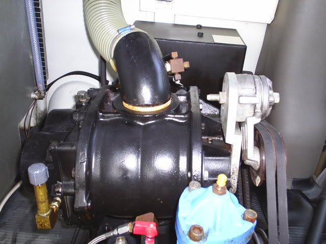

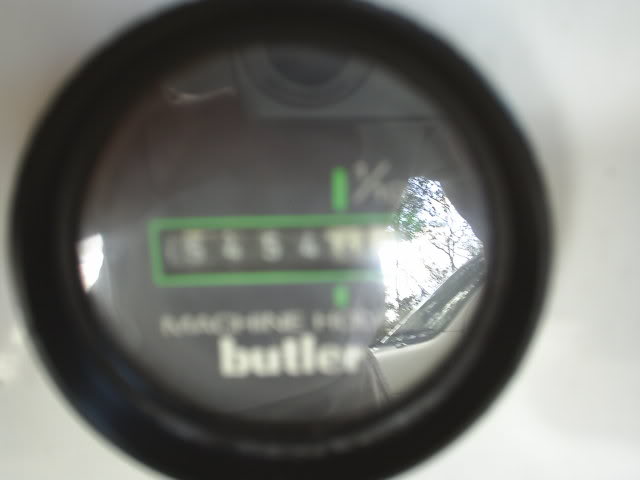

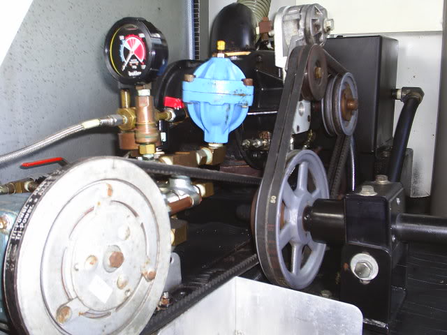

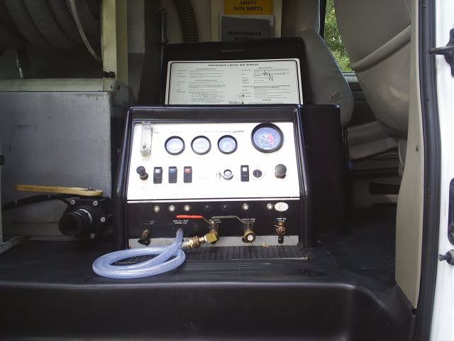

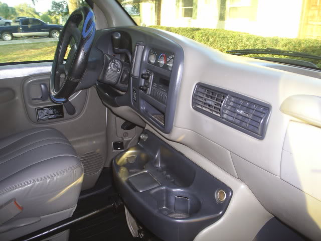

OH....BEFORE ANYONE POP'S OFF..about maintaince of the equipment..... :evil:
here is the pics of the 99 Butler at the time of sale in feb. of 08.."OVER 5000. hrs"
So KMA...... :lol: :lol: :lol:
