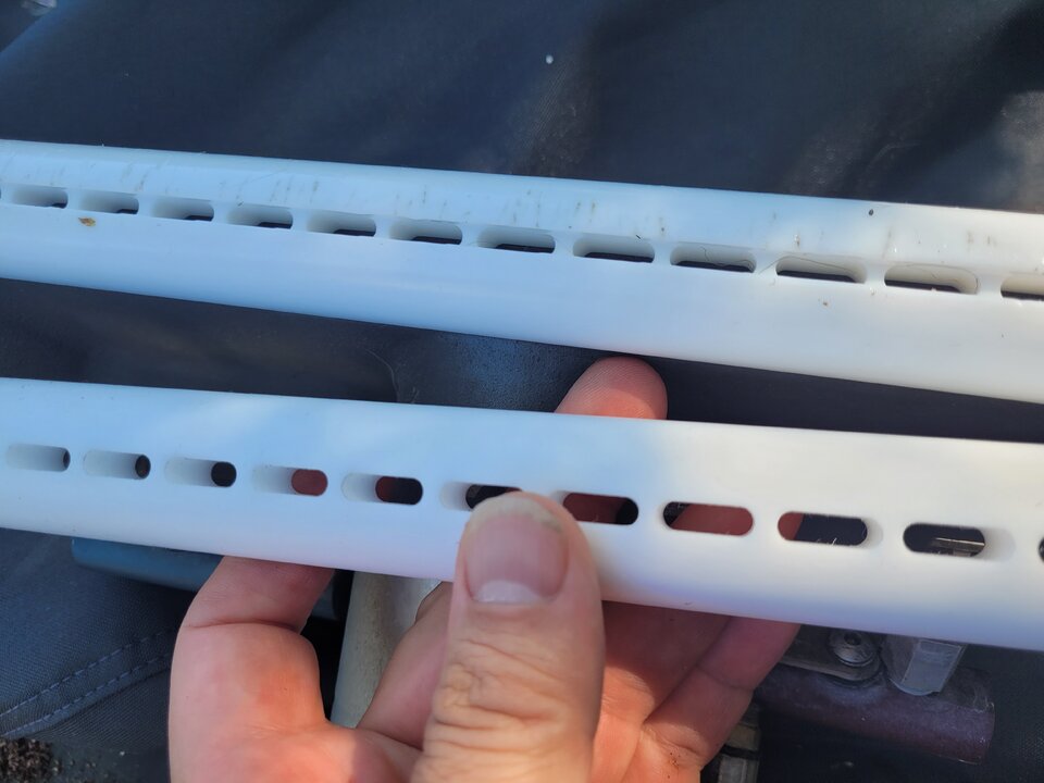

Because after a lot of back and forth and testing both glides. The dry times difference is minimal at best.
The hole glide struggles to suck up dead moths or similar debris we find in homes. I hate having to unhook my hose to suck something up that my wand should be able to get. And before you make assumptions about vacuuming. We have the customer vacuum, we vacuum, we prespray, CRB, all before HWE.
And if we are saying that slot cleans trashed carpet better, wouldn't it also clean any carpet better?
But, The argument that a hole dries faster than a slot I feel is a bit over embellished.
I do want to make it clear that the Green Glide in any shape is a true asset to any wand. I just happen to have a difference of opinion on which version is best.
I agree.
Slot allows the wand to pick up gunk like it is suppose to while not interfering with the massive air intake generated by #4 or higher blower.

No idea what groove your referring to on a Hybrid
Groove, no groove. The groove causes the glide to grab the carpet. Kinda defeats the purpose of having a glide :headscratch:
116,202
View attachment 130916 View attachment 130917
The groove is to prevent lines from the bridges and to create airflow at the end for better edge cleaning and reduce lockdown.
Many cleaners like the little bit of bite that the groove creates. Our grove is less grabby than others..
Try a glideless wand like a Prochem Ti or Quad sometimes, that tiny bit of grab is nothing...
