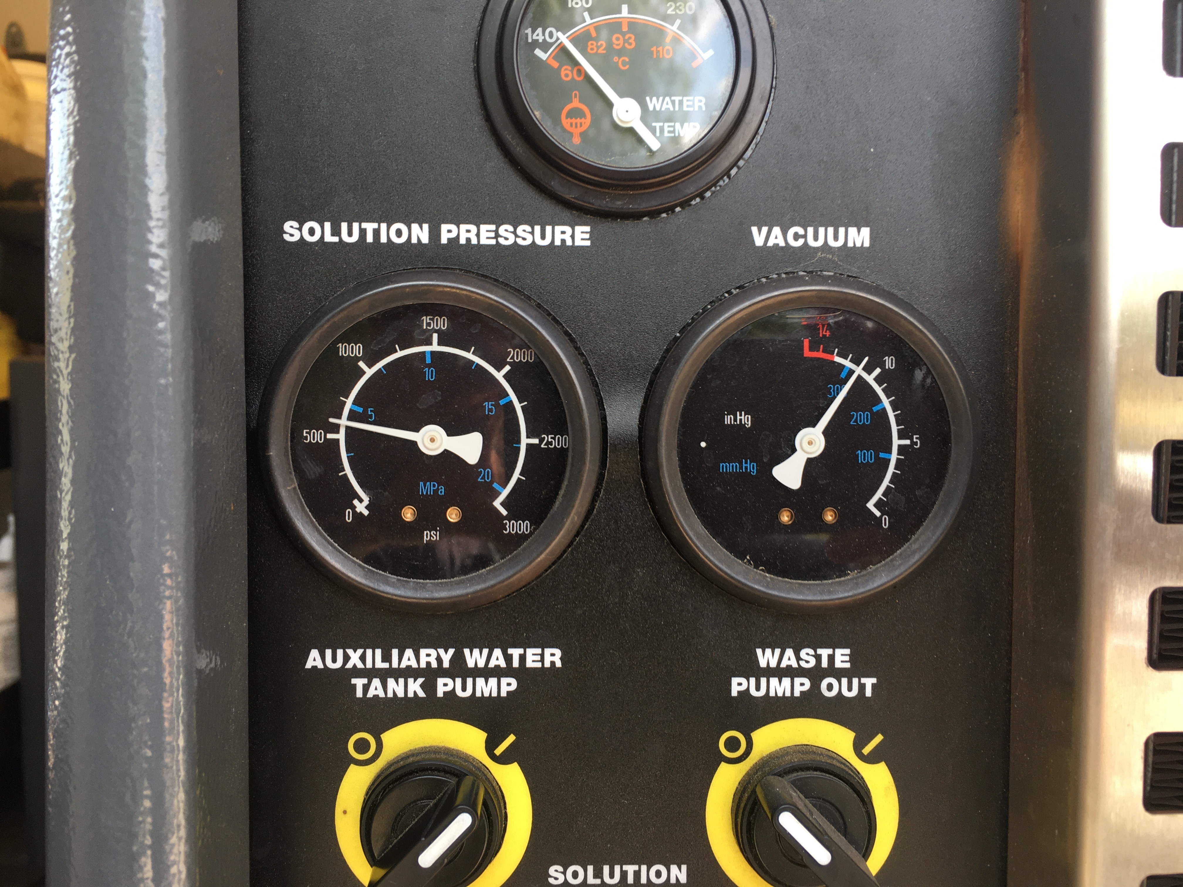

it's been so long since I spun a blower, but memory suggests 100ft of open 2" hose was around 6-7 hg
(45 spun @3200 rpm)
my 36 unit spinning at 3400 is similar

providing the filters are clean the hg shows the vacuum in the whole system, as vacuum increases your cfm goes down
dont know what your blower spins at? But prob pulling 400+ cfm around 8" but below 370 cfm around 14" looking at specs for 410 around 2600 rpm

I remember Tom saying that his custom machine is always at 10hg-11hg, and gave good explanation about it why that isn't necessarily a bad thing.
11,531
So would a 47 blower set at 17hg be a night a day difference compare to 47 at 14
On your wrists also the 405 had a governor and adjust throttle to load.
Most machine over come this by running higher rpms and fuel consumption
11,531
Prevents lockdown
(45 spun @3200 rpm)
That's why masterblend uses a 1 1/2 inch hose and gets 10 on a open hose run.
#restriction

So my question is a similar size blower ran around 13-14 hg vs steamaction 16-18hg what will be the difference as far as dry times and performance

Which is why I need my hg set around 14-15
I demoed the everest with two prochem ti and both on 50 ft hose run albeit a crappy carpet to clean.
