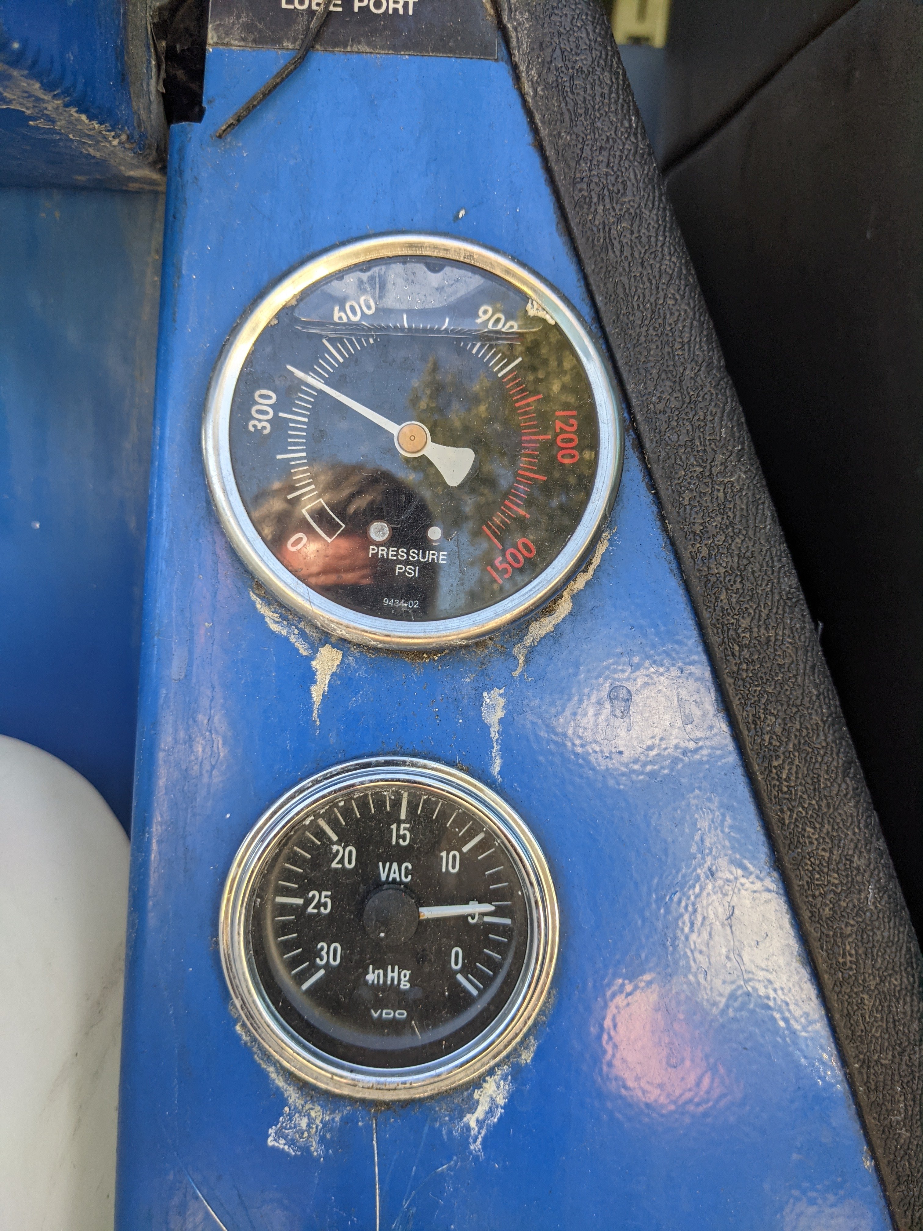

I think you must have a blockage or something. On my cds I get around 6 inches connected to a 1.5 inch wand, which is normal for most of these types of truck mounts. Sealing the end of the hose gives about 13 inches before the vacuum relief pops off. I could set it higher but that just increases wear on all of the drive components.

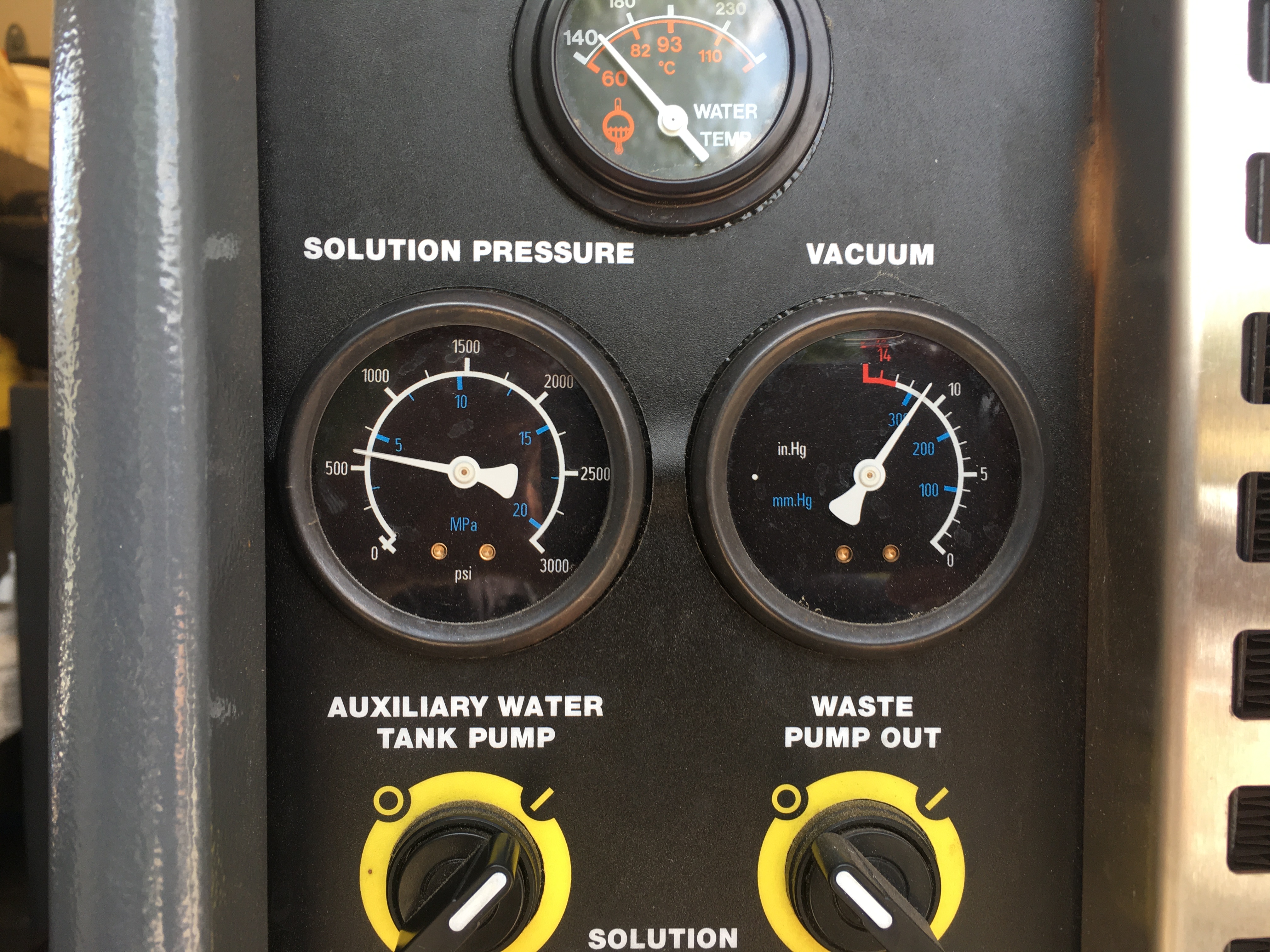

I don’t think mine sits that low with a wand hooked up I think I’m around 10
27,862
We should have everybody check their truck mount and post the results. Hook up 75 feet of hose to a 1.5 inch wand and see what you get.
14,078
Dude, if you’re only reading 6 with 150-200ft of hose hooked to a wand, either your gauge is bad, or your blower is weak.
