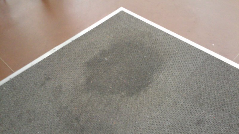

The first reply i gave them was a question. "What are you expecting from my cleaning?" Then we focused on the drink spills and fresh spots that they wanted removed. They are expecting the heavy traffic to stay there.
I'll go and take a pic of the other side to show u the spills that they want gone

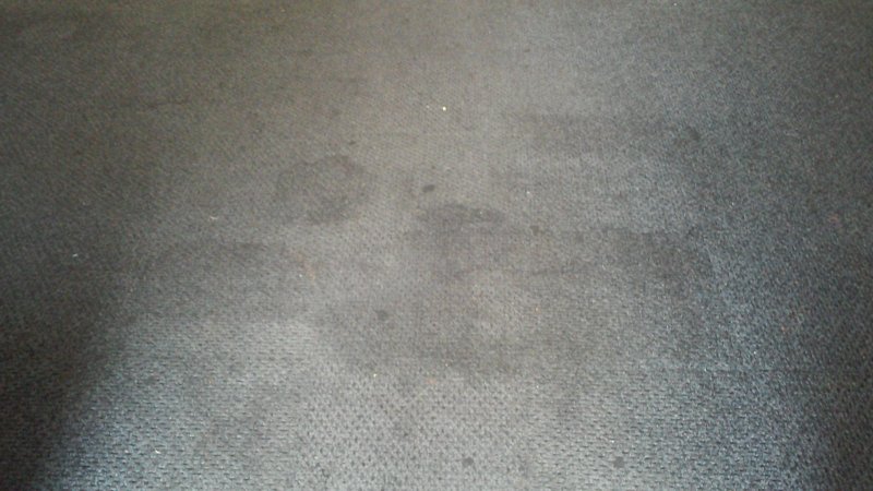

Here's the trashed side
