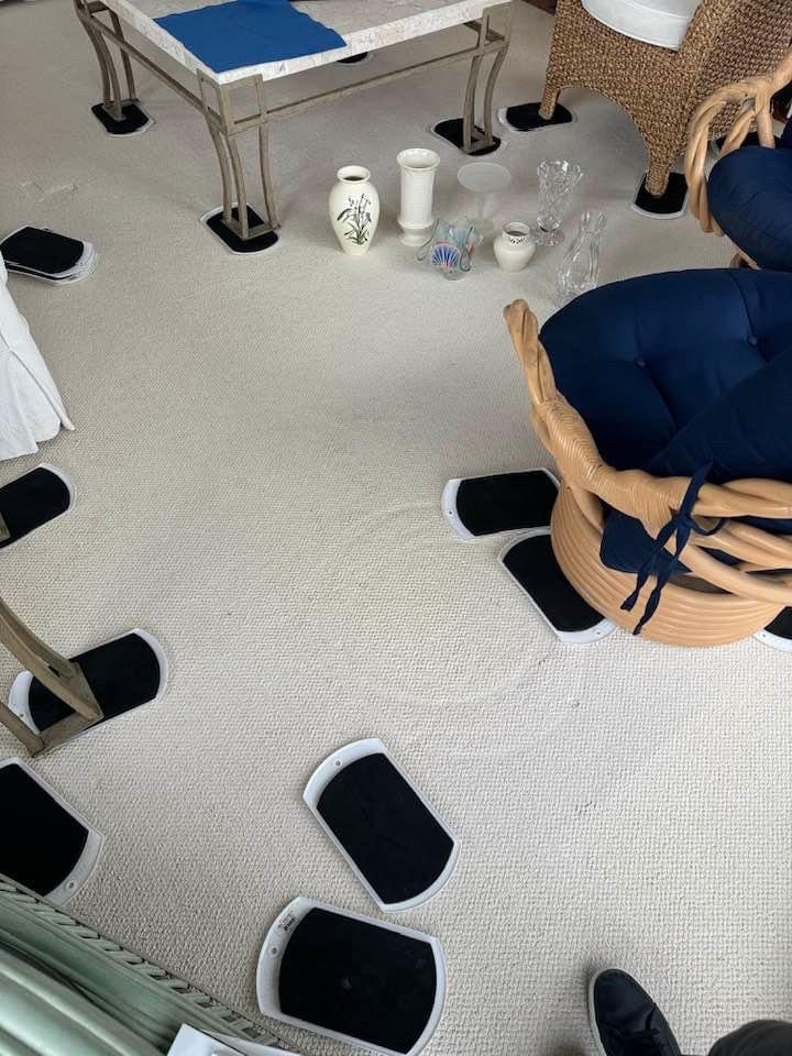

No, that came from the corner hutch that hasn't been moved since 2017. They were on the top shelves. Keep in mind, they were put back in place before I even brought hoses in. There was no water around. This was all to vacuum.
Once I properley vacuum, all those pucks are back exactly where they go. Then I HWE and dont move a dang thing. By the time I set up hoses, Im done with all the moves. I havnt had to disconnect my wand to suck up a bead in months. I vacuum, dust, replace, then clean like an averager good carpet cleaner. Its all in the prep. That is why I pad now too. I vacuum so good, HWE or VLM just makes it look good.
I only do high end now. I am leaning towards a $1000 minimum, because thats pretty nice to just do really good carpet cleaning in one house for the day. Long, short, it will even out. No rushing anymore is the goal. Its not worth it.
One man can do with his brain, what 2 men do with their backs. IMO
This is where the glassware was.... It was safe, but awkward to move. ez.
it was on the very top shelf, not to confuse you, not the best clip, self filming kinda stinks. My vacuumer is gonna have to be camera savvy.....

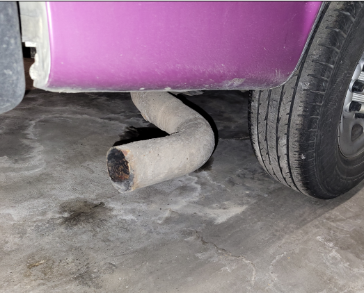

Nice! I did that also to my blower exhaust, which was pointing straight down. Had a muffler shop install a 90 elbow and ran a eight foot piece of marine exhaust pipe directly towards the rear of the van. Reduced the heat buildup under the van, prolonging the life of the fuel pump.
Reactions: Brian H

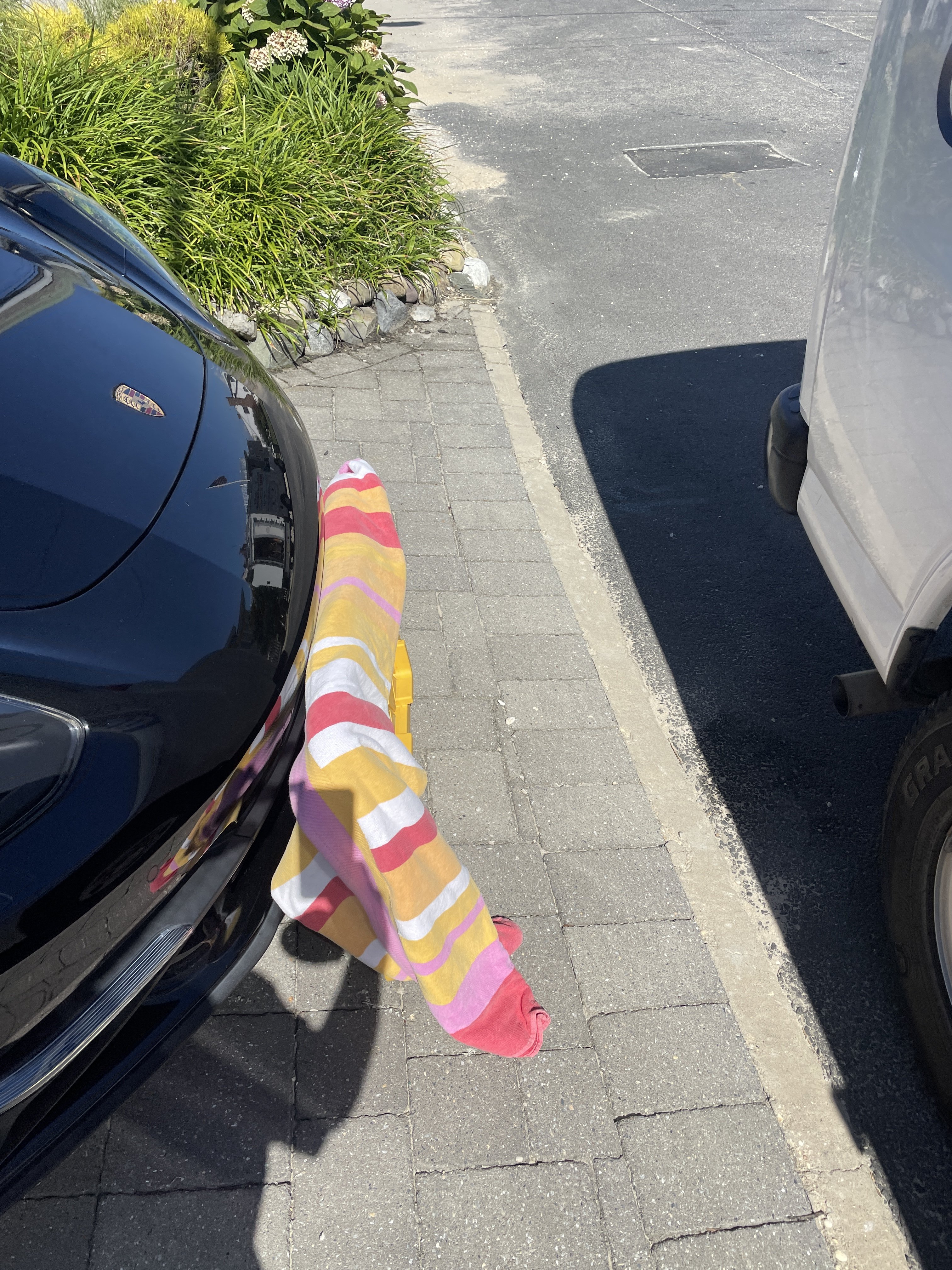

When people see we go the extra mile to take care and respect their nice homes and belongings, they always appreciate it. No other place to park, I felt my exhaust was a little close to the car. put up a plastic shelf with a towel so I didn't cause any problems.
House was treated just as well, and this was the tip.
Super nice people too, not what you would think. People love a step above mediocrity.
