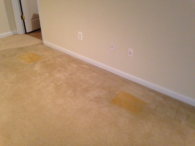

Here's another option for removing furniture dye stains on carpet that wouldn't come out from cleaning.
These were two large stains that were on the carpet in a house that was on the market. There were two stereo speakers sitting on carpet that was still damp following a cleaning. We tried removing the stains using solvents and Cobb's Stain Remover. NOTHING would touch them. So we ended up bleaching out the stains, neutralized the bleach, then re-dyed the areas to bring them back to a perfect color match, thus eliminating the need of having to replace the carpet.
