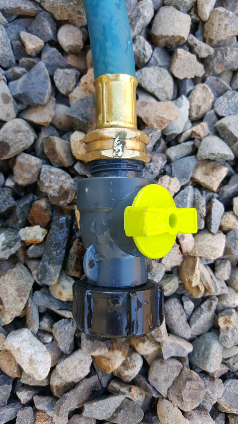

Sorry, I'm not getting the point.
Is it just easier to hook up with this attachment to the bib?
I always bring a channel lock and leave it there end of the job to disconnect my hose. Always reattach customer's hose or sprayer.
Love
Man sized colar and valve knob
$4 at ACE
Dont forget a screen/0ringView attachment 18551
