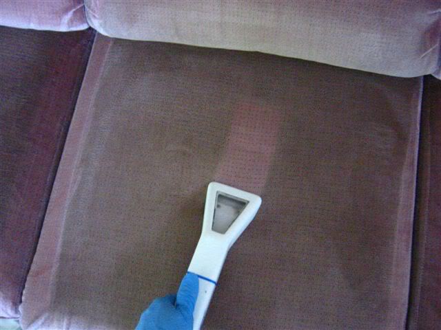

Yes
It does an okay job, has good and bad points. I do love not making a mess on the floor as I did with the old kleenrite. I like that it has no trigger, easier on the wrist and fingers.
I'll be trying a Prochem tool this yr, I think it will work even better.
