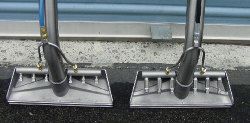

Jughead said:
I cant think of any other wand that would get these poll results
The original Century 400 12" S-Bend wand is the most ripped off design in the industry.
It is sold by Prochem, Interlink (AW-29), U.S. Products at one point and many others.
It is used in multiples of any other wand design.
A popularity poll for that wand would be extremely high.
I just talked to Doug Johnson (former Century 400 nat. sales Rep) and confirmed that it was designed by Bill Shero (Century 400) , Teresa (CMP) and her ex-husband Don (partner of Tony).
So who is ripping off who's designs ?
Larry
FB7777
Nearly all design is evolutionary, not revolutionary
Copy an idea and then improve on it
For me, I love what Greenie did with the CMP 14 inch wand... Own 3 of them
And I trust the guys that swear by the Prochem Ti wand

I remember the PC Ti wand unveiling . . .
Impossible to scrub with . Only the Canadian inventor saved it from a quick extinction . . .
New wand designs will have better Airflow, and some will swivel . . .
Tom Conway liked the swivel action a lot, in his last wand review.

Exactly what did Greenie do to that wand?
FB7777
Before I bought a Greenhorn, I was using a 14 inch 1.5 tube butler wand
The "attic" of the wand had removable plugs to clean out the hair and junk
I don't think he did all that much but it was a massive improvement from what Inwas using
I like that the green horn had check valves , didn't clog and had far better airflow than the butler
The cmp wand and greenglide is a major step up. I don't buy every latest and greatest techno tool.

My impression has always been that Greenie did nothing more than take an already existing wand and put a glide and jet extenders on it. I have a Greenhorn which my son uses.

Greenie & Lisa did make some nice improvements to a good wand (CMP 14"Low Profile) . . .
IMO, the most significant was angling the jets, and adding the glide . . .
Jet Extenders/CK.Valves and wider Sprayjets completed the package.

I don't like the long extensions at all....I don't think it allows the jets to do there job as well....it does not allow them to fan out and they over lap to much giving it a water streak..........the shorter ones are the best...but take all the junk out of them...the springs and the balls sooner or later just cause a distortion.....and its not like they are going to stop a wand from dripping anyway.....
as far as the angle.......does not make a bit of difference....set it so it just hits the carpet behind your glide...and it is what it is........
