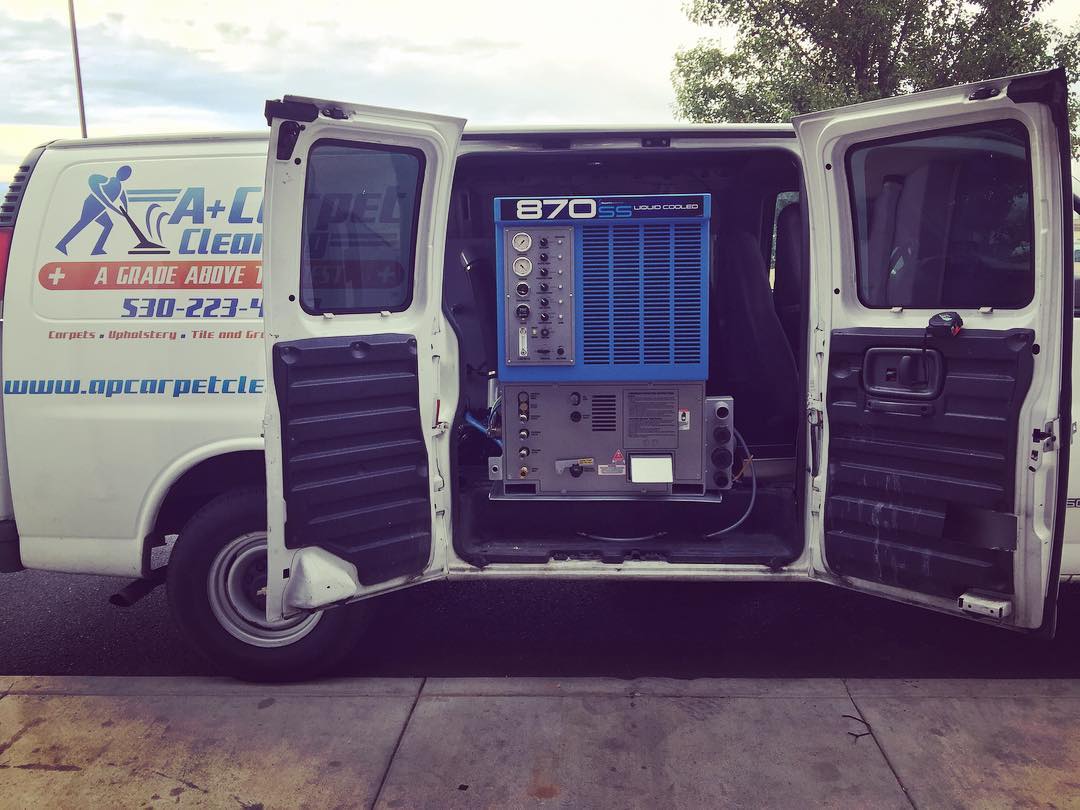

Just throw the 870 in that thing, and you and Macy could travel the country and make money....
Who knows, maybe you’ll become a trend setter...
