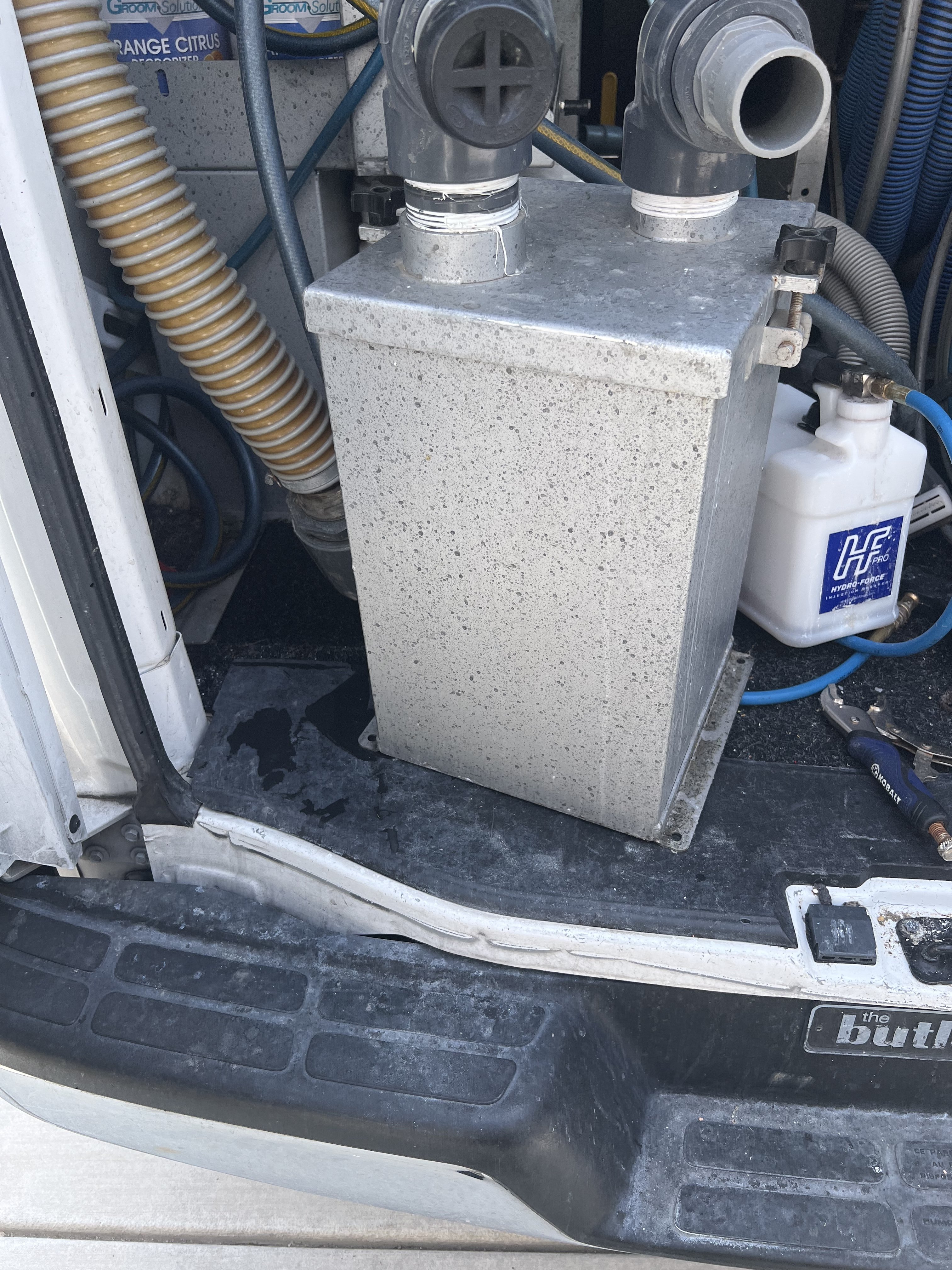

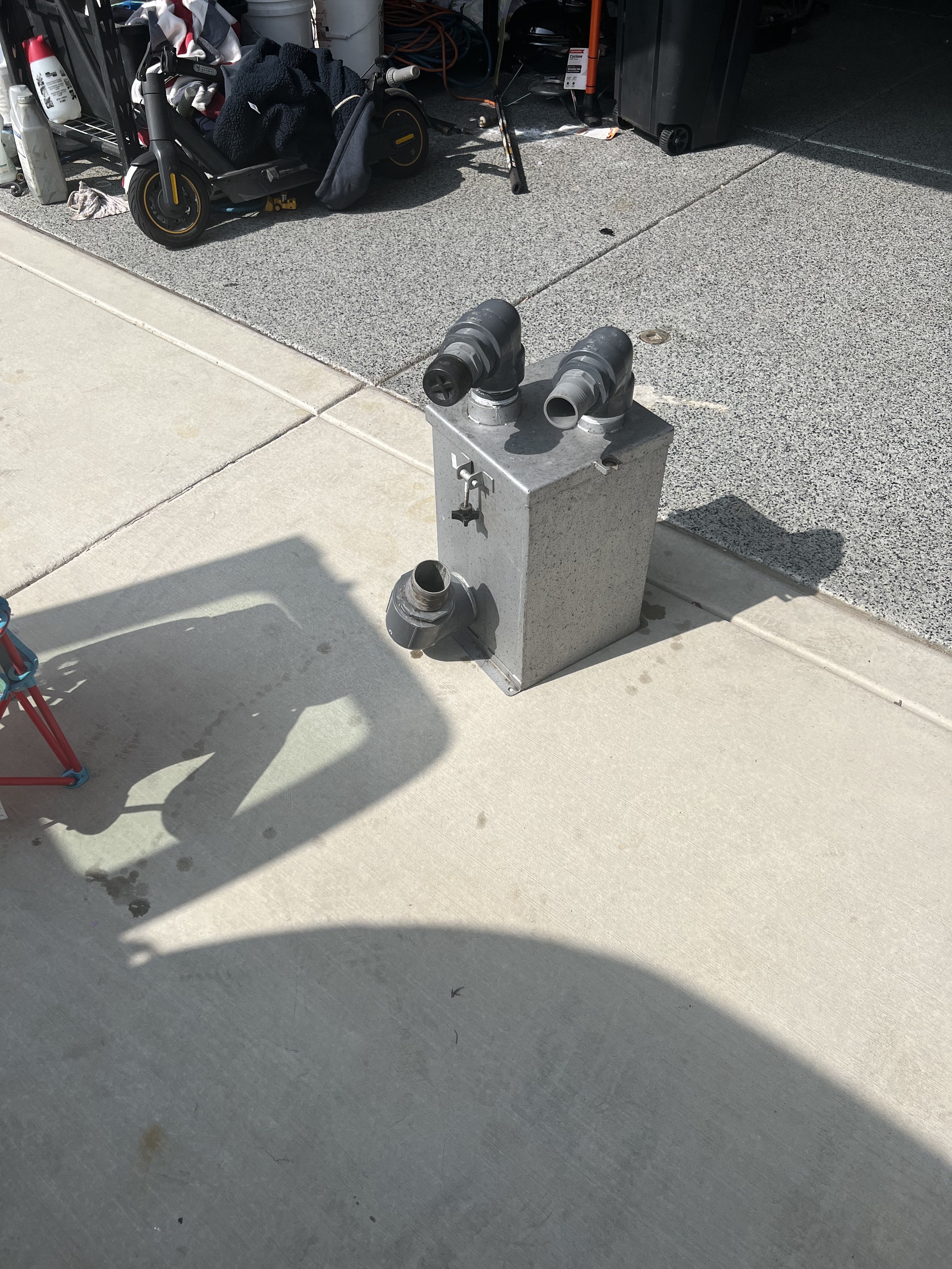

I bought a butler and so far has been great but on large jobs my tech is telling me the filter box is filling with water and he is loosing suction? I’m gonna be working on it tonight any help would be great!

The clog should be an easy find

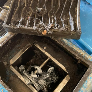

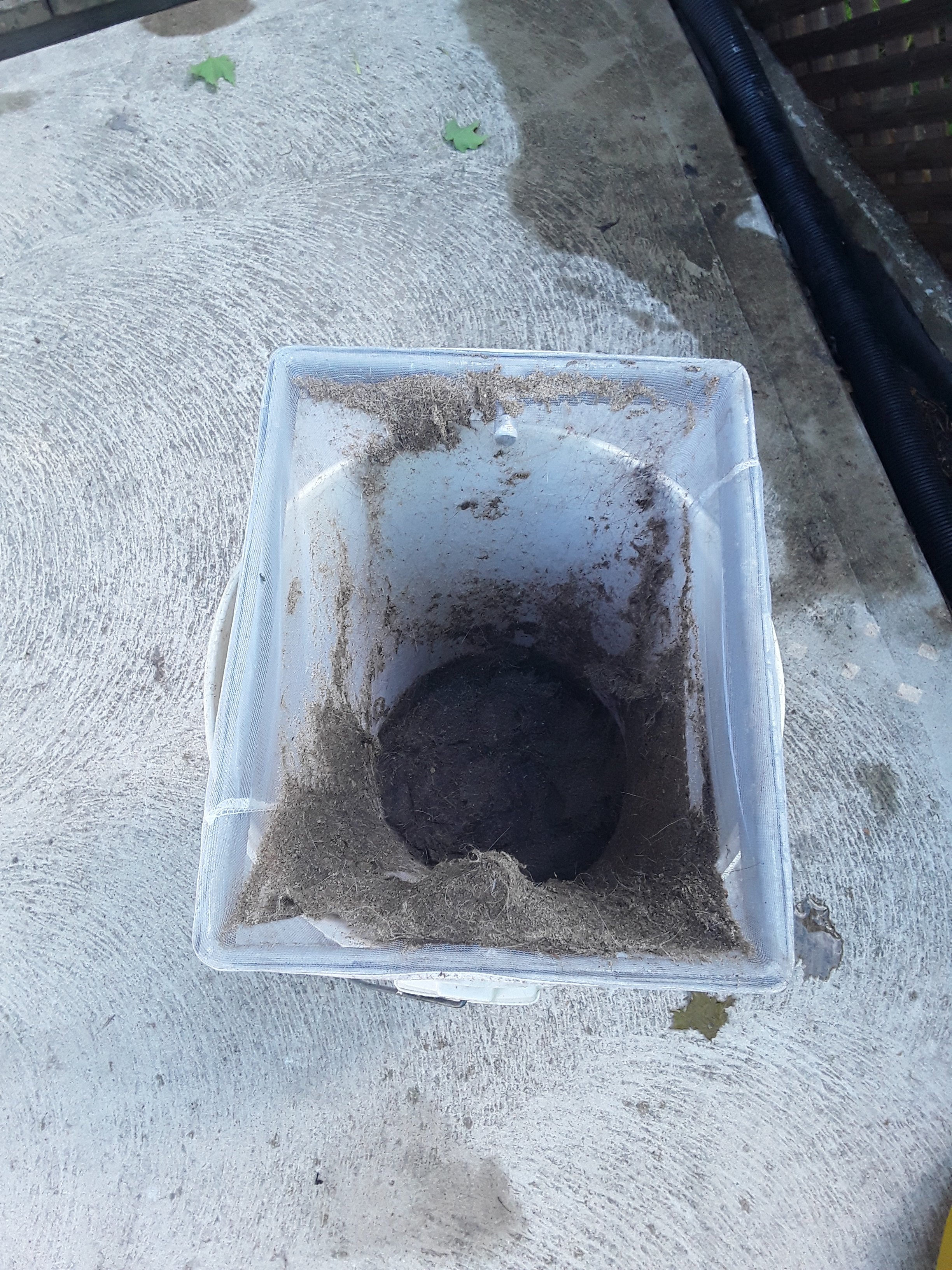

Well the clog was in between my employees ears he was removing the sock filter and emptying it but not spraying it out… it was covered in dirt and sand and couldn’t breathe I took out the box and cleaned everything out and showed him what to do…

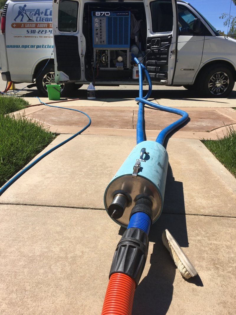

i'm talking about one of these, Jay
Mr Brightside
Cleaning Professional
May 4, 2019
942
Jay Wags

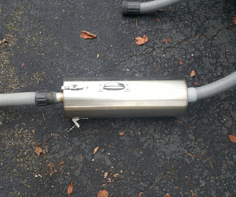

your van looks constipated lol how did you get that beast in there... I have that same setup in a box van. I like how the butler one is setup because its easier to use the filter if I give them a devastator they wont use it because it will be easier not to. I am gonna order a reusable one through butler.

I had the Devestator and sold it because of the pooling of sludge water that always seemed to leak from it.
This is my in-tank filter that fits into the top of my waste tank. You can see the aluminium frame that the paint filter attaches to. All kinds of breathing room for the blower with this set up.
The filter can be washed down mid job if needed.
