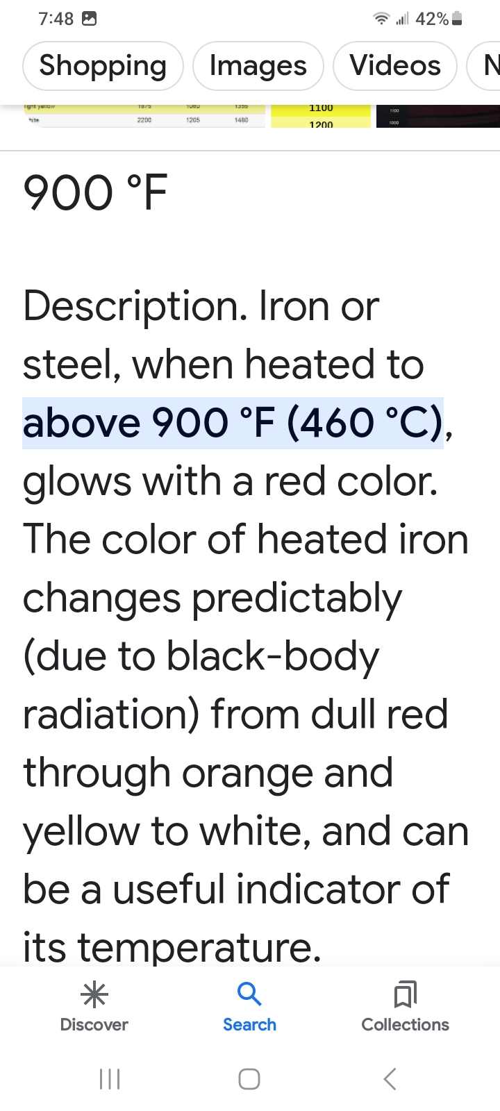

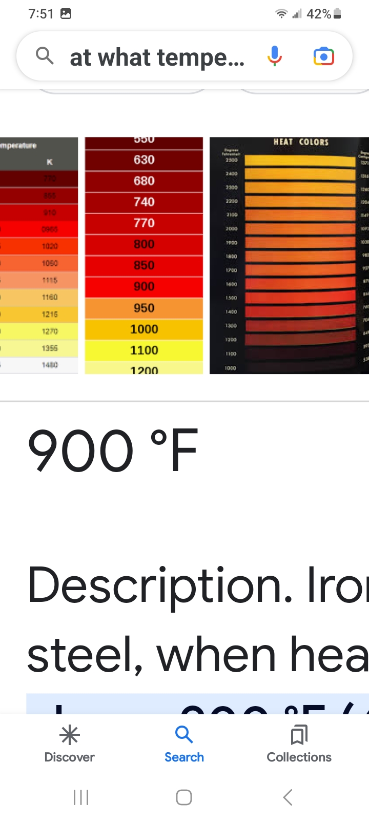

I only saw the mustangs headers when it was under load on a dino and the vans exhaust manifolds glowed when i accelerated hard, so under load also .
I don't know anything about these carpet cleaner engines i just assumed that under load they would glow also. I just googled normal operating temperatures for catalytic converter

Ive been following this forum for awhile and assumed that glowing manifolds were normal, but im a pto guy and know next to zero about specific engines like yours my knowledge is more general
