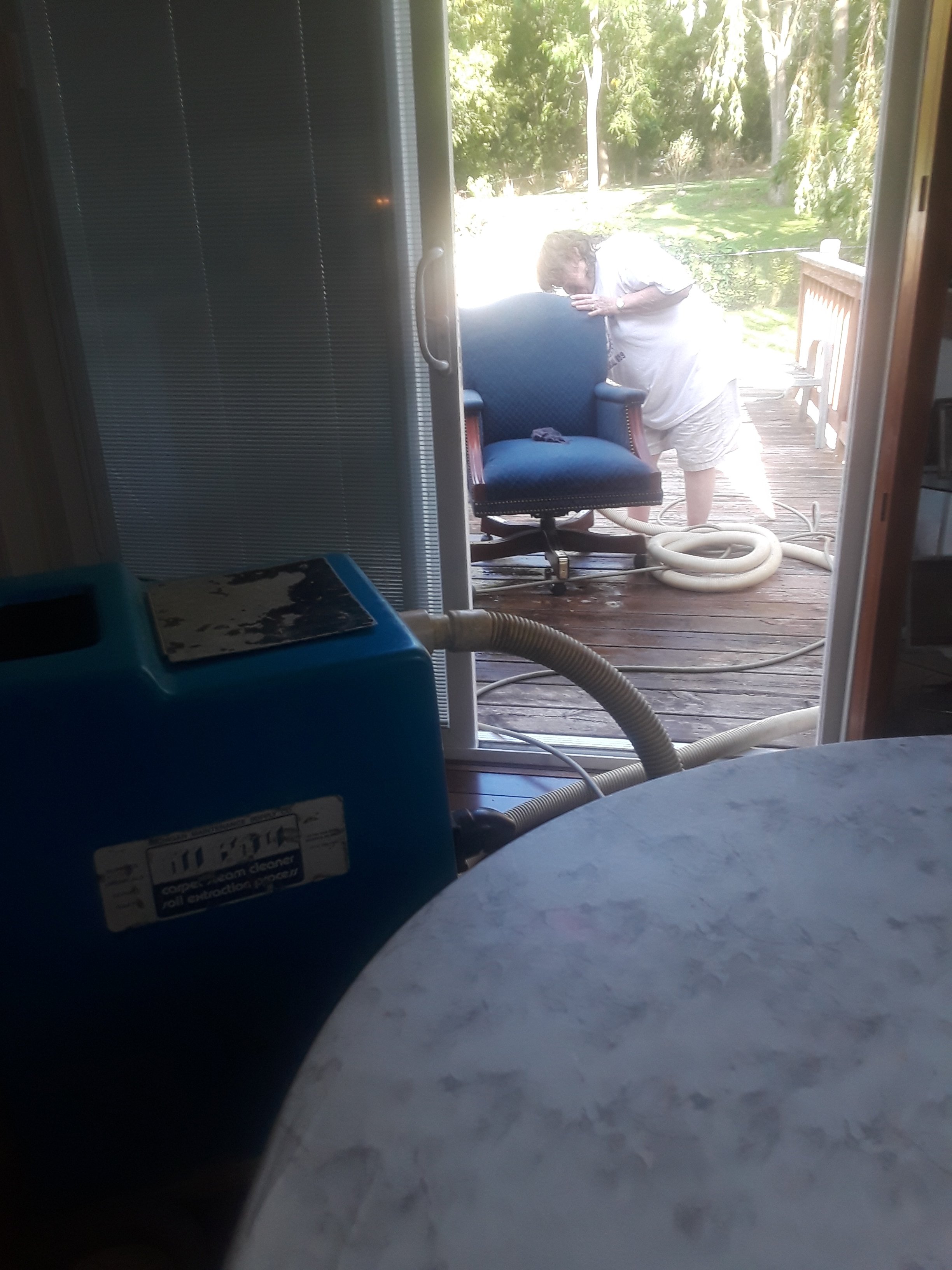

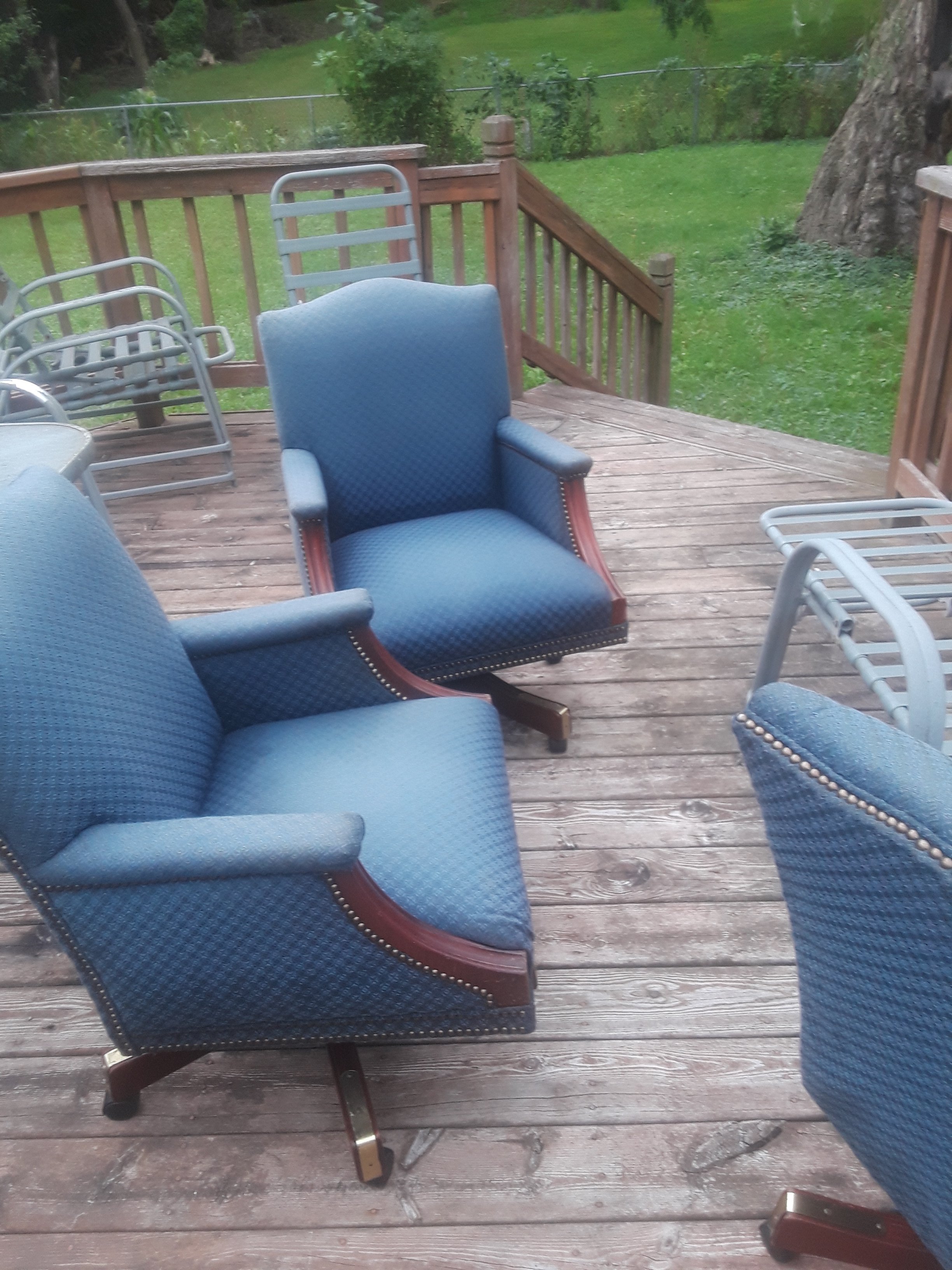

Art Kelly gave me this: I have no idea
What it is but it does a great job on the hen chairs...

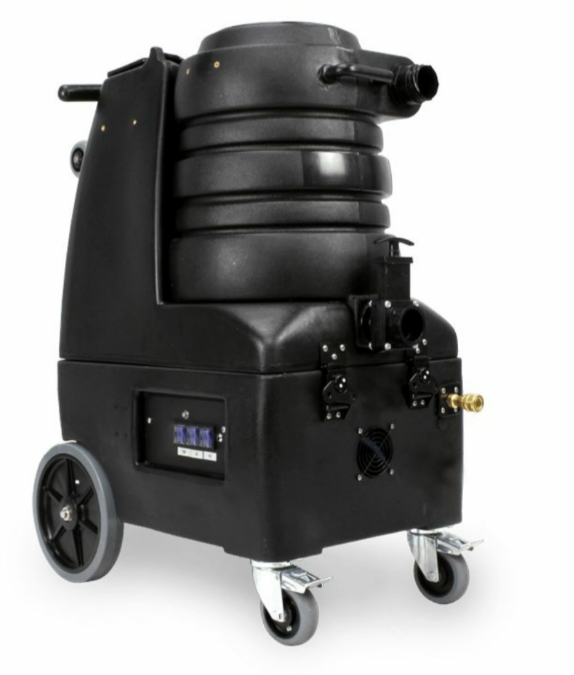

In that case, the nautilus would be a great machine. Heavy but manageable as long as you don't have to go up stairs with it. The 2 8.4 inch vacs can be configured for series or parallel. In parallel with a 50 foot 2 inch hose, the vacuum is incredible. You will get great drying times. The 500 psi pump makes cleaning a breeze. It can be prone to blowing circuit breakers on the circuit with the pump and vac motor. Usually needs a 20 amp circuit. The other cord is fine on a 15 amp circuit unless you are using the auto pump out.

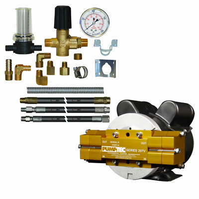

3 The cat 1xp pumps last longer than than the pumptec. Way cheaper too.
