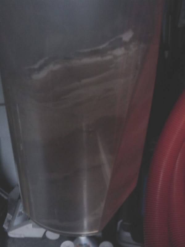

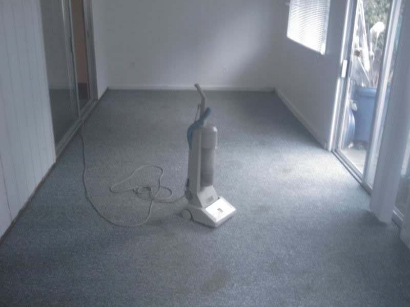

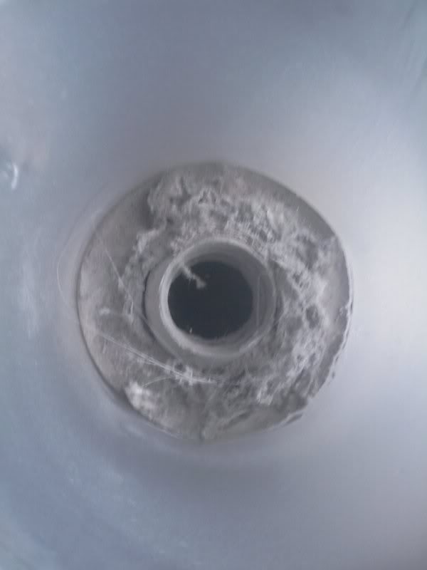

dry vacuum the bugger, you'll eliminate 99% of any wicking issues
You can flush it as much as you like after, it'll come clean as a whistle.

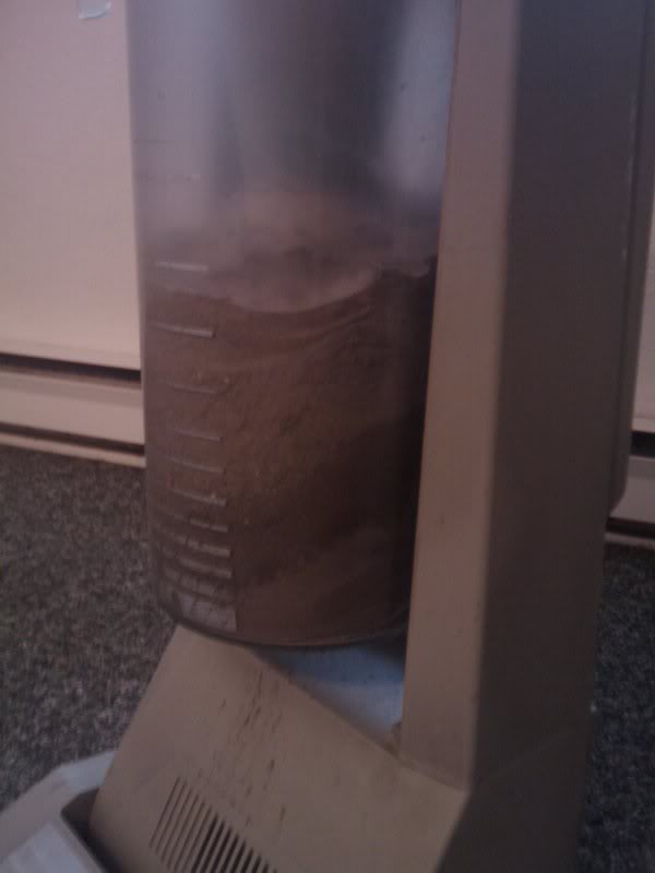

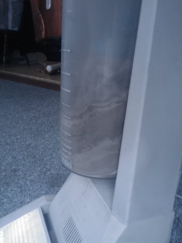

My last berber, on the 31st
the worst room
from 500sf of berber, the above room and the living room
From the whole place. Whiter soil/dust from the 3 bedrooms
layers are always interesting
