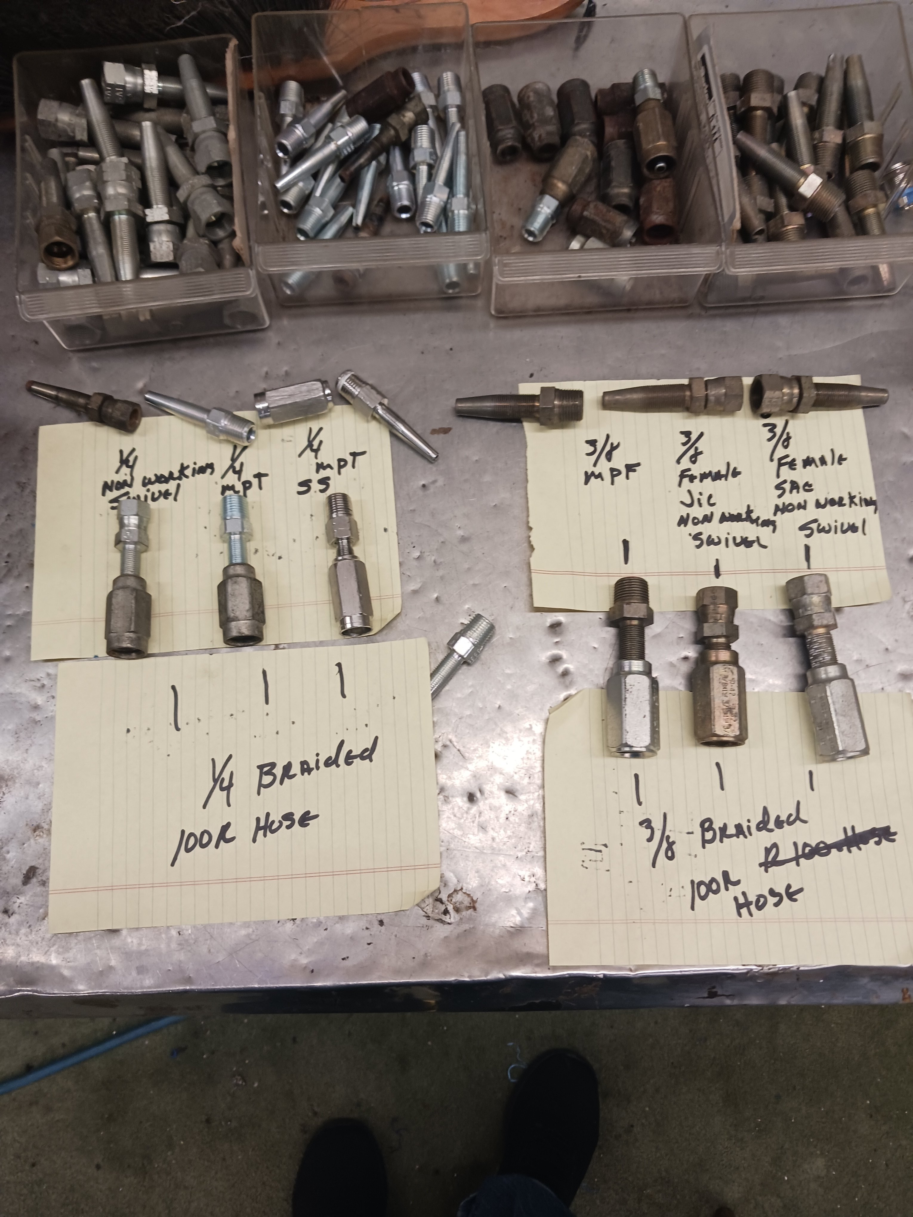

What would the extra cost be to put swivel connections on every hose end on said machine. It would make replacement-repairs infinitely easier.
Sorry busy showin off forgot to completely answer your question. All my fittings on Frankenstein are stainless so each hose cost me an extra 9.00 for the male jic connection on the machine (1.89 if it were brass) and additional 4.75 each for non working swivel end on the hoses . All my hoses are made with screw on ends apposed to crimp on but the price difference is about the same . So in short if you were to (and most manufacturers do) use brass the retail price is approximately 6.64 per hose more. Hope that answers your question

gary
dwain, can you post a pic of the screw on type and explain why you like it more than a crimp on? thanks

Dwain Ray
Jul 22, 2020
875
Why i use screw on ends In one word convenience, the nearest place for me to have a hose made with 100r hose is a 5 hour drive round trip (100r is your standard carpet cleaner hose) or i could wait to get it ups or ten minutes in my shop and i have it, one of the advantages has been that since I've been using them for several decades now the outer part doesn't wear out so i keep recycling them and only purchasing the inner piece however while building Frankenstein i came across a company that builds solid stainless steel ones they only offer them in 1/4 100r hose with 1/4 male pipe threads perfect for solution hoses i get them from Wanders another advantage has been if an end goes out and starts leaking or spraying on the job alot of tomes i can unscrew the broken inner stem and screw in a new one and continue and not have to remive and replace the hose on the job. As far as how long they last probably longer than crimped because they are thicker

Dwain Ray
Jul 22, 2020
875

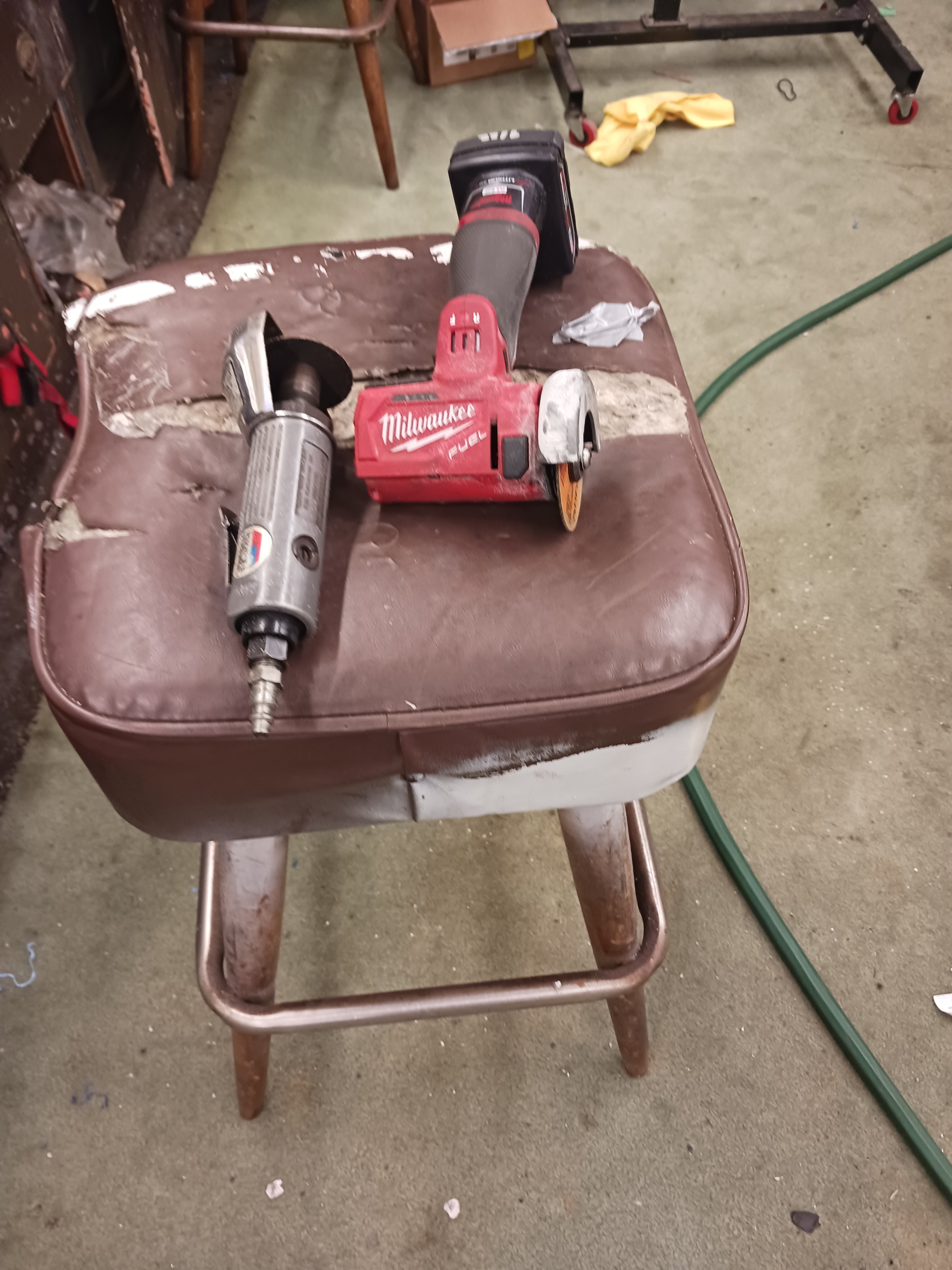

If you're considering going to these ends i strongly recommend that if you don't already haveone invest in a cutoff tool it'll save ya alot of headaches šŸ˜‰
