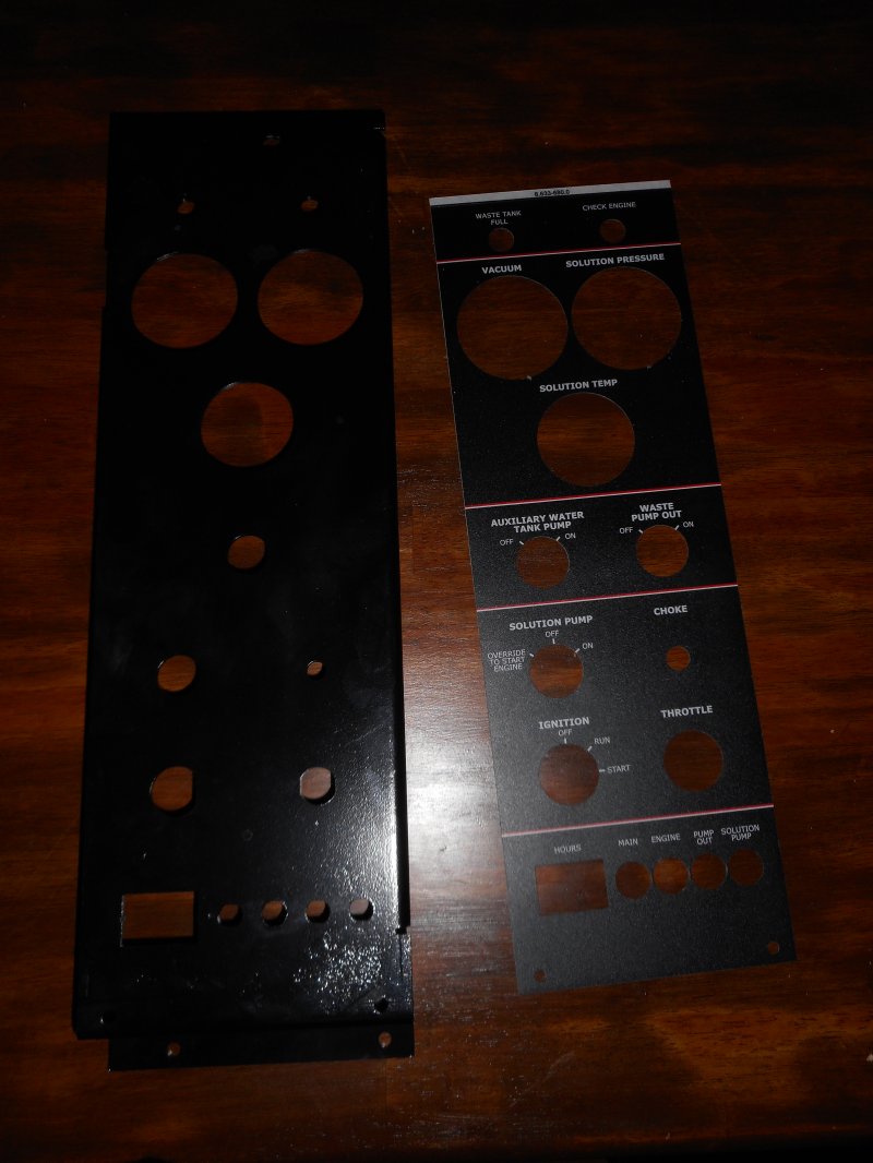

This one was a LOT of work, nothing went easy for example::madder:

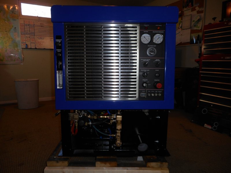

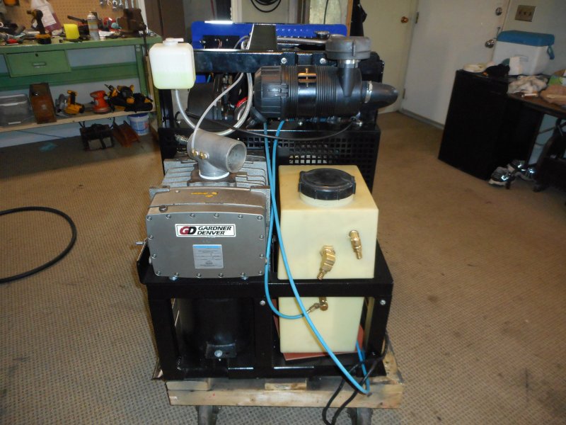

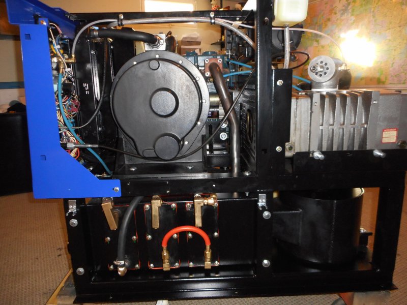

Plumbed and wired..
Reactions: EDS
Able 1
Apr 12, 2008
6,469
Keith

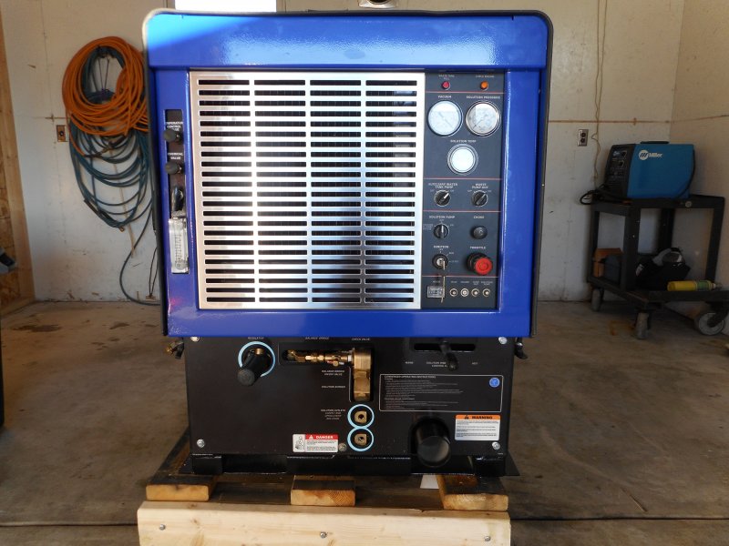

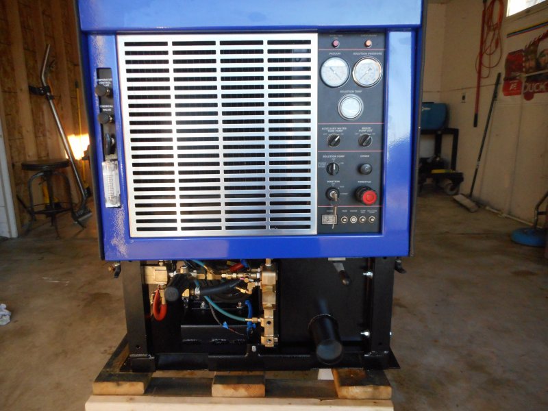

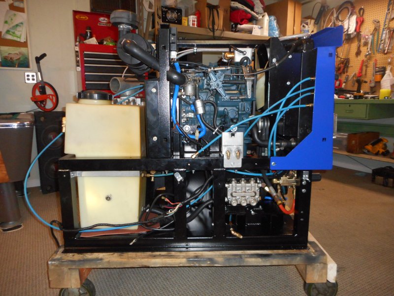

Planing to run it tonight..

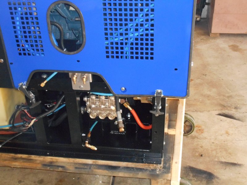

I decided to go with these hood latches instead of putting the rattle clips back on..
Reactions: Nate The Great

Looks good. Have you done anything with the recovery tank yet?
Able 1
Apr 12, 2008
6,469
Keith
I took it in I'm going to have the whole thing skinned with sheet aluminum.
