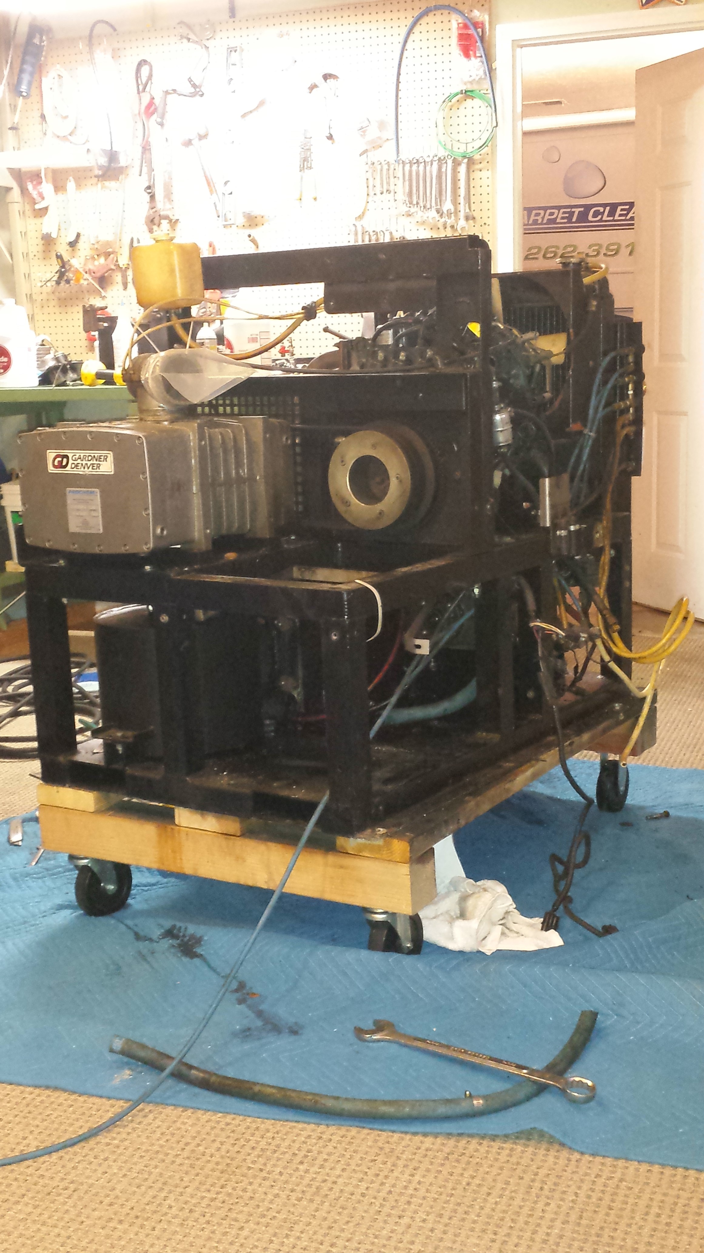

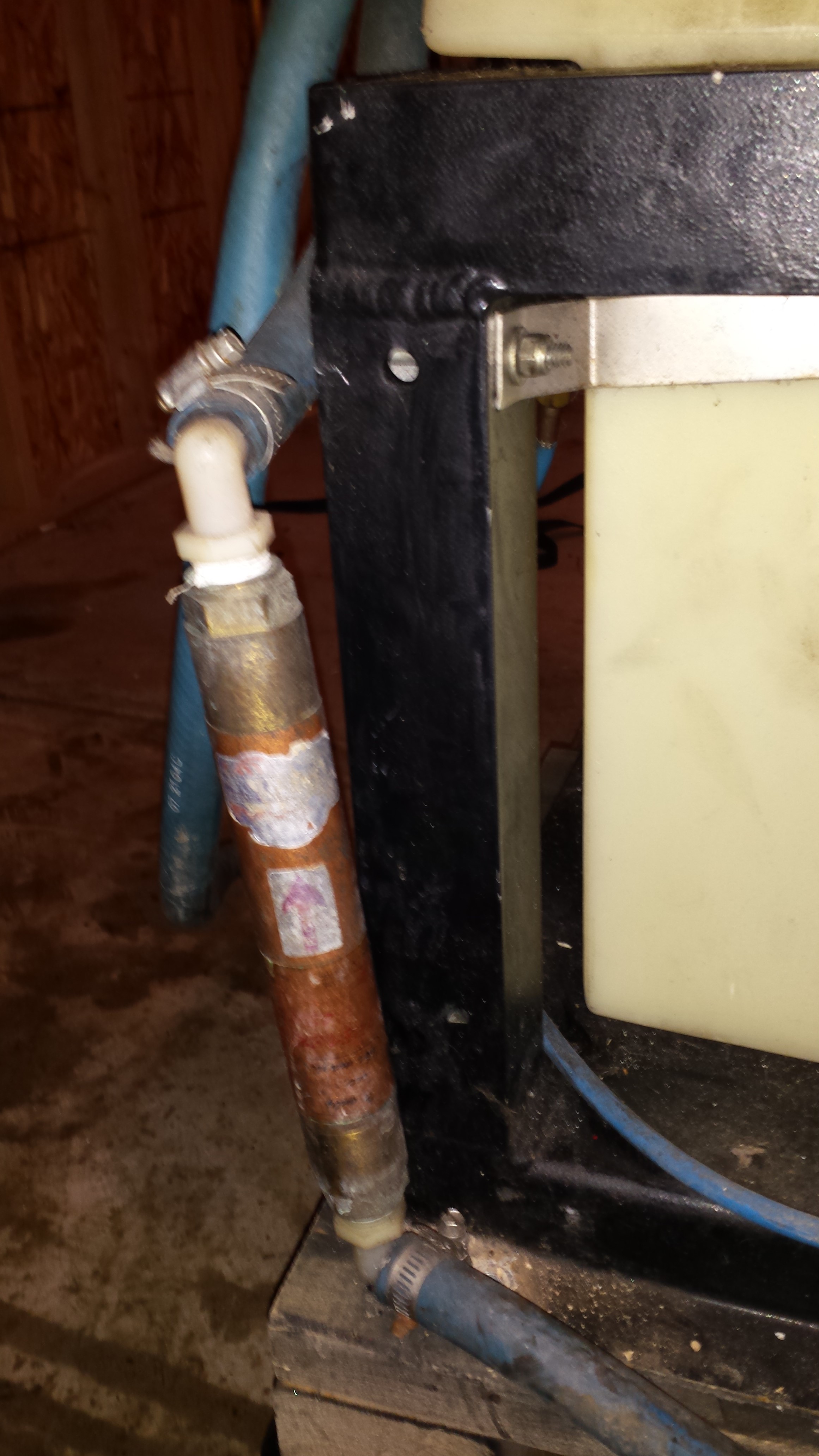

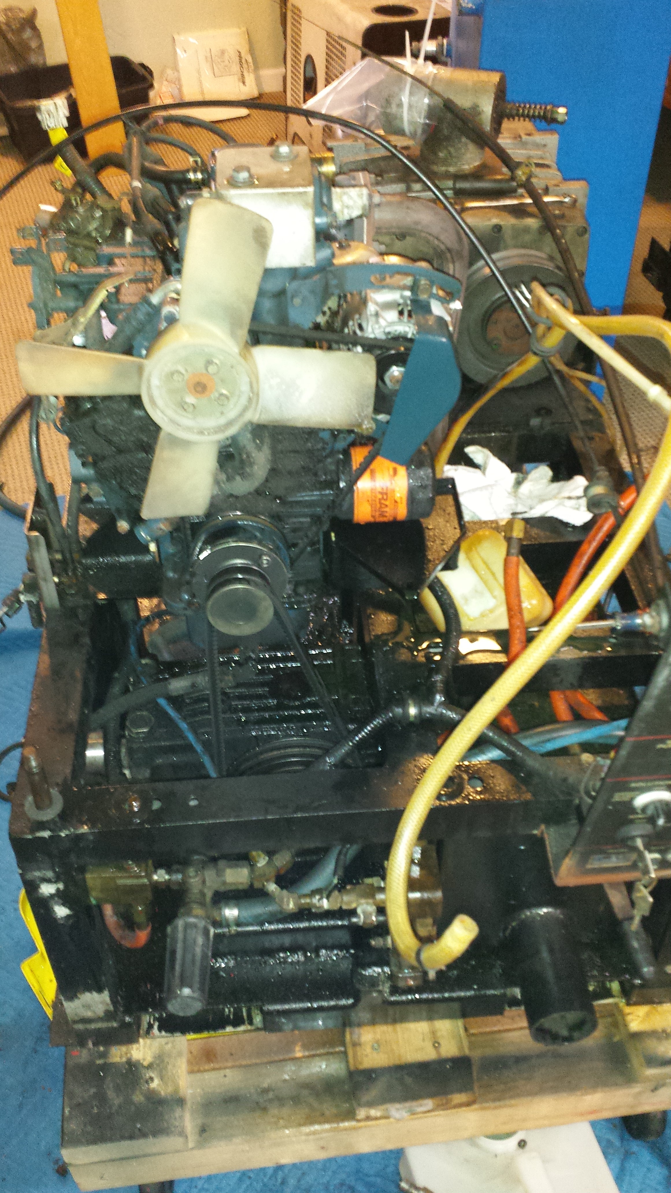

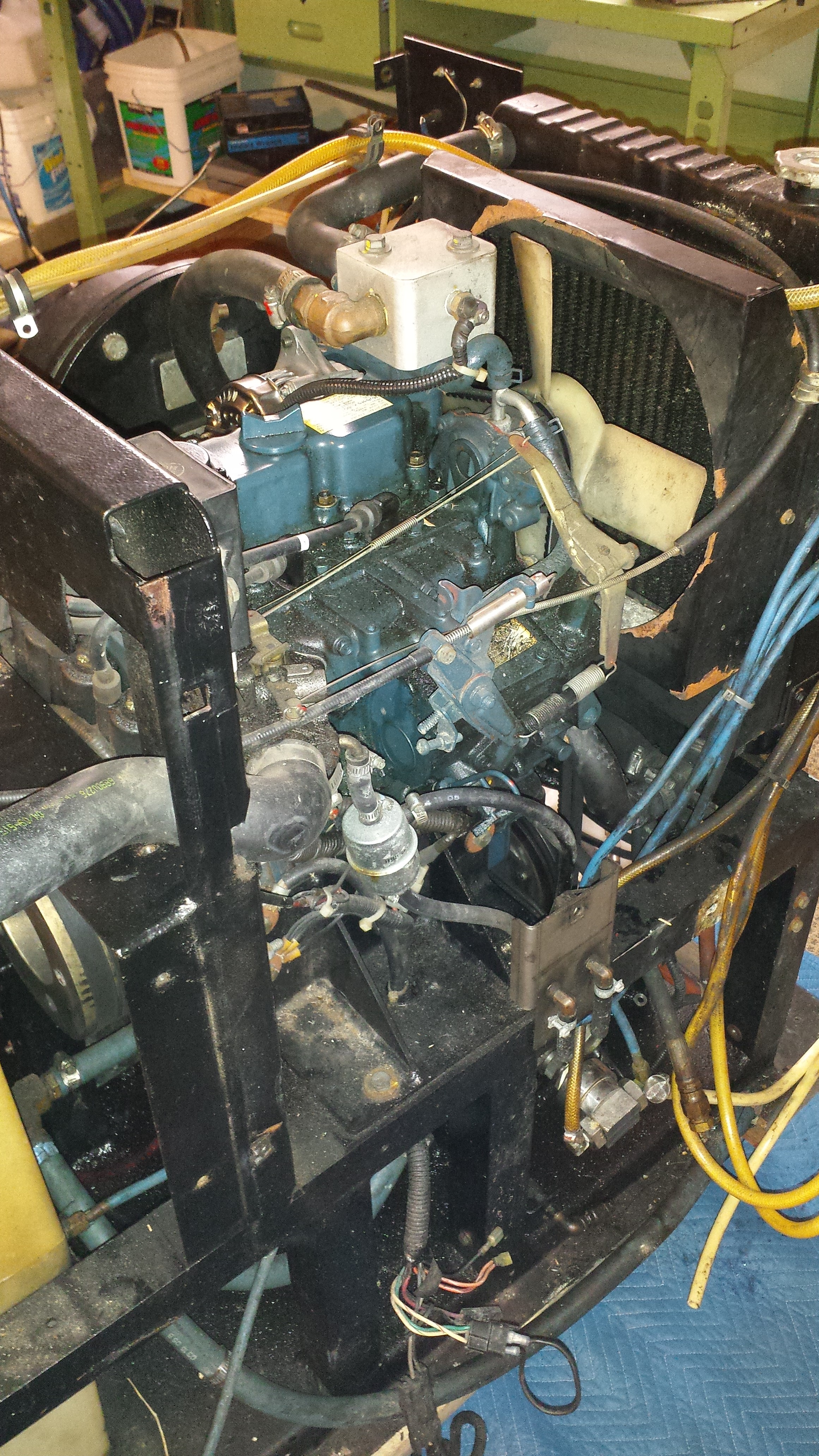

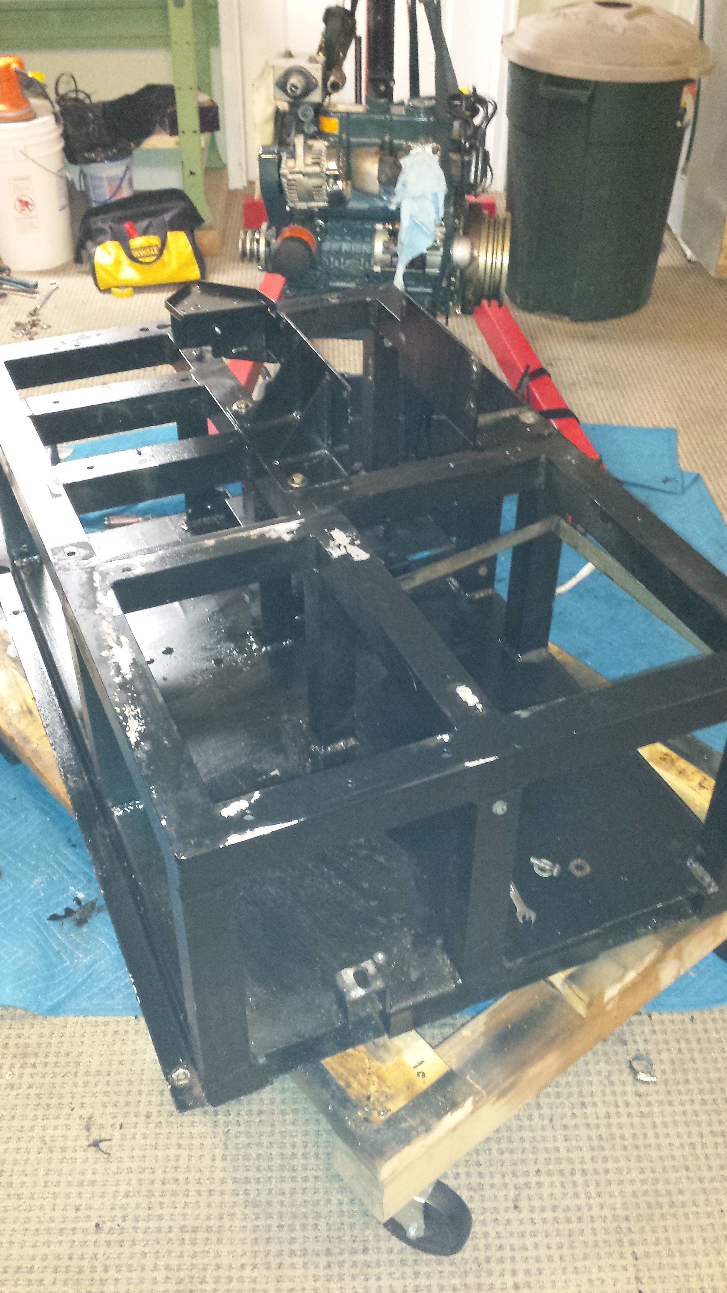

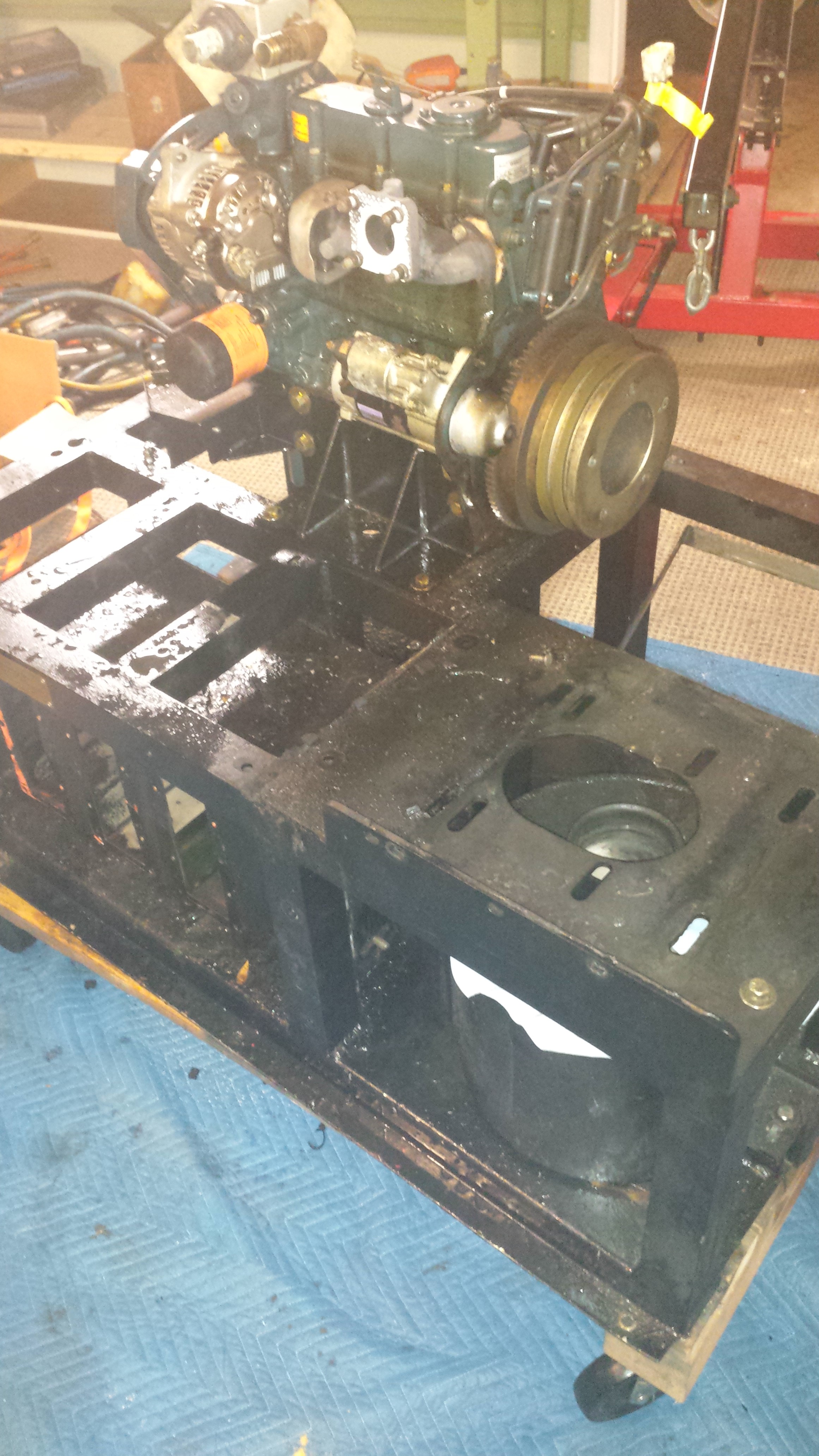

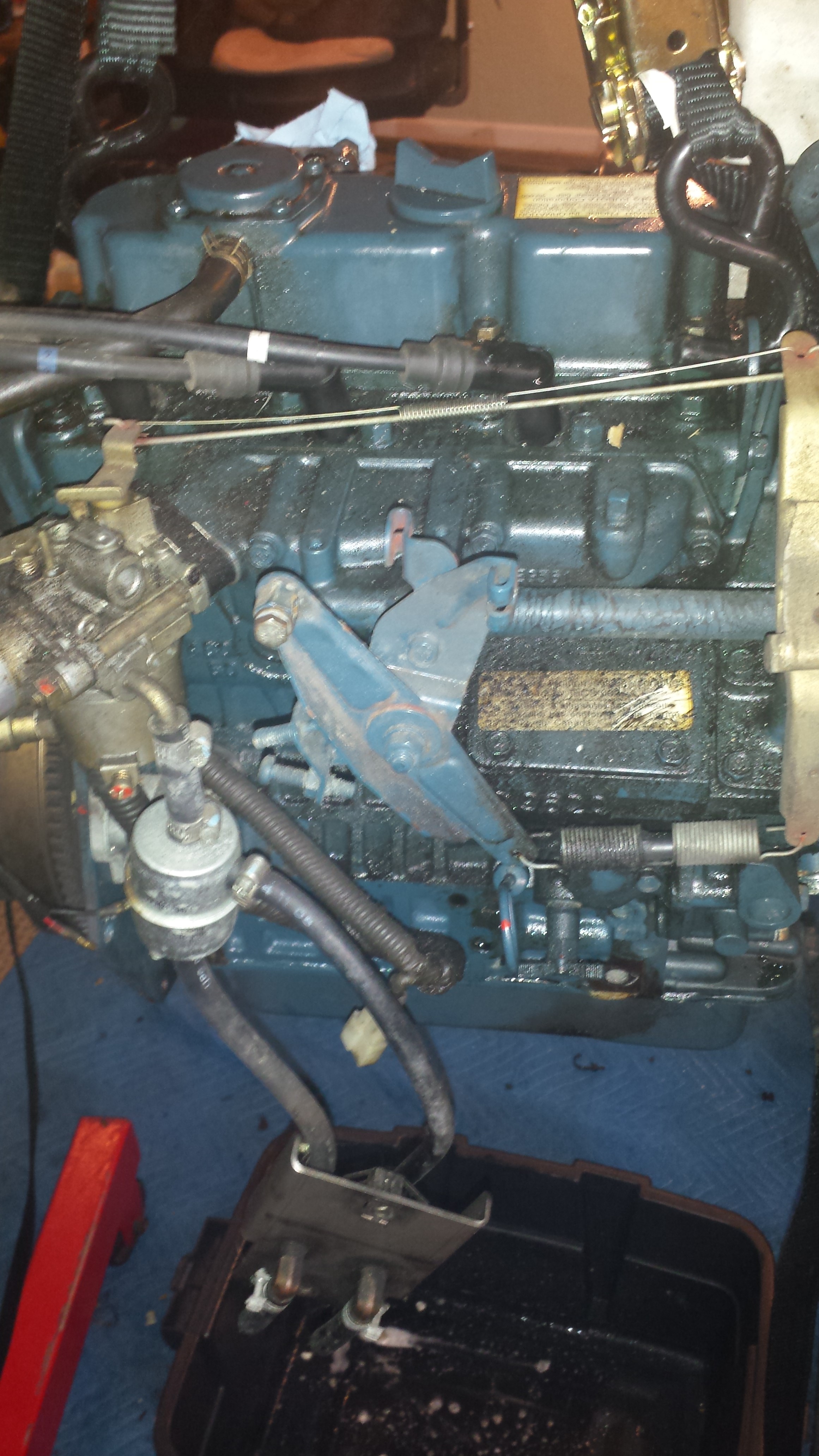

Keith I broke a copper pre-heat exchanger once too. At least you didn't break the stainless one. Just curious how difficult it was for you to reassemble the machine?
I took the heat exchanger into a radiator shop for them to take a look at..
If you just take one thing at a time both taking it apart and putting it back together it's not so hard. Just take your time and remember how everything is set up..
The worst thing for me is the wiring.. This time I checked all the wires and found 1 crispy one and a bad connector. .
Reactions: daniel@procarpet
Keith do you replace all hoses and belts or are you keeping some? It looks like all new hoses?
A
Able 1
All new belts, new hardware, new low pressure hose, new air filter/fuel.. last time I replaced all of the high pressure, but I just replaced one on the high pressure side (it was a hydraulic hose) this time..

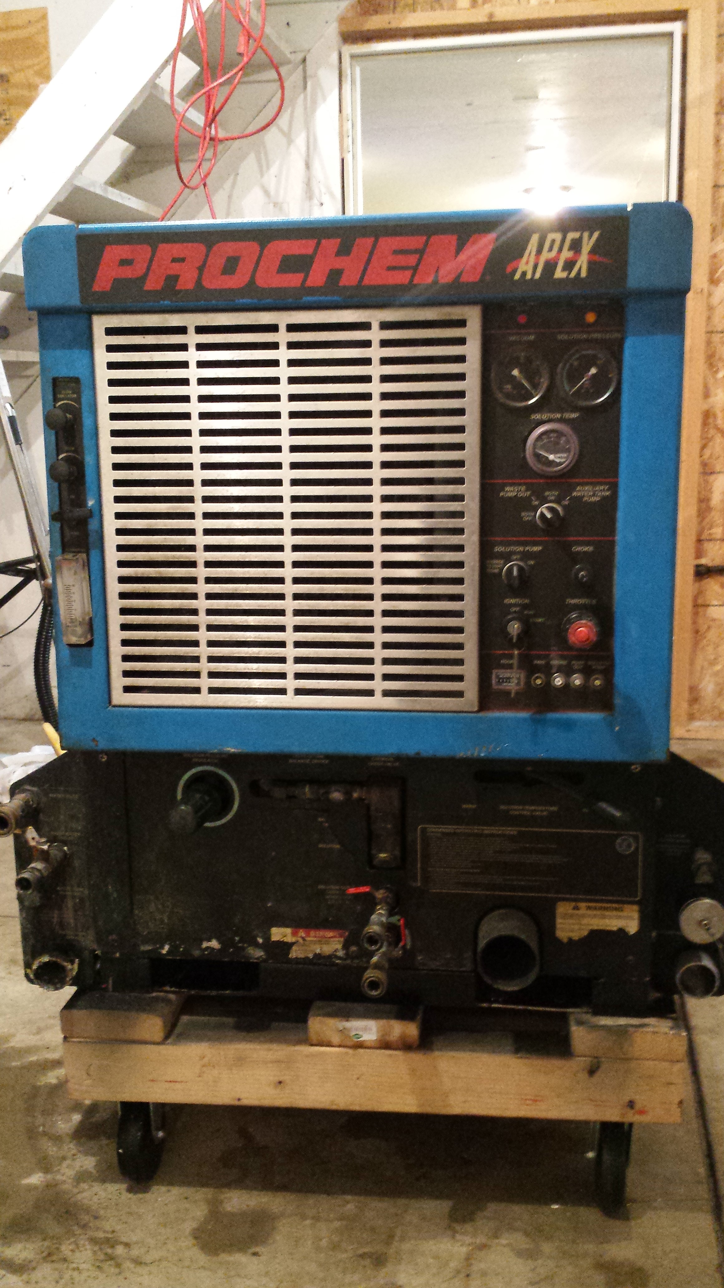

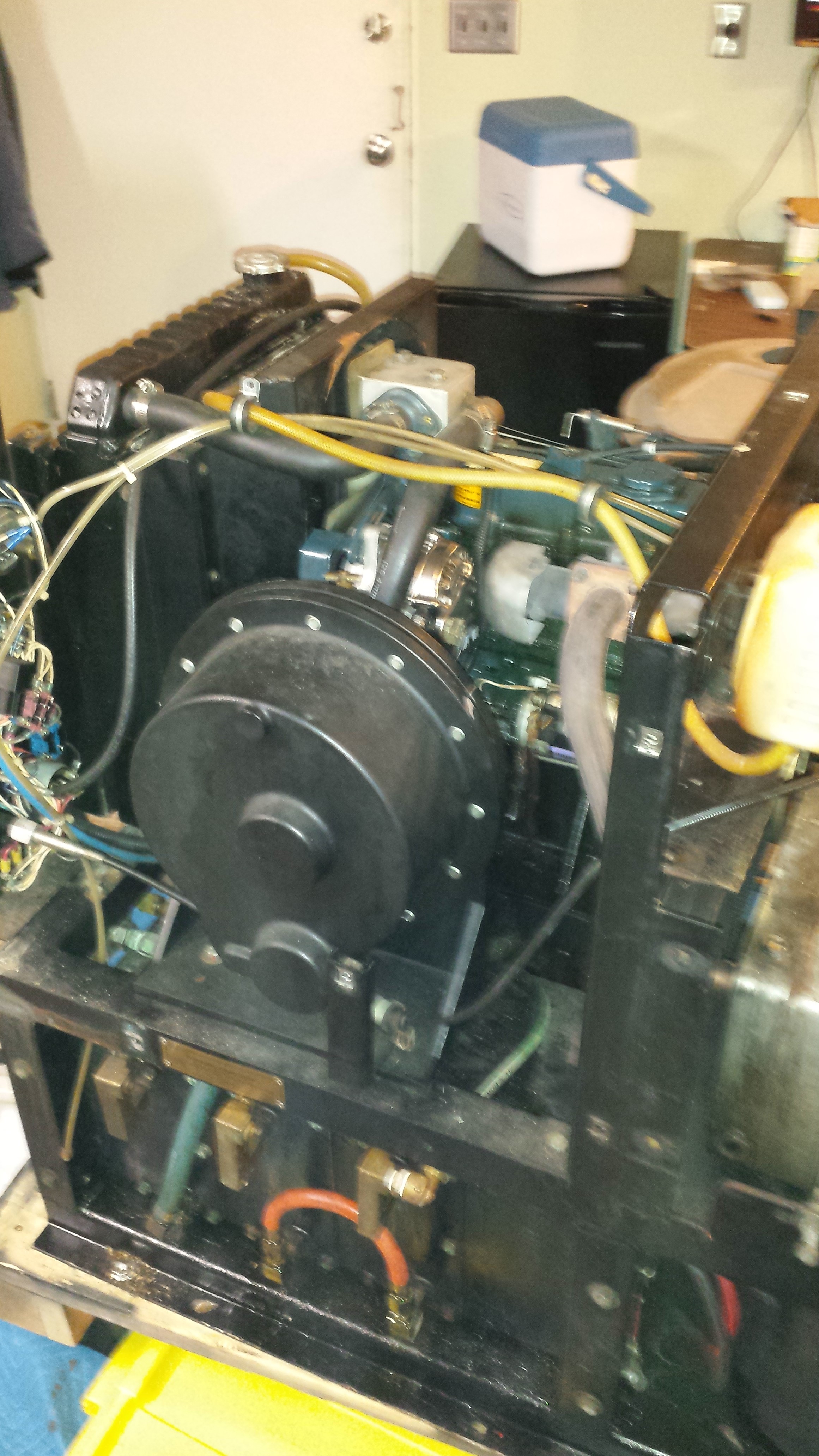

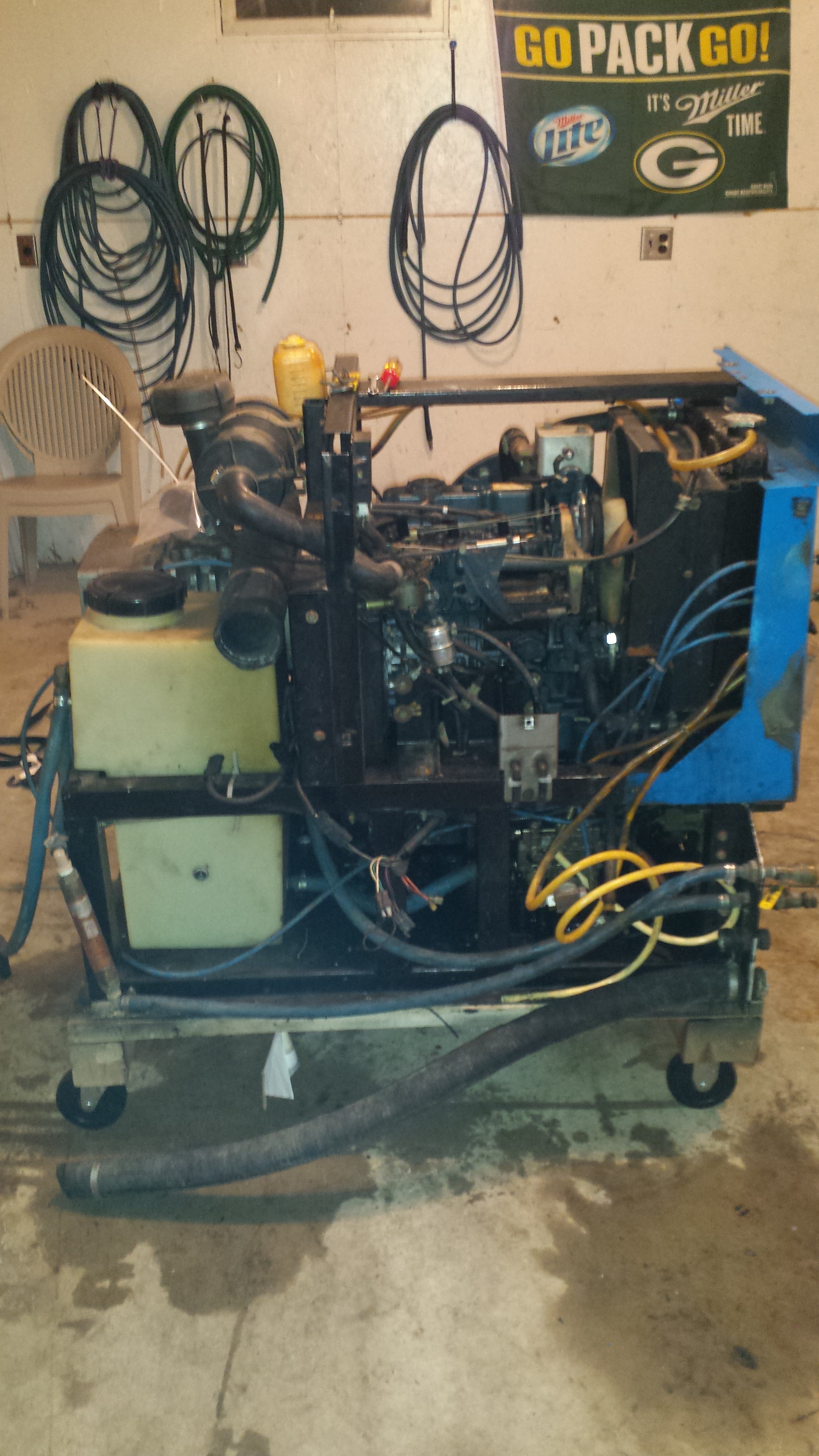

Plumbed and wired..
Reactions: EDS
A
Able 1

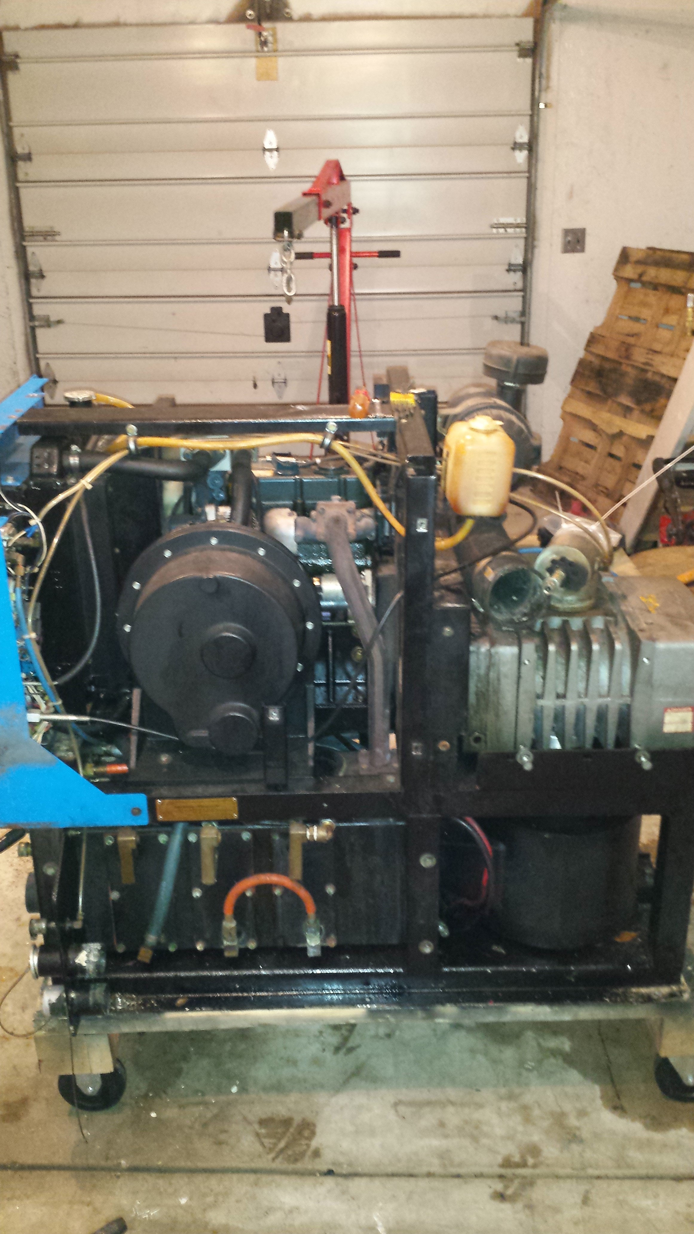

Planing to run it tonight..
I decided to go with these hood latches instead of putting the rattle clips back on..

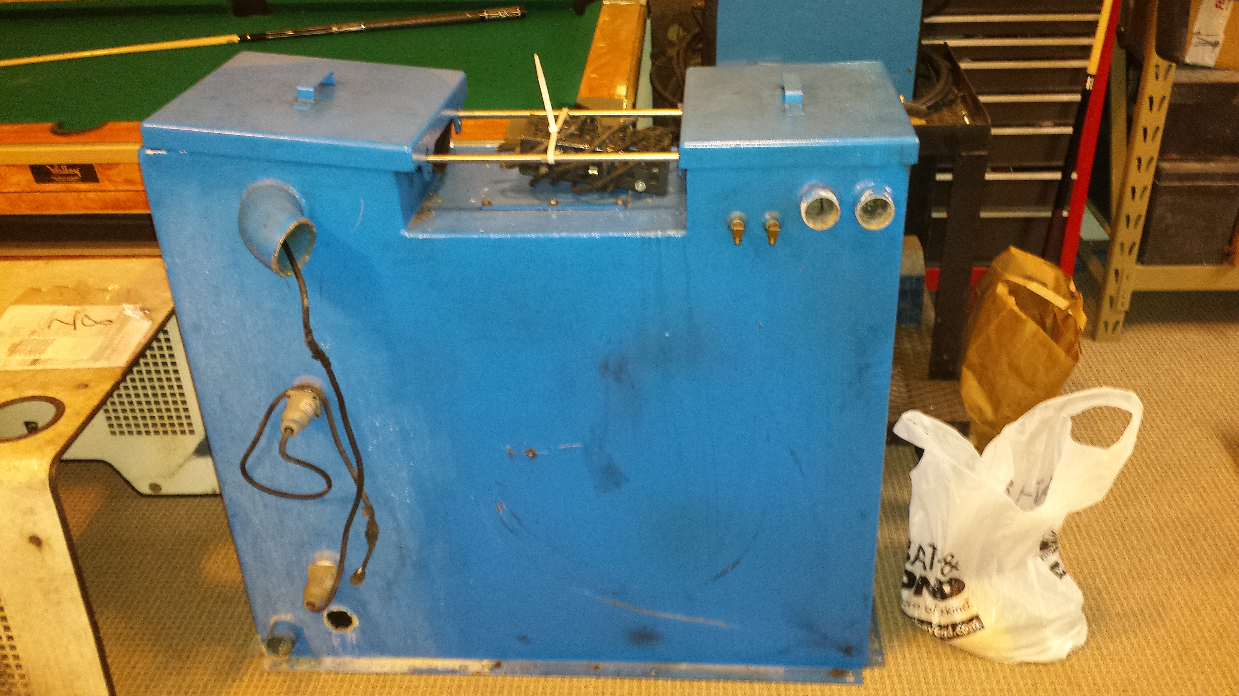

Looks good. Have you done anything with the recovery tank yet?
A
Able 1
I took it in I'm going to have the whole thing skinned with sheet aluminum.
