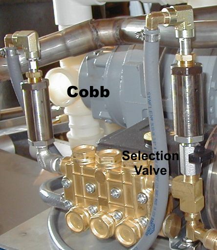

Larry is such a liar about the POS Cobb unit that I bought!
I knew if I came here I'd find him lying about it.
He says that I used an encap product that built up in my blower...LIE! I was using HIS DC encap PER THE INSTRUCTIONS ON HIS LABEL!...and my blower first failed at the 2 hour mark, and we put 1 hour on it at his shop during install...so does he really expect us to believe that in 1 hour on my first job, that there was so much encap buildup that it was able to stop a blower that was spinning at 3000 rpm's ??? TOTAL BS!
In less than 68 hours, I had 8 break downs, this is when the first blower was replaced...and those breakdowns were LONG after I quit using his encap product...it was from excess heat from a bad design. The blower is choked down from 3" inlet & exhausts to 2"...you can see the inlet pvc pipe melted so bad that it no longer was round, it was a triangle.
And as far as "me not talking to him"...that's another lie...I've got a couple dozen emails of my complaints, along with at least that many phone calls. The only reason, Larry even gave me the 85% of my money back was because of the negative publicity he was getting on ICS...because I asked him several times to buy it back, and he always said NO!
I've got all this documented with pics and emails and time-lines, because I was in the process of suing him when he finally offered to buy it back...anyone that believes his crap is a fool.
I could care less about Larry or his machine and I would never buy from him again, and I have no current beef with him especially since I'm rid of his crap machine and now have a unit that runs great ...but to come here and see him lying is not gonna cut it...
Here are just a few of the pics from his crap machine.
Bottom line is, all I did was pay cash for a machine that never worked from day 1...and it took 4 months, 13 breakdowns, negative publicity on ICS and a threatened lawsuit before I finally got 85% of my money back...but according to Larry, it's all my fault...lol, yeah, right. His machines are cheap for a reason.
I won't be back to reply again...but I was emailed about this thread and wanted to make sure that both sides would become part of the archives. Hopefully this post will remain, even though I see in Larry's profile that he is a "Mikey board supporting member"...pretty funny.

Larry Cobb
5,795
Dallas, Texas USA
Larry Cobb
ken;
Why don't you go back to ChemDry?
You would really fit in with the "sue everyone mentality"
and get that corporate legal job you really deserve !!
Your ranting & lawsuit threats on ICS had nothing to do with our buying back the TM.
You also neglected to mention that you refused to take the TM to a Sutorbilt authorized repair center for their "third party" opinion on the blower overheating issue.
ken also insisted on running the blower above the maximum vacuum limit set by the manufacturer. The blower shown above was replaced without charge to ken
Although you steadfastly refuse to believe it, there are plenty of flexible coating materials that can stop a #4 blower while it is running.
A few of our customers have done it while stripping wax with their TM and the fluorochemical you were extracting is a lot more temperature resistant than any wax.

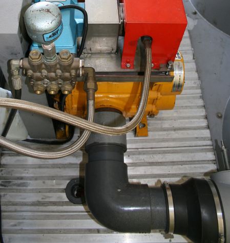

Several top quality TM's use thermoplastic in the vac intake system.
Here's a Vortex picture courtesy of Wizard that shows the plumbing quite clearly:
There is no high heat in that grey plastic plumbing.
