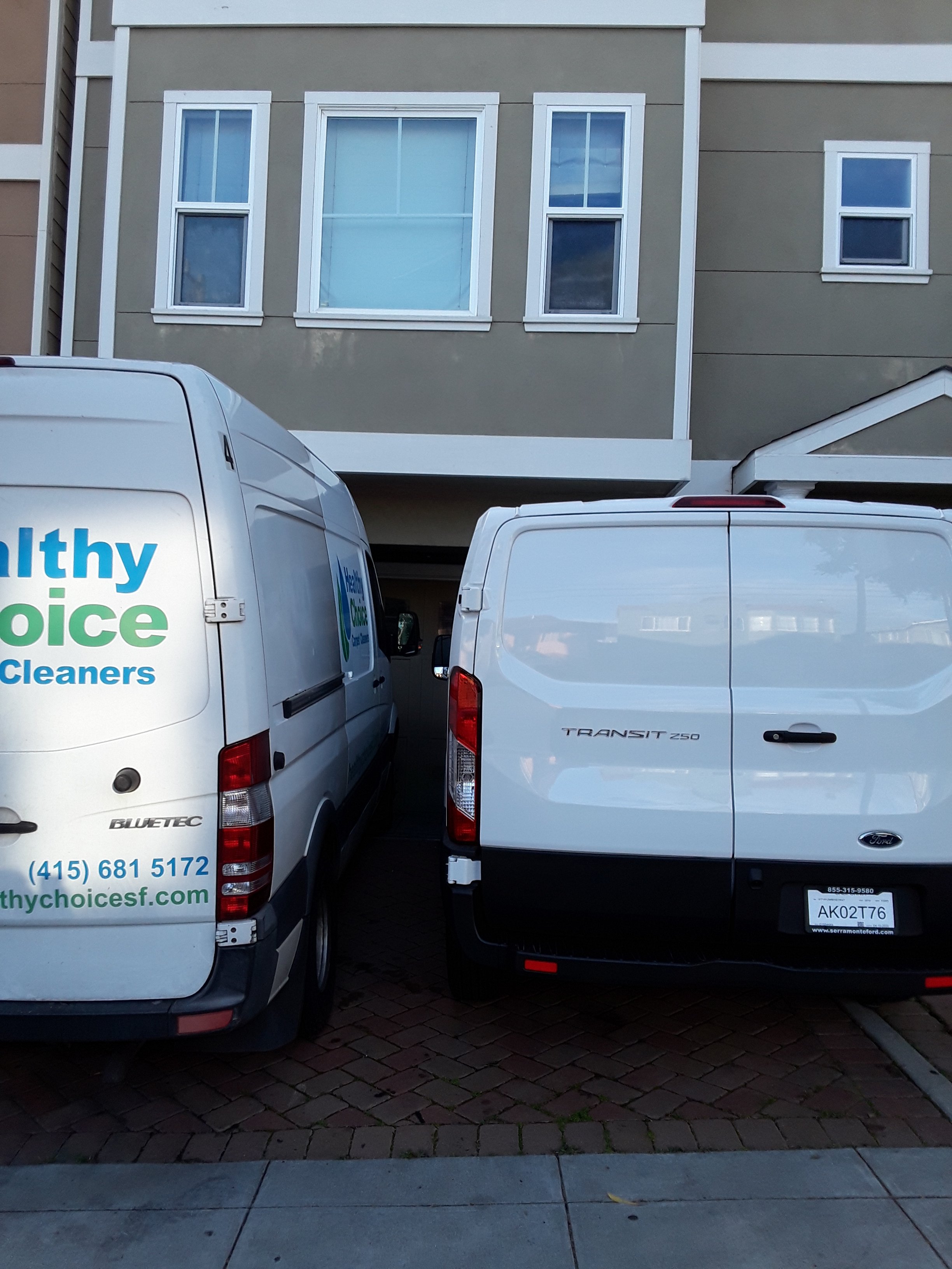

I'm replacing my 2008 Sprinter high top with a Ford Transit 250 low roof. The TM inside the 2008 Sprinter is a 5.9 blower with a 110 gallon waste tank. This waste tank is is too tall for it the transit.
I have a 2013 Sprinter high top which has
a TM with a 5.6 blower and 85 gallon waste tank. This TM"s waste tank will fit in the low top transit.
Should i just switch waste tanks? This would mean a 5.9 blower is with a 85 gallon waste tank and a 5.6 blower is with a 110 gallon waste tank;
Or just go through the hassle of doing 2 slide-in Remove and installs?

Thats not how Matt would have parked.
