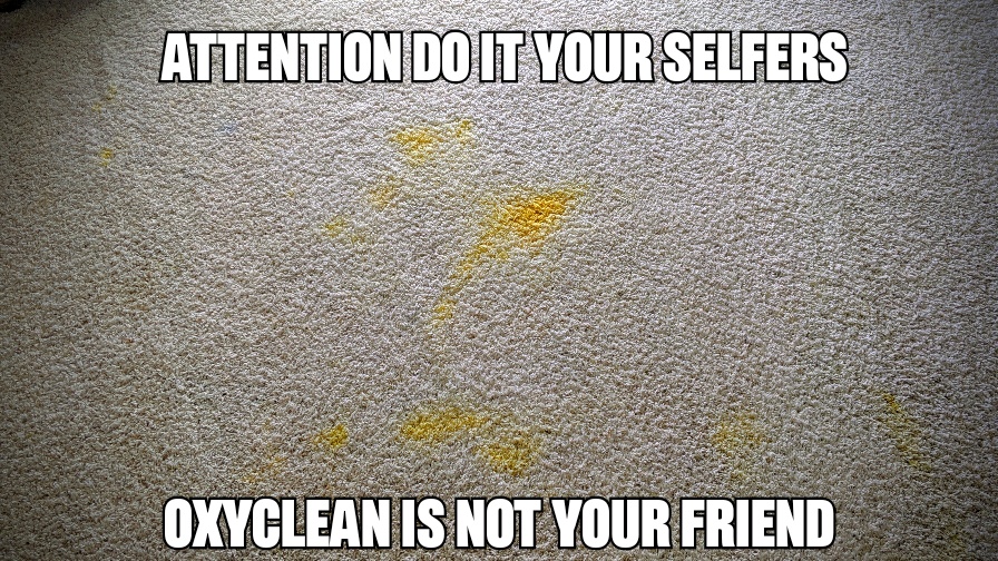

of my last carpet jobs had yellow or orange stains on Polyester that I could not get out with Oxidizers, Reducers, high pH mega sprays , 40 or Fels

Mikey, It might be a color loss problem and require a color correction. Was the carpet color a beige.
I realize you had issues with chris howe. But he can back up his shit. Maybe a little eccentric but a freaking genius when it comes to color repair.
With his color cue app. You can take a photo of the spot and determine if it's a color loss issue or if its a stain.
