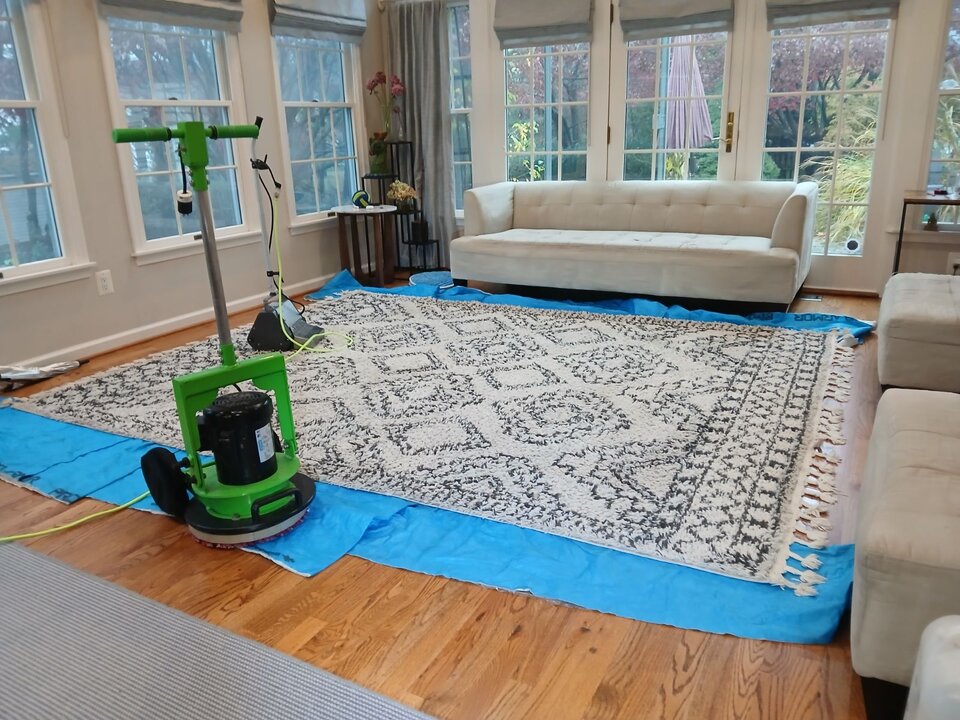

I'm using Hydrox a lot lately at my Apt Complex, on Residential Carpet, on Furniture, and Area Rugs and getting excellent results
That Area Rug was trashed. Customer wanted to see if it could be saved. Yes it was saved with Hydrox using the VLM Method and dry in 1-2 Hours
