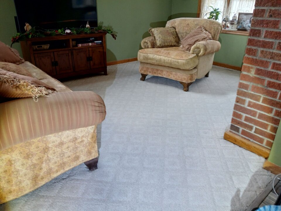

Long time customer with 25 year old Berber
Used VacAway Double Trouble with Detonator
14'' Brush Master Pro 35 CRB with Blue Brushes to scrub
TOPS Odyssey with 20'' Challenger Cotton Bonnets to extract
After drying that carpet will look even more brighter
THANK YOU VacAway
Carpet cleaning is a SIMPLE and EASY Process
Detergent Scrub Remove

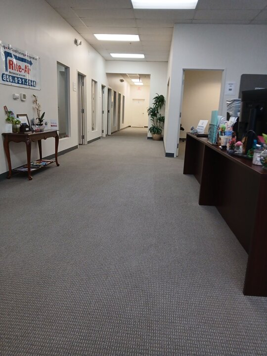

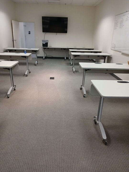

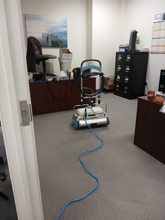

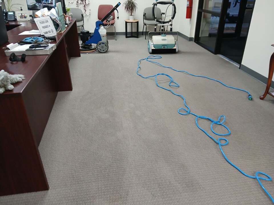

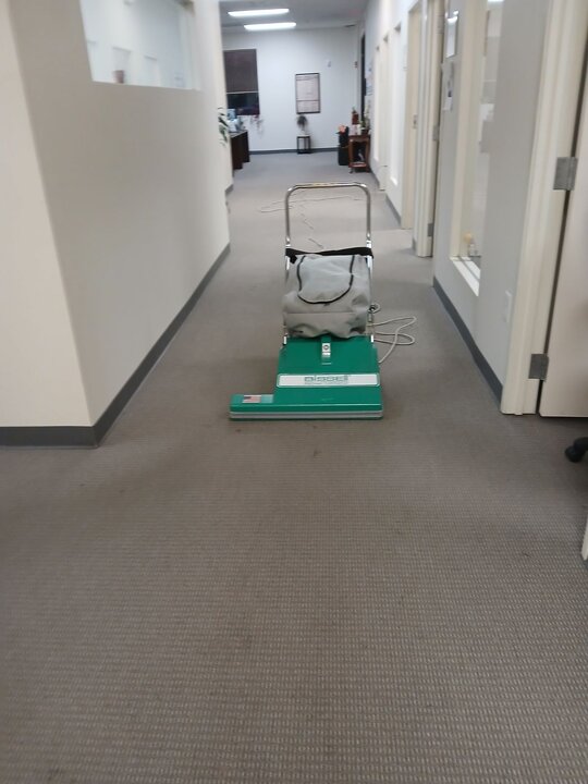

I've been doing this Business for 15 years. They used to do it every 4 months. Then they moved into a bigger building and they have been doing every six months. This time they waited for 12 months. I was starting to think they called somebody else. Maybe a Steamer but NO
It was a mess with many spots throughout especially in the back hallway where workers come from the warehouse into the office
I used Releasit Punch as a prespray in my 20'' Whittaker Trio and scrubbed thoroughly first
Then Used Releasit DS2 in my Phoenix with Microfiber Bonnets
And I used a lot of Releasit Encap Spot a crystallizing spotter with drill brush on the many many spots on the hallways and offices
Vacuumed with BIG GREEN a 28'' Bissell Big Area Vacuum for Hallways, Big Offices, Conference Rooms, and used 20'' Lindhaus Vacuum for the smaller offices and room with cubicles
It took me 6 1/2 hours but the results were BEAUTIFUL and it smelled CLEAN too
They have a lockbox outside that I use to get in so nobody is there. I love jobs like this I can take my time, there is no rush, and just do a good job
THANK YOU Excellent Supply
I love VLM !!!

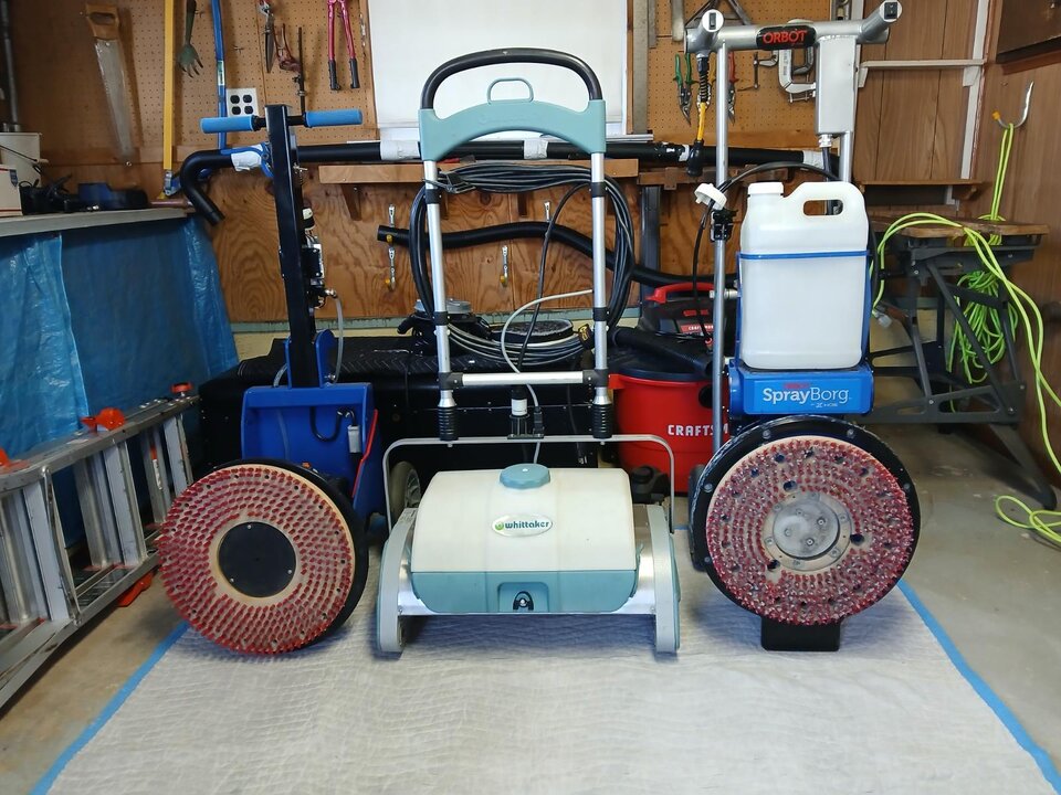

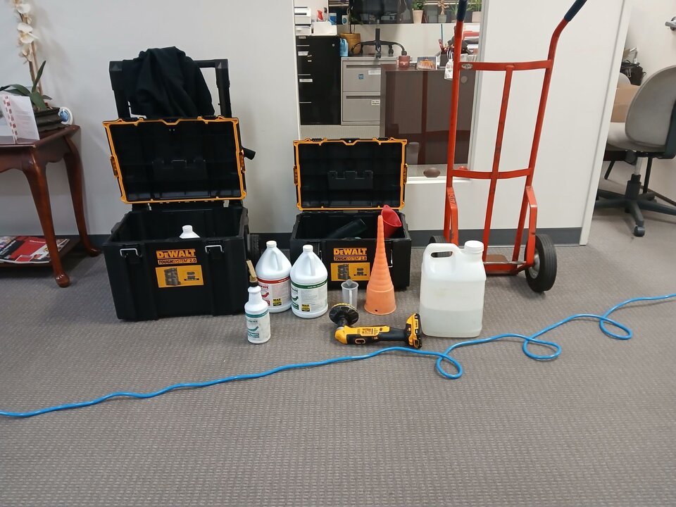

There is my equipment for cleaning CGD in Commercial Buildings
If you were to buy those 3 BEAUTIES new today the cost would be about $15,584
That's more that I paid for my first TM back in 1993
TOPS Phoenix - $4395
20'' Whittaker Trio - $5100
Orbot SprayBorg - $6089
When I bought them I paid $9032
TOPS Phoenix - $3495
20'' Whittaker Trio - $2500
Orbot SprayBorg - $3037
Trio I bought used like new off Ebay
SprayBorg was my first OP. I bought it back in 2012. I rarely use it anymore but I have it for a backup. Just in case something happens to Phoenix
I brought it Saturday just in case. I couldn't leave it in my van because it was freezing outside 25 degrees so I had to bring it in the building. Just in case
The BIG SHOTS from Corporate Office were coming on Monday so that job had to be done on Saturday. NO excuses
That's another advantage for VLM. When I was HWE I had TM problems and couldn't finish jobs. That's a horrible feeling telling customers you can't finish
Life is BETTER, using the VLM Method !!!

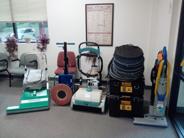

I will give it to you, if you're gonna vlm only, do it right. Where's your crb and your vacuum?
Where's my CRB
20'' Whittaker Trio is a 3 Brush CRB with a Sprayer. It's the best CRB for CGD. 75 pounds plus water weight on top of 3 brushes that sprays a fine mist in front of the 3 Brushes. It's an excellent scrubber and FAST
It's much faster than using a Fiber Pad on Phoenix and it scrubs better. All that weight on top of 3 Brushes makes it a great scrubber
28'' Bissell ( BIG GREEN ) and 20'' Lindhaus are my vacuums for CGD
I love VLM !!!

I don't have the Whittaker but I have a brush pro 15 inch. I also have the Trinity Phoenix and Sprayborg. My only issue with the Sprayborg is the switch for the pump. And the end of the day you will feel it. The trigger on the Trinity is much easier.
SteamwayPro
Apr 8, 2012
573
George
SprayBorg seems slow to me after using Phoenix and it needs the weight kit and Malish Driver to make it more aggressive and not need a glider
That's another $400 added to the already RIDICULOUS price of $6089
And getting the jug on the machine when it's full of water is troublesome. It's a very tight fit
The only issue with Phoenix is if you need to prime you gotta loosen a jet. Adding a check value solves that problem most of the time but I don't take any chances. I don't take jug off machine and don't let solution get too low or let tube run dry. I leave jug on and add solution with a funnel keeping tube in solution
28,230
I replaced the intake hose on the Phoenix as I had an air leak. I am thinking of putting a T fitting on the outgoing hose with a ball valve and bleed hose to act as a primer. For a while I had a primer bulb on the intake hose but it eventually failed.
Are you using a check valve on Phoenix
I replaced the 8001 jets with 80015 jets and even considered using 8002 for that job last Saturday
8001 just doesn't put out enough solution for filthy CGD
What size jets are you using
28,230
I'm using 95015's right now. Gives me a little wider spray. No check valve, it dribbles when you let food the trigger. I just learn to deal with it. My Sprayborg has 95002's.

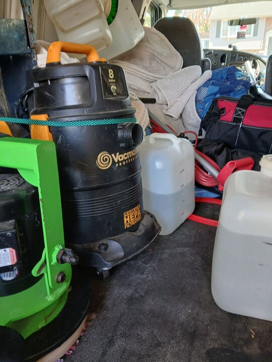

I always have a 8 gallon VacMaster on the Van just in case I run into something like that. I rarely use it but glad to have it when needed. I only used it one time this year. Yes after the Shop Vac you gotta then use a REAL vacuum like a Kirby. Shop Vac picks up all the big crap so you vacuum doesn't get clogged.
I also have a Shark Kirby and Pro Team on my van. I use the Kirby the most then Shark
I don't even know why I have that Pro Team on my Van anymore. I haven't used it for over a year. It's a good vacuum on CGD but for thick residential carpet it's disappointing. I do like the wand. It's easy to use but Shark has a wand and vacuums residential carpet better
