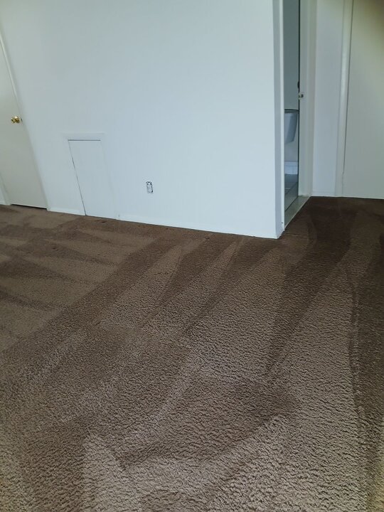

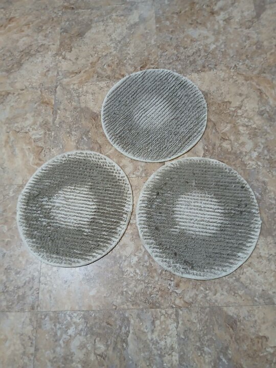

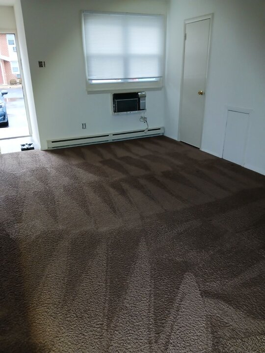

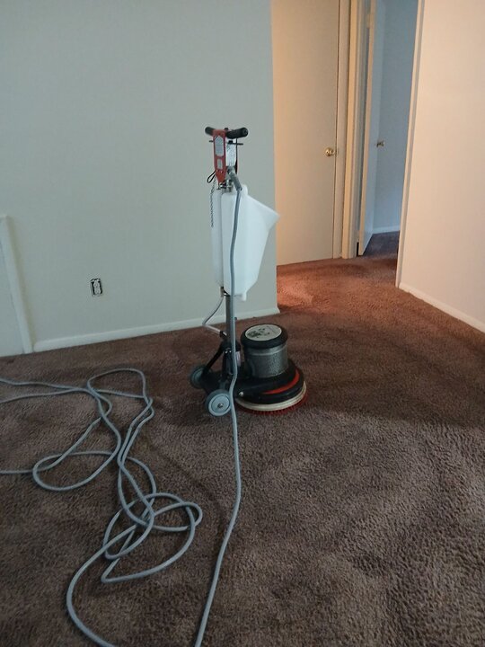

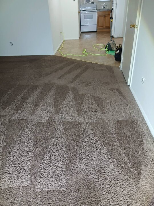

The first time using my 175-300 putting down solution from my tank was a total success
I just used 175 never used the 300
I used 14'' Red Pad on 14'' Driver to scrub and extracted with 17'' Ironman Bonnets. I used both sides of the bonnets
10'' CRB to groom
I used 5 oz of Carpet Details No Peroxide
I love VLM !!!
10'' CRB to groom
I love VLM !!!
View attachment 133509View attachment 133510
View attachment 133511View attachment 133512
WOW!!!
Look at those pads!!!
But where does the dirt go????????? LOL

Carpet details is not a true encap as far as I know. Has no polymers. You should try Saiger's code red of encap. It's a liquid, easy to use, has a good amount of peroxide already, acidic in nature which makes it great for fine fabrics as well.
I was going to use Releasit or VacAway but I thought I might put down too much solution which would make the carpet stiff
Turns out I used less with the tank than I usually do spraying it with my WORX
Still never tried Saiger's
Carpet Details dries to a powder

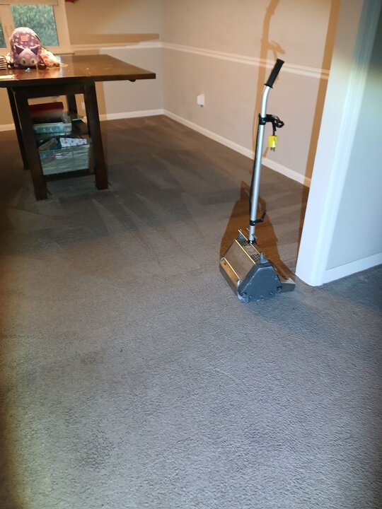

love my Ironmans, I have small ones I use under a Stepson as well.

I use a Stepson on steps too
What encaps do you use
I am mainly HWE but I like Scots , usually when doing commercial type , I have some of Bonnet Pro stuff,
quite some time ago, was getting Rick's stuff, but I don't do enough to warrant ordering , shipping.

George,
We have, been doing it all wrong?
We need to flood the carpet!
Soak it really well!
And then put 10 or 12 DRY STROKES on it?
I think I finally GET IT!!!!!
I see the Light!!!!!!!!!!!!!
Yea another HWE Guy that's ANGRY
It's not about Corn Rows
They HATE learning the TRUTH about VLM
And SEEING the TRUTH
I warned the HWE Guys that have BLOOD PRESSURE issues to ignore this thread
I love VLM !!!

I'm just speaking the truth! Vlm has its place, and obviously I use it, a LOT! It can not be a one trick pony! By the way, a square scrub tool is the cats ass, although I don't use the Square Scrub brand because of weight for removing finish off of vct with spp pads. Merry Christmas 😀
Some people on this thread can only afford to have one horse?
The horse that can do it all is the 175!!!
Not only can it do it all
It can do it very well............................. Just slower in some cases?
