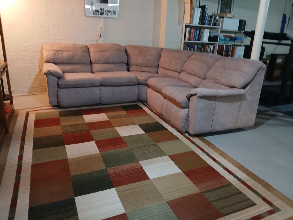

Frank do you clean furniture ???
Did VLM on a Sectional Sofa and Area Rug today
That is a old Sofa down in the Basement
VacAway Double Trouble on Sofa and Area Rug

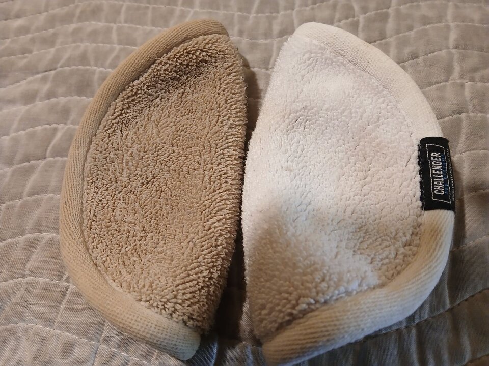

I used 15 Challenger 8'' Bonnets to clean that Sofa
Once you go VLM, you NEVER go back to HWE !!!

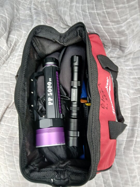

Cat odor job tomorrow
She said she can smell something but no stains. I'm hoping it's not cat urine
I made NO promises
I think Black Lights are overrated. I have them but you can't trust them
I'm getting good results with Just Gone on dog odor so I'm using it again tomorrow for cat odor

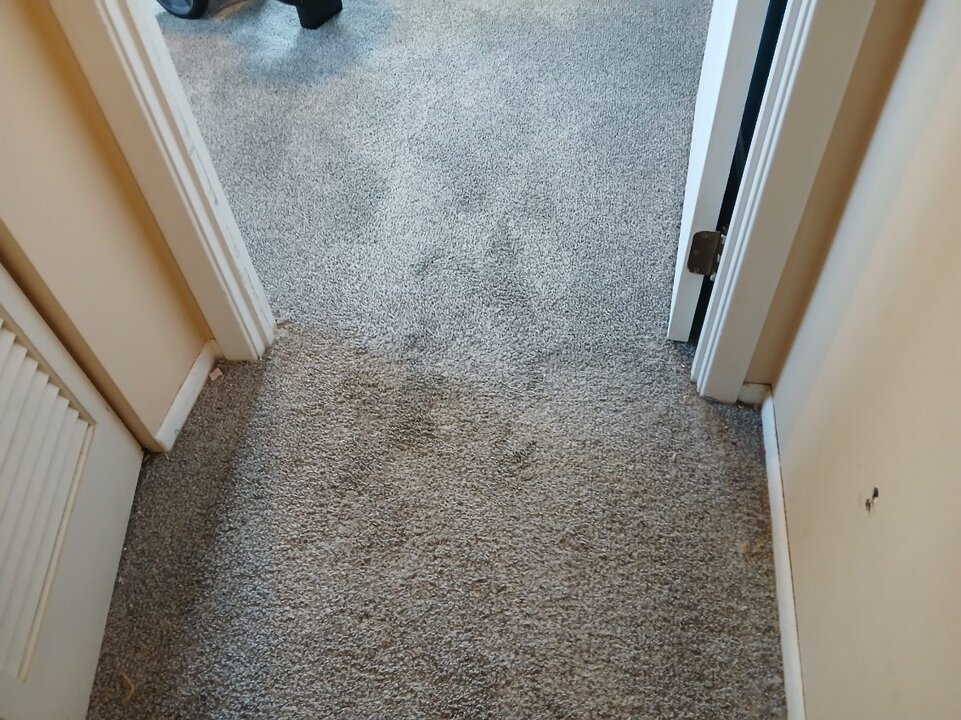

Cat odor job done. As soon as I went in the house I could smell something but it wasn't cat odor. The whole house STUNK
The House was a mess. Steps going upstairs looked like they hadn't been vacuumed in 10 years
I couldn't smell any pet odor in the two Bedrooms and I couldn't find any pet stains
That's a picture looking from the Hall into the Bedroom after I cleaned Bedroom. Hall was brown from dirt
You can see Vibe at the top of the picture. I used 4 weights on each side this time adding 32 pounds of head weight with Old Thick Light Blue Microfiber Bonnets
Used all VacAway. Odor Death x2, Lemon Smart Scents, and Double Trouble
I love VLM !!!
