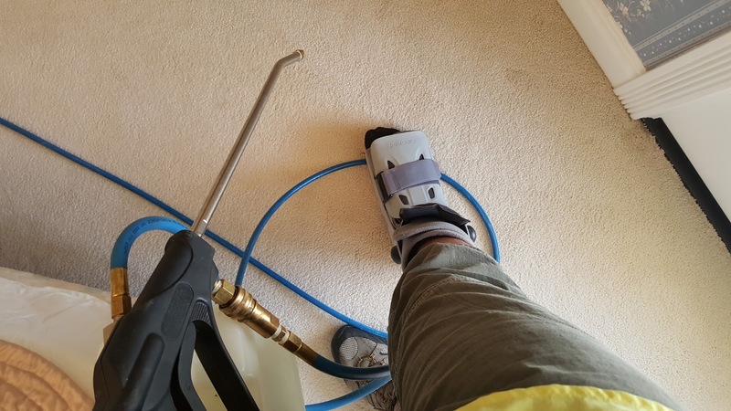

I'm no @Mark Saiger , more of a @Mikey P with a broken foot cleaner...
I'm no poser..
odYl8rB2-tsnbmOSWvcJQkmqqer0q7VgY459Ep21UNodynhrH4HkMKF1_EicxKTC36QtLH-tRtf2o5xJS9=w1699-h955-no.jpg
there's my Aron..
iIFLwaZP7HhT0OlSyKM4tAIs06D331BCQb4bD_BmAf1yggXkRpCNAXg8At1xAiyL9RYIqqWB8_Dsi5fvHfW=w538-h955-no.jpg
9,552
Hawaii
I was just pointing out that I'm by no means a fast cleaner.... Ron is more of a rug washer as I consider myself also.... I do clean and move pretty slow on jobs... A lot of you guys would probably lap me.... I really don't know how Saiger does it, with vacuuming, tabbing & moving furniture, pre spraying, scrubbing, extracting and still able to get 7-14 jobs done in a day... I'm lucky if I do 3 jobs...:shifty:
