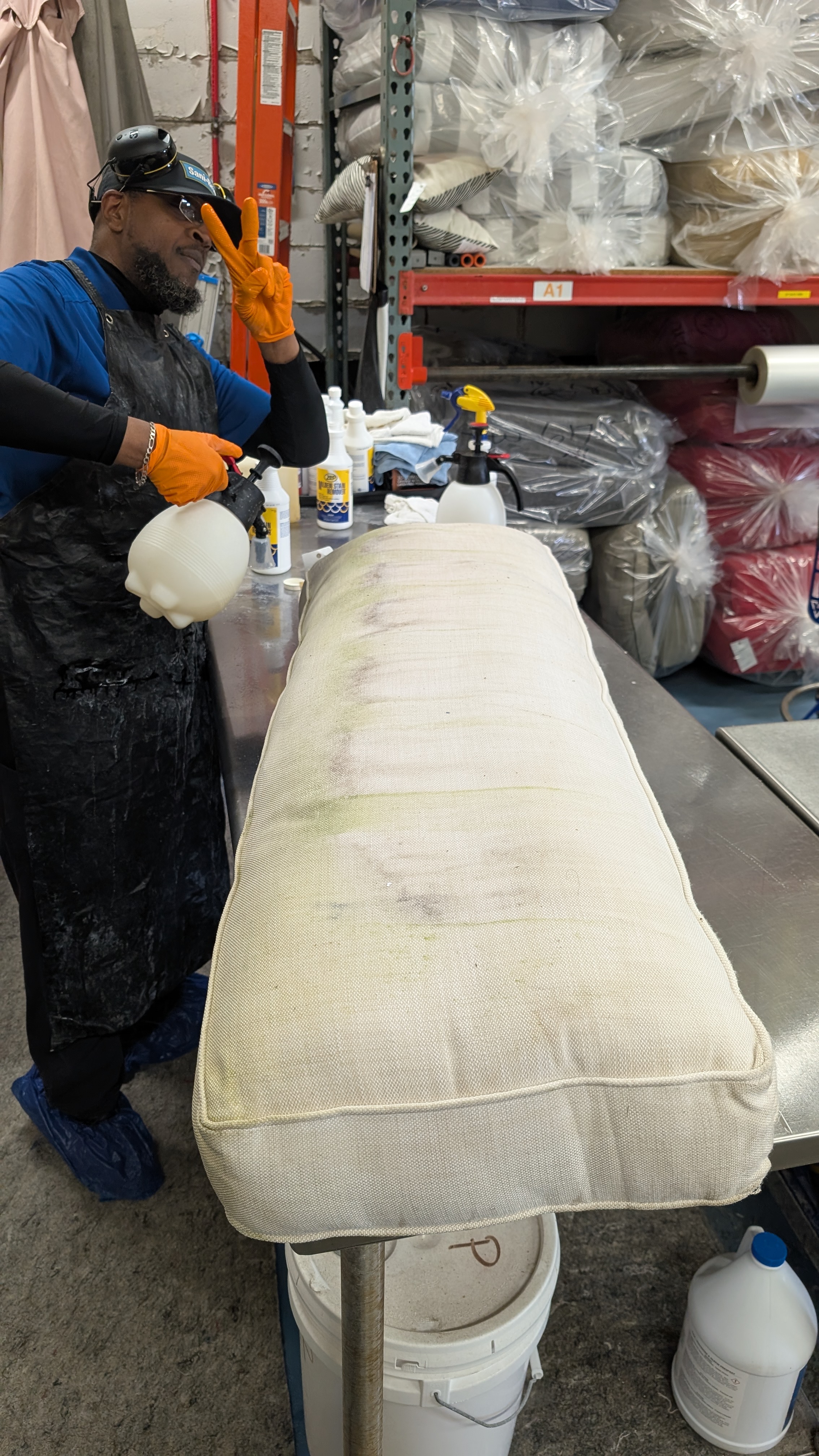

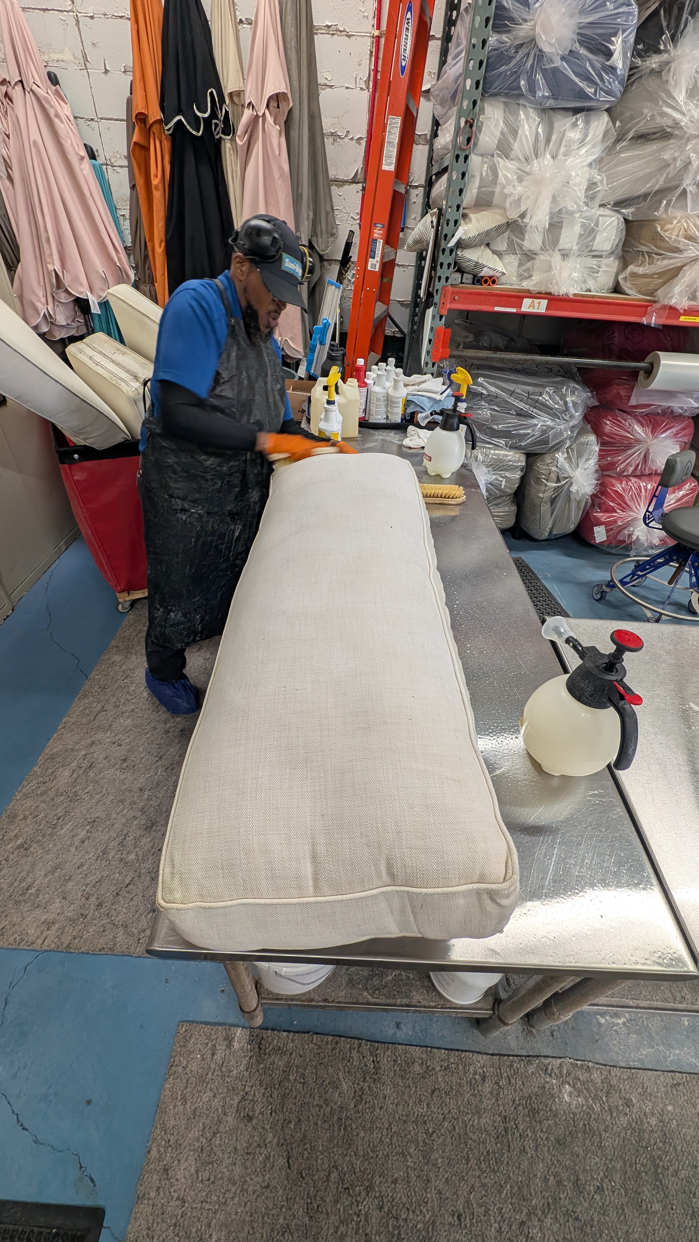

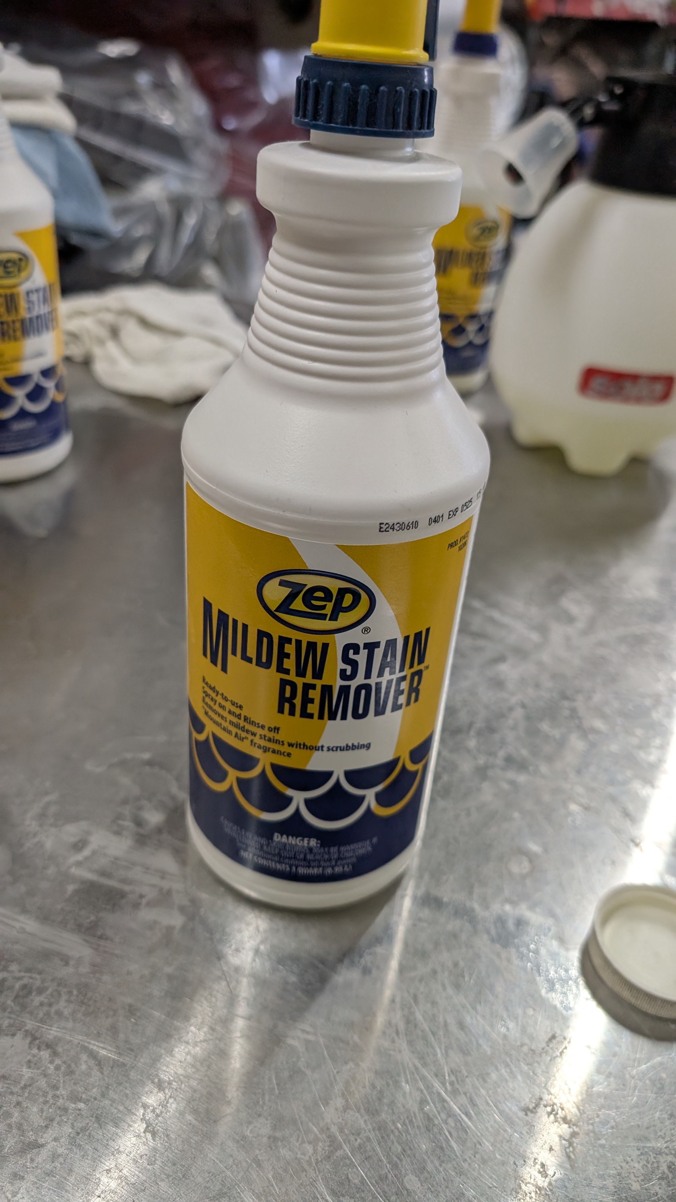

Zep mildew stain remover. Miracle in a can
115,883
Pre vacuum
Pre rinse
Apply enzyme cleaner
Rinse
Apply Zep
scrub
Dwell
Rinse
Repeat Zep if needed
Rinse
Dry
PXL_20250122_201213361.jpgPXL_20250122_201204045.jpgPXL_20250122_201646809.jpgPXL_20250122_201822807.jpg

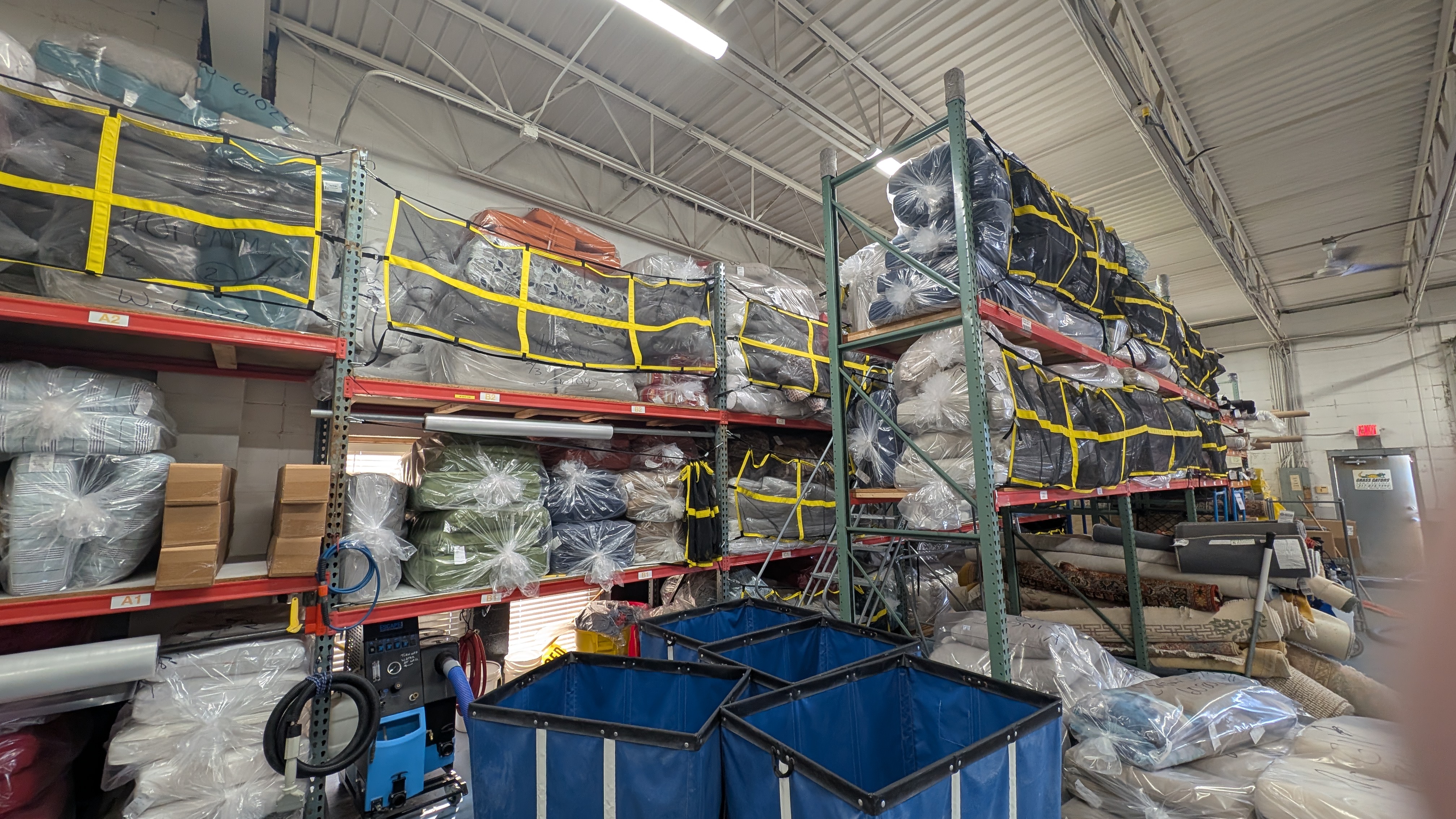

Sani-Bright does a ton of patio furniture
12,555
This is a growing field, and it seems a number of plants are embracing this.
I'm not surprised to see Sani-Bright at the head of this in their region. I'm really glad the King family has been doing so much to help out with the RMHC event in Indianapolis too. Jordan and Tom are good people.
I remember Joe Appleby first telling us about him doing that back when I did the class at his place years back.
Was it 2016-2017 by chance?
I was there, I enjoyed the advanced course very much.
Joe’s shop was FULL of patio cushions (stuffed to the rafters, in every corner), he was doing a clean n winter storage system???
We had pizza for lunch, and they had to special order food for Mike…. You know, the vegan thing 🙄

And is that Zep a chlorine or peroxide based mildew chemical?
