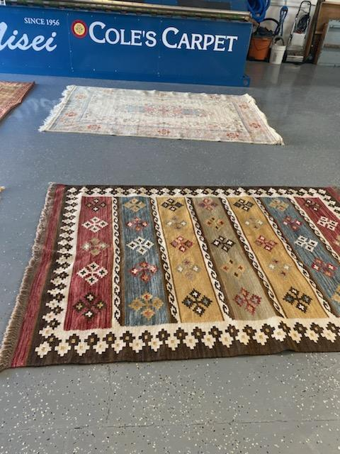

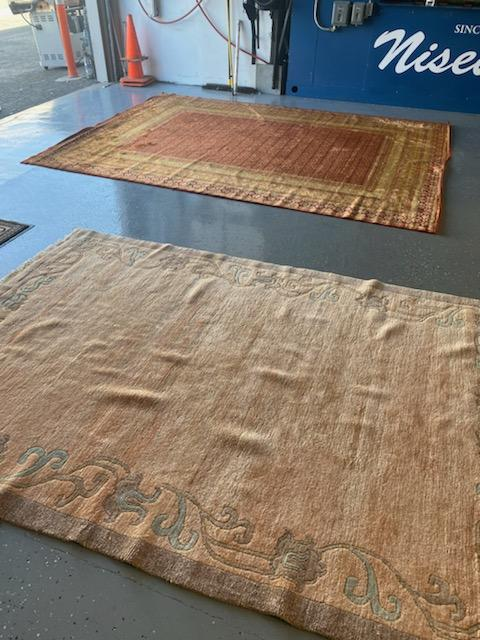

red one in back is 100% Viscose
tan in front is wool...
all wool..
Olefin
demo rugs for the Vegas MF IICRC class...
OP and CRB/compound on all of them...

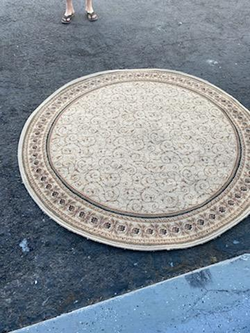

The round one can be cleaned in the driveway. CRB and dirt swirling will actually take longer than extracting, so why not do a better job of cleaning?

You don't want to use picrin in someone's home. Stink them right out.Hit them all but the olefin with Picrin. Dry right away with no bleeding or other issues.
