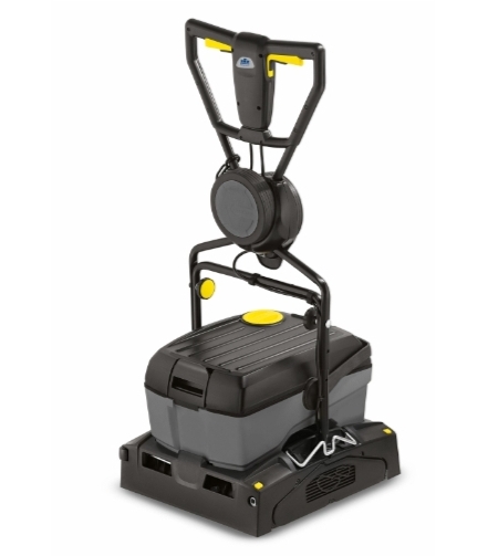

I had the karcher branded version of this Br 40/10? seen them as windsors as well.
It did an ok job but looked the berrys, I didn't do enough to keep it... sold it to my brother for $100 more than I paid because I care
he's used it less

its too big for residential its for malls supermarkets etc... you'll have tourettes before you get it inside

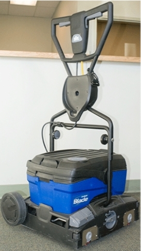

demo a karcher if you like grey
or a windsor if like blue..
..or use your TM after a 175 or crb scrub
