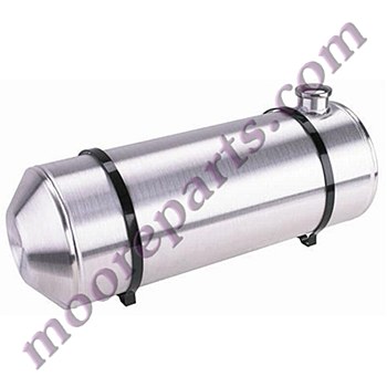

Mounting the tanks on the tongue is the way we do it here. We use Spun Aluminum tanks. A little welding and they mount up easy.

Marine Tank? These are what we use

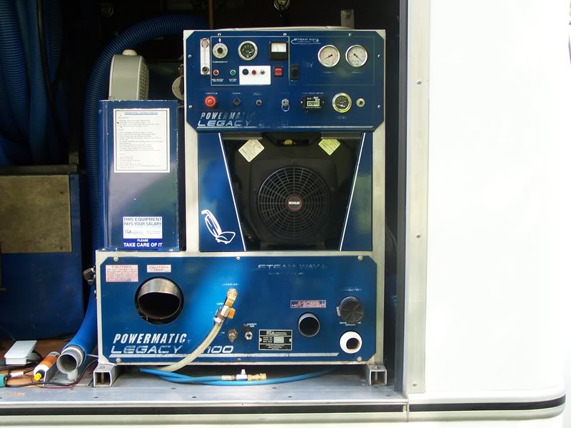

My box truck is a 6 x 10. I have my Powermatic, reels, shelves, really all kinds of things in there.
For many years I used the marine tanks that come with the Powermatic for both gas and kerosene. My son in law still uses this system inside his truck.
