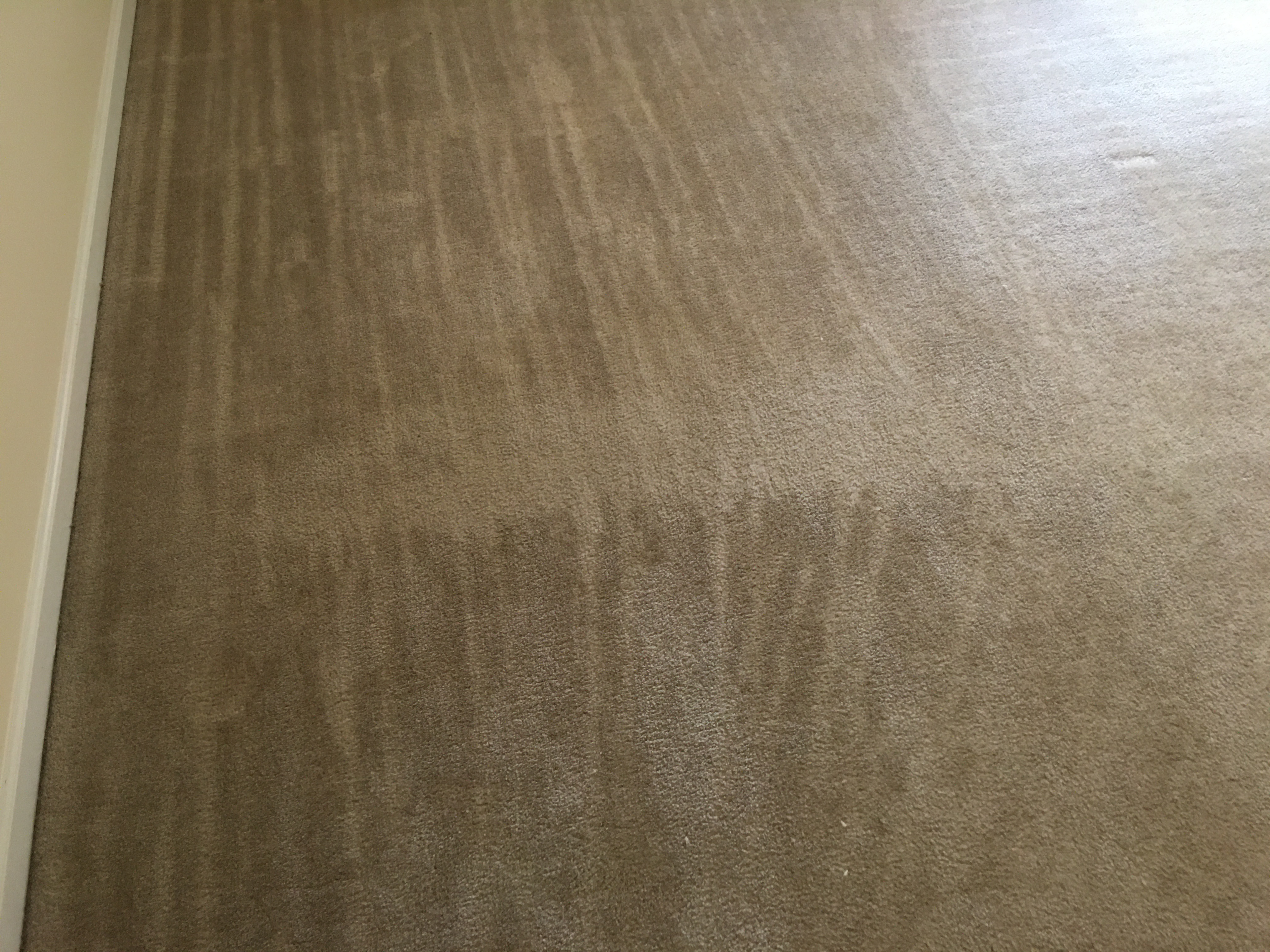

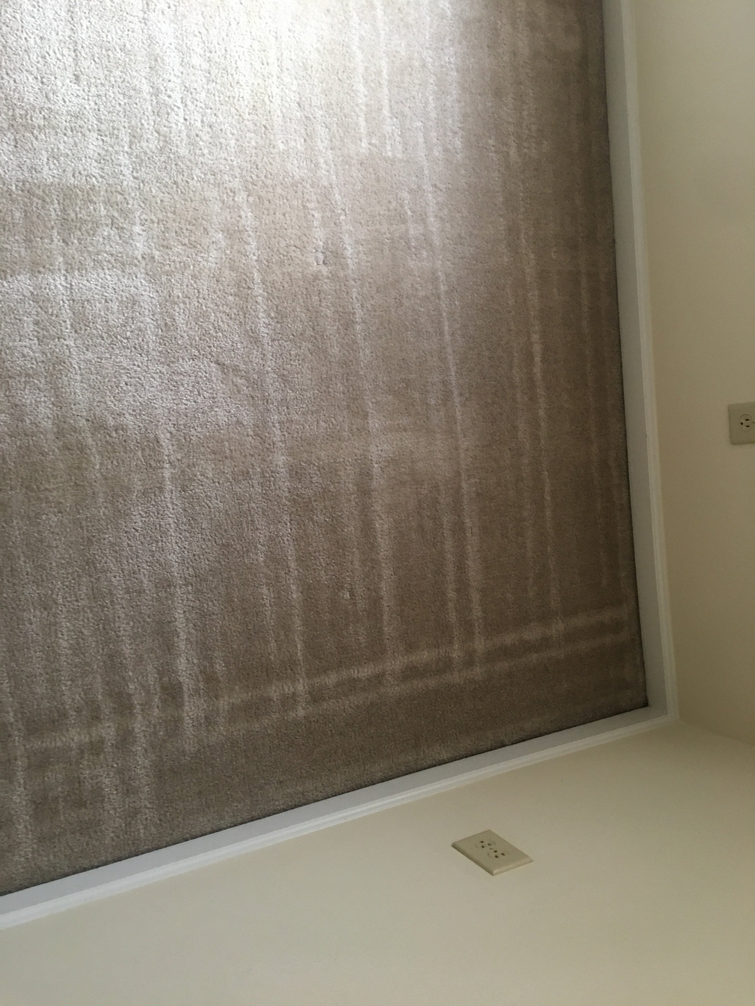

A ignorant lazy tech with a truckmount and wand/RE
Or a ignorant lazy tech with a 175/OP?
List how many ways that both can cause damage and youll see one list will be much longer than tne other.
14,493
Idiot tech with a tm and wand.

I think either method can produce equally damaging results, just in different ways.
HWE- carpet left to wet. Mold, mildew, bacteria.
VLM- tip bloom and other friction related damage.
Which one would be easier to fix when a complaint comes in? What percentage of screw ups are so bad replacement comes up?
Reactions: Jim Pemberton
116,968
Hot water extraction can cause just as much texture damage through worn or misaligned jets rotary extractors with their Jets too close or into the pile, aggressive brush heads etc
Not to mention Marty's favorite cornrowing that happens from CRBing but that can be either method
