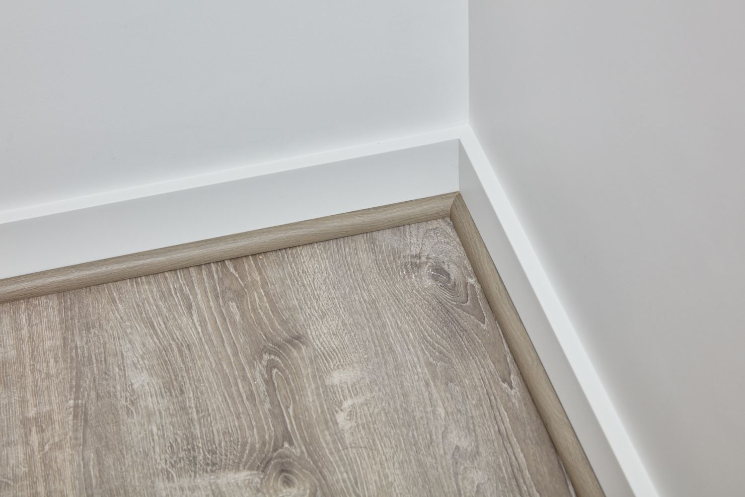

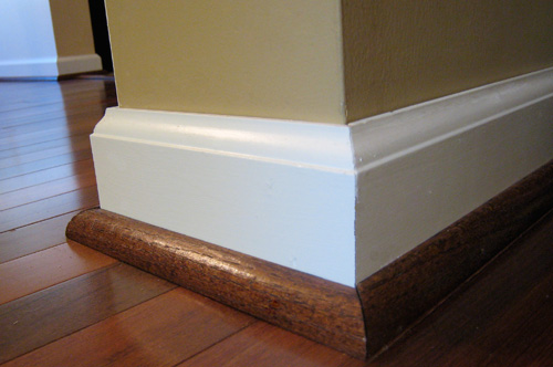

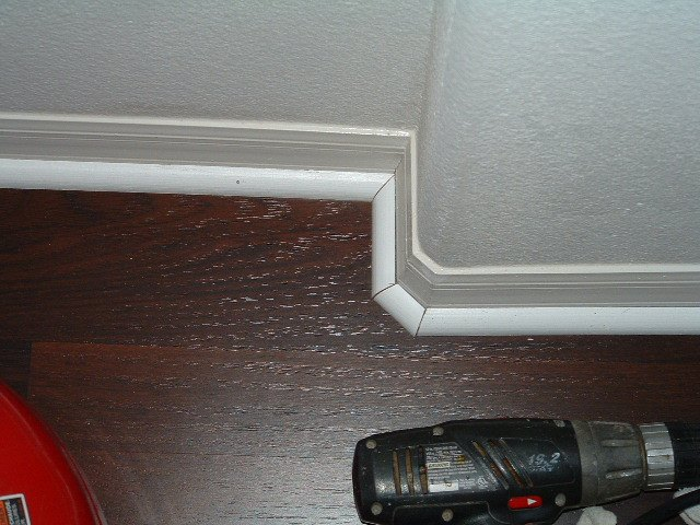

I'd pick at quarter-round as well, even though no one walks that close to the wall. Thin shoe molding is the cleaner answer.

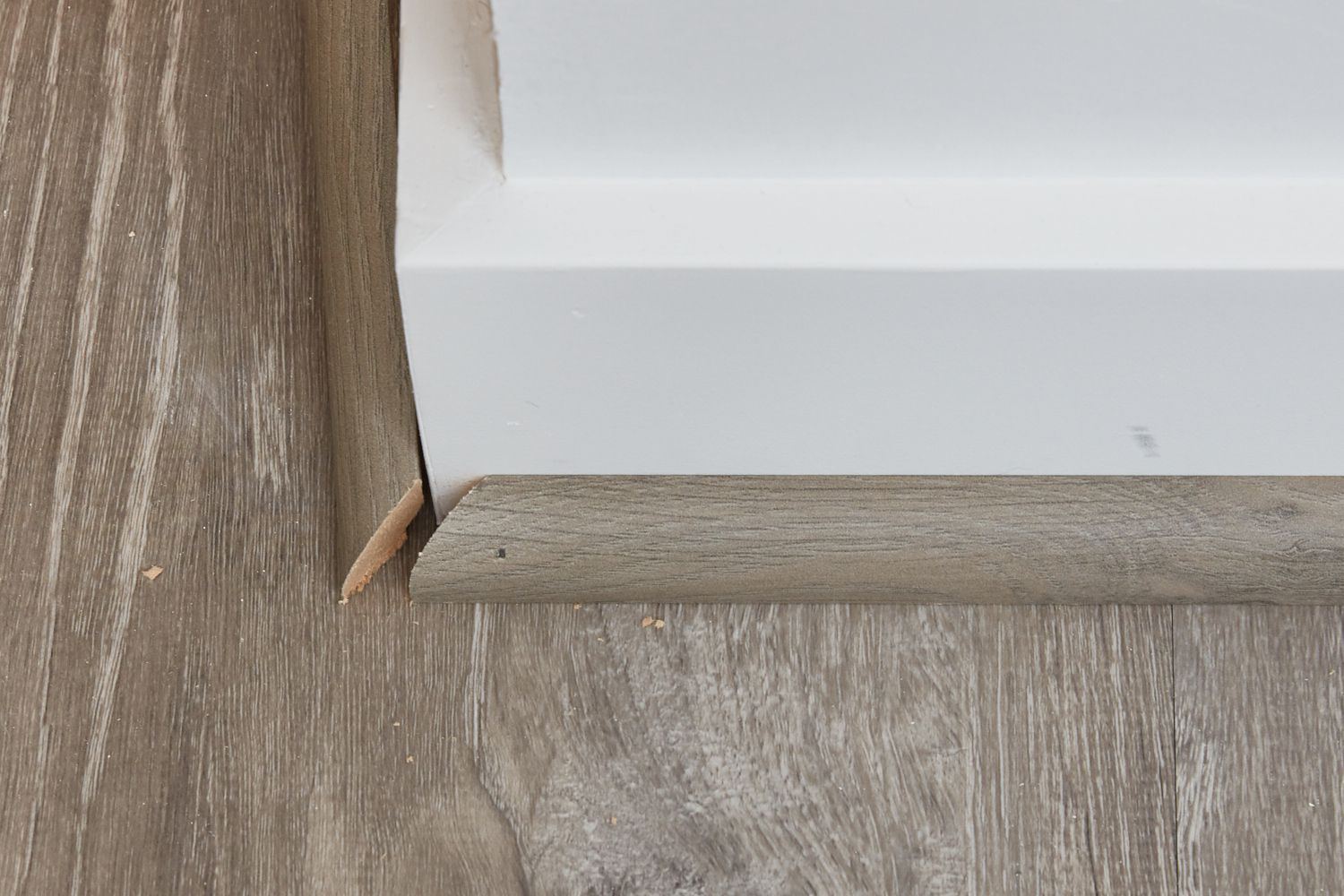

Example of what Larry's talking about. Carpet on pad gets pulled and replaced with carpet tile, leaving a big gap. Moving the baseboard down creates a lot of work to clean up the wall, so much work that it would be better to just buy taller molding to cover the gap and the caulk line.
This is shoe molding where a damaged wood floor was pulled and replaced with vinyl. The same gap problem solved pretty cleanly. In this case the previous floating wood floor hid the uneven subfloor, while the vinyl made it obvious. The thinner shoe molding is flexible enough to bend and make the uneven floor less apparent.
