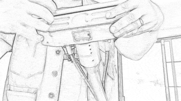

Lets start with the ability to quickly convert your familiar, high performance, high velocity carpet wand from carpet to (all) hard surface such as tile, stone, wood, VCT, LVP, concrete etc.
While its certainly no replacement for a “Spinner” tool on heavily soiled floors, it’s easier to use, cleans closer to the edge, gets under and around furniture and fixtures better and is safer to use on delicate coated surfaces, especially 6 mil wear layer LVP.
Compared to a standard “hard surface wand”, by converting your favorite carpet cleaning wand you’ll get better recovery, more friendly ergonomics, a much better swivel if so equipped, better/safer edge cleaning and no need to carry a second wand.
Most maintained hard surface floors can be easily cleaned by sweeping, mopping down your favorite pre-spray, allowing some dwell time, possibly adding some hand or mechanical scrubbing in high traffic areas and a quick rinse with your GBG equipped wand. An easy and welcomed upsell in homes with carpet just in the bedrooms, which is more and more common these days.
GBG’s will be available for both Devastator wands, both Sapphire Titanium wands, the Prochem Titanium and hopefully the HydraMaster Evolutions and the AW29 (not yet tested). All but the internal fit Sapphire’s will feature a set screw for those that want to keep the GBG on permanently. The Prochem Titanium and Devastators wand can have a notched cut into the splash “wing” to allow for easier and safer swapping out of both Glides.
Price yet to be determined but look for show specials a both The Experience and Mikey’s Fest this year.
Devastators will be available real soon with the ability to pre-pay starting next week.
