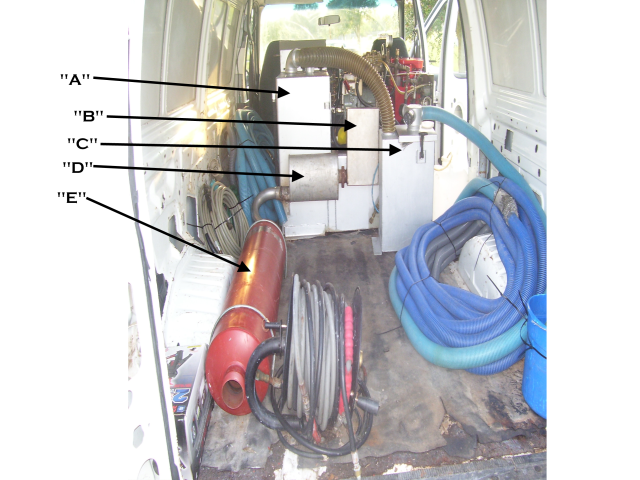

What are these parts:
lesterj2
Aug 17, 2008
444
Re: Quick Explanation if Possible
Mikey P said:
A -Waste tank
B-Water Box
C-Filter Box
D- Muffler
E-Silencer
ok thanks for the input... but if possible could you tell me the functions of each piece of equipment...

Can't tell, but looking at the other pics, not sure if "B" is a water box or not.
WISE
lesterj2
Aug 17, 2008
444
SRI Cleaning said:
B is the blower heat exchanger
so what is the purpose of the heat exchanger...
im thinking its like a mounted water heater, correct me if im wrong... :?
SRI Cleaning
May 4, 2007
1,131
West Chester, PA
Anthony Firmani
Yes, there are 2 of them. They take heat and use it to heat the water. The one in the picture is on the outlet of the blower. As the blower is running it creates heat. the exchanger captures that heat and uses it to heat the water. There should be one on the other side of the machine. This one has the engines exhaust running throught it and it heats the water even more. The one in the picture hangs off the side of the machine, the other one should be right behind the motor and it probably has a bunch of sensors and wires coming out of the top of it.
here is a pic of the other one...
and its connected to the muffler in the bottom pic in the bottom right corner...

Mikey P said:
Lester
How do you know the machine produces hot water when you don't have a wand yet?
on the machine where it has the connection for a 2nd wand the valve is sticking... I didnt know so I took off the quick release cap to my pressure hose and it shot hot water on me & mechanic... LOL

i think this is a pic of the pump gauge in the bottom pic... correct me if im wrong...
Lester, the circled area - that's your pressure adjustment for your solution line. Adjust it with the pump working and the trigger on.
lesterj2
Aug 17, 2008
444
so i should fill my 5 gal jug with straight water and adjust the cap while squeezing the trigger on the wand...
if so will it show the pressure on the gauge...
Bob Foster
8,870
Lester the solution line has to be hooked up to the wand and just shoot the wand on the ground. Make sure the water is hooked up and on or the water tank is full before you run the pressure line (trigger the wand).
gotcha... but before pulling trigger should i leave the valve adjuster where it is -or- close it all the way then open it back up slowly until i reach 300-400 psi...
I would say close it just in case someone has it turned all the way on and you bust your valve on the wand.
