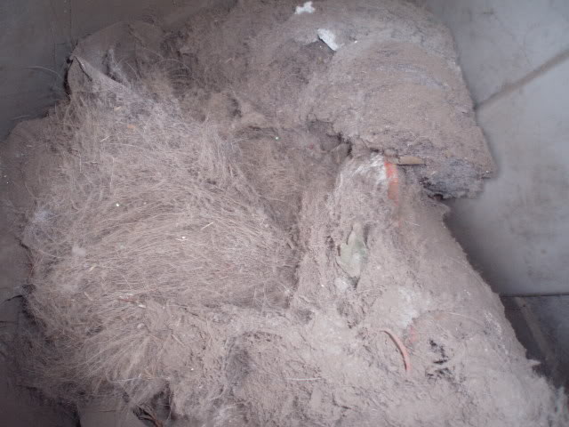

yeah that's a great idea. :roll:
I absolutely hate that excuse for low priced induced laziness.
This ladies carpet "looked" fine. Stanley or Snow would have jumped right into it with both jets a soaking.
Us?
We new better and filled our Bissell and Sanitaire 6 TIMES!!
lr dr mbr and 2 set or steps.
and 4 dogs.

I probably would have been compelled to vacuum that carpet also just because of the holed glide I use but that crap would have gone into the filter boxes on the SS or Hagopian trucks as it did for me when I ran an unglided wand. And if the carpet was urine soaked to boot, I too would have taken off the glide and cleaned w/o vacuuming so as to not trash my Sanitare. In the end it makes no difference which machine picks up the crap except in perception. (and cost).
115,883
Art that is just the fluff, you cant see the pounds of fine dirt.
If you think a TM will get all that dirt out, you're grossly mistaken.

It seems hard to believe that a truck mount with a huge vacuum blower wouldn't be able to pull out the fine soil that a vacuum cleaner can with it's teeny tiny vacuum motor. In any event the job always looks the same when compleated either way.

Look at it from another angle........If you did not vacuum this up...and your machine has the balls to pick it up while you are cleaning.....before you are half way done your filters are blocked the performance of your machine has been restricted and everything starts to drop from that point..vacuum...dry times...etc
