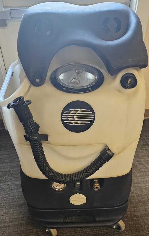

Any reason I can't do wax removal with my portable and Mikey's Hard Surface wand? Other than wax in the waste tank, what's to worry?

Should work fine except for the wax build up in the tank and hoses. I have an old portable that I use for that. I clean out the tank and hoses with stripper. I don't know if I would want to do it with a nice machine.

I'm always broke, and I actually already have a couple of those shop vacs and they are a pain in the ass to dump, when you run them till they are full water poors out the hose when you unhook it and then it spills out the vac port. The hose get twisted and when you try to untwist it the machine sometimes tips over.
With my portable I can run 25 - 50' of hose, it's easy to drain, and I can use a decent wand.
