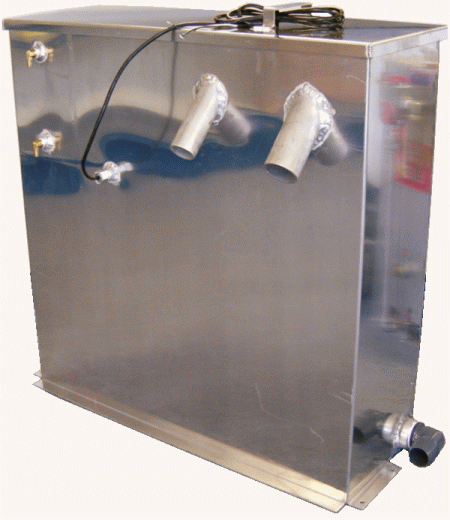

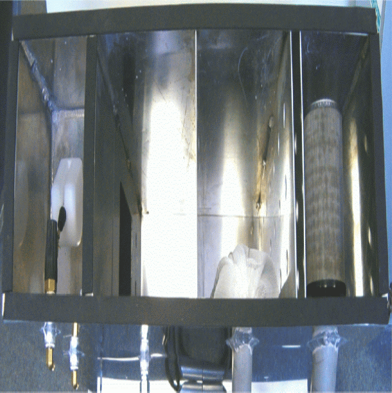

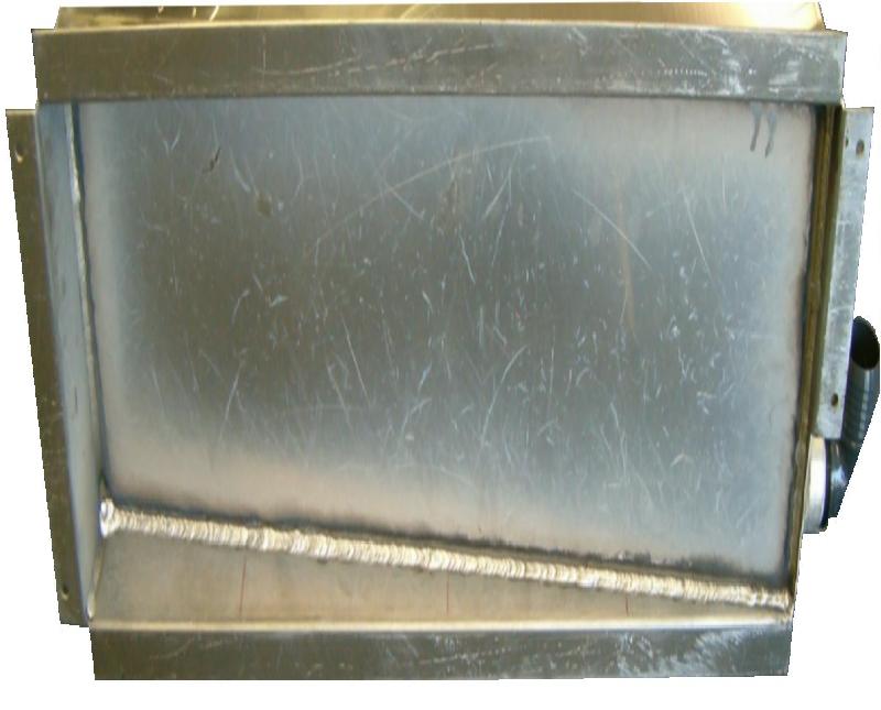

I did look at those but not too sure .. havent heard much about them. For some reason I have it in my mind that all those chambers will cause vacuum resistance. (flow interruptions) Im probably wrong. I do like the Cleaning Technologies tank. It has the drainage slope shelf and a 5 gal fresh water built right in the vac tank. But I was hoping for gently used. 36 x 36 x 12 would be ideal.
Recovery Tank 65 Gallon (Assembled & Plumbed)
"Heavy alluminum build with exclusive angled bottom."
Mounting Tabs Dimensions (floor space): 38" long X 15" wide
Tank Dimensions: 36" long X 12" wide X 36-1/2" high
$ 1387.00 Back
* 5 Gallon Water Supply Reservoir
* Supply Water Shut-off Float Valve ST8
* Recovery Filter "Flow Ezy"
* Electric Float Shut-off Switch
* Recovery Filter Bag
* Tank Gasket
* Single Wand Connection
