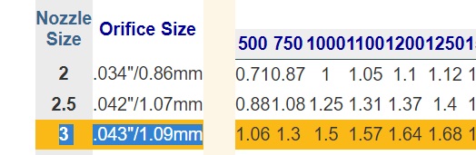

Don’t listen to those meatheads above. Just follow the chart to the specs on your water pump on how much gpm it can put out

Can you tell use what machine you’re using on that wand?
(corrected for friction loss by Dan G)

I guess in the sense that we refer to it......meaning not usually having any idea how much....or at any standard pressure
but that last # in the jet size it what it will flow in gpm @ 40 psi. Each of those 1103 jet would produce .3gpm at 40 psi (not particularly useful info for our application)
increasing with psi.............as per chart above
