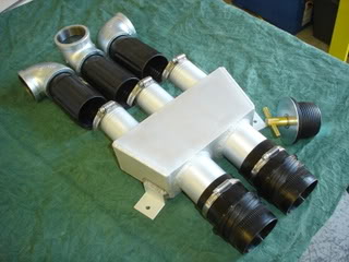

is the vanifold 2.5 and then brought down to 2 inch...

I talked to mike earlier and the difference is I stayed with all 2 inch......
and the Vanifold is three 2 inch going out to two 2.5 inch...

I have 3 2.5" port
