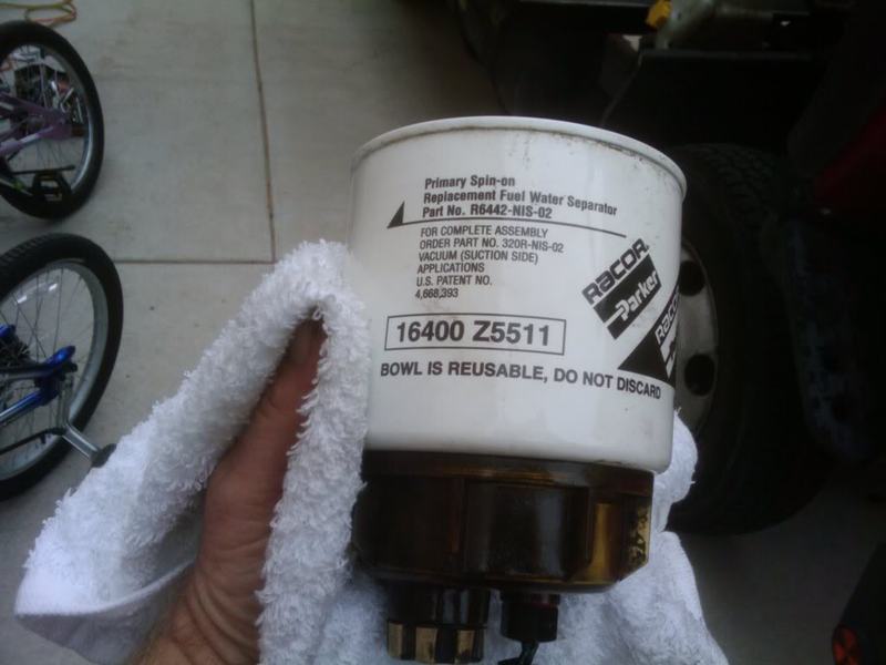

Thanks for the help everyone! Yesterday I spent all morning scrubbing rugs and all afternoon servicing the UD. Then last night went out and scrubbed rugs again. This is the first chance I've had to log-in and I'm overhelmed with the level of support. Thank you very much!
Decided to start with the easy stuff first.
I replaced the fuel filter. After spinning it loose I noticed a date of August 2005
Then, removed and cleaned the sedimenter
Also, replaced the thermostat
Then, dumped in a pint of deisel fuel additive (didn't see the Lucas so had to settle for Prestone).
Now, this truck runs better than ever!
It's smother, quiter, and the cab and fresh water tank heats up faster. Well worth the few dollars it cost for parts.
I haven't determined yet if it resolved the original problem will keep ya' posted.
However, I did discover something interesting yesterday while climbing all over.
It looks like the drive shaft is twisted and getting ready to snap.
Here's a couple pics i took w/ camera phone.
Think I'll pull the driveshaft out tomorrow night and have it rebuilt, or wadever they do to fix em.
Thanks again!!! Got 2 go

something else you may want to consider while you are doing all your truck maintenance.....(If you haven't already)..you might want to service the rear axle.....because of her age and miles and taking into consideration that the fuel filter was just over 4 years old... :shock: .....this has probably never been done....This has nothing to do with any of the above problems ..just a heads up so you won't have more issues down the road...........you would be amazed how many people over look this.....
1,846
BradFenstermaker
George that driveshaft looks like a u joint failed sometime and she drop on the safety hoop while driving.
Definetely get that looked at.
Question on the sedimentor,did you replace or clean? If cleaned how?

Its been a couple days since I performed the maintenance and the V hasn't hiccupped once. It's running great. Haven't done any upholstery or 150' CGD but will keep you posted.
The driveshaft is out and goes into the shop in the AM.
Brad, I cleaned the sedimentor in a coffee can half full of deisel, put the lid on, and slosh around. Rinse and repeat.
When replacing the fuel filter its a great idea to fill it with diesel fuel first. Then, loosen the bleeder screw, pump the primer knob until air stops coming out, tighten the bleeder screw and your done.
