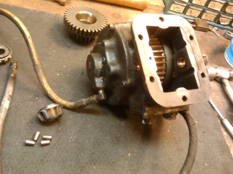

Here's a picture of the inside of the PTO. See the 4 bearings laying on the bench? They fell out of the race when we removed the gear shaft. They could have found their way into the transmission given enough time. Also, the main gear was wobbling and one shim was completely missing and the other was worn waffer thin. I'm certain the clutch pack is totally smoked too. No doubt this is the source of the problem.
the inside "Case" and Main Gear are scored. Not sure if it's rebuildable. Looking to purchase replacement. Anyone got a source? Also, I'm replacing with a chelsea vs. the OEM Muncie and I have some part # questions if anyone is savvy along those lines?

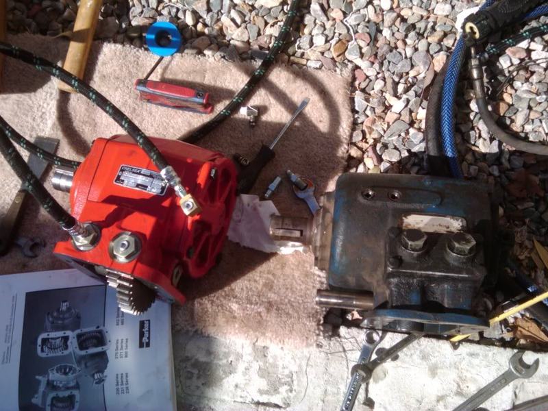

That POS Muncie blasted several grams of metal shavings into the transmission. Don't ask me how but the transmission is still alive.
The Chelsea we installed is far supieror to the Muncie! Look closely and you'll notice the muncie oils the clutch pack and the Chelsea oils the needle bearings and gear shaft. In otherwords, while driving around town the muncie bearings are starving for oil while the Chelsea bearings are enjoying a nice bath. It constantly oils the bearings from the inside out. Sweet design!
I didn't realize how loud the old PTO was until installing the new. If anyone has a loud whine it might be good to check before it takes out the transmission. A good place to start would be to pull the pan and inspect the screen too.
