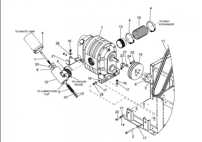

To properly protect a blower a relief should be plumbed into the air stream "Before " the blower filter.
that's how I understood it, it seems the some guys just put them on their waist tank.
18,851
Benton KY USA
Lee Stockwell
The problem with installing them in the waste tank, or anywhere BEFORE the blower filter, is that IF that filter ever gets completely loaded the blower will then have NO relief protection.
I've seen those filters really plugged.
Prochem puts them right at the blower.
14,086
The blower's filter will end up warping to get air if it's fully clogged. It'll be an interesting lesson learned
You meant "AFTER" right?
to protect the blower if the filter gets clogged the relief should be between the blower filter and the blower
so when speaking of it in terms of airflow direction "before" is correct in Lee's post

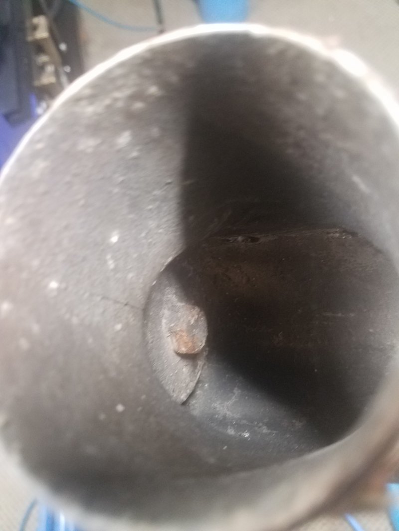

Example: On this prochem legend you can see the relief is directly on the inlet side of the blower....the blower is protected from clogs anywhere else in the system
Many, if not most, are not done this way but it is still the most correct way to do it as it provides the most protection to the blower
27,863
Lee is right in saying if the blower filter gets fully clogged, there is no vac relief protection for the blower. At the same time, looking at the common configuration above, if a piece ever comes apart on the vac relief it will destroy your blower. I prefer to have the vac relief on my waste tank and I clean my filter regularly. I was looking at several truck mounts that came up for auction a few years ago from a company that went out of business. On 1 machine, the pre filter lint basket was clean but the blower filter appeared never to have been cleaned and had collapsed in on it self.
Able 1
Apr 12, 2008
6,469
Wi
Keith
Actually it would be close to impossible on a prochem.. Just a bolt and a washer.. Unless you think the head of that big ass bolt is going to snap off at 15hg..
